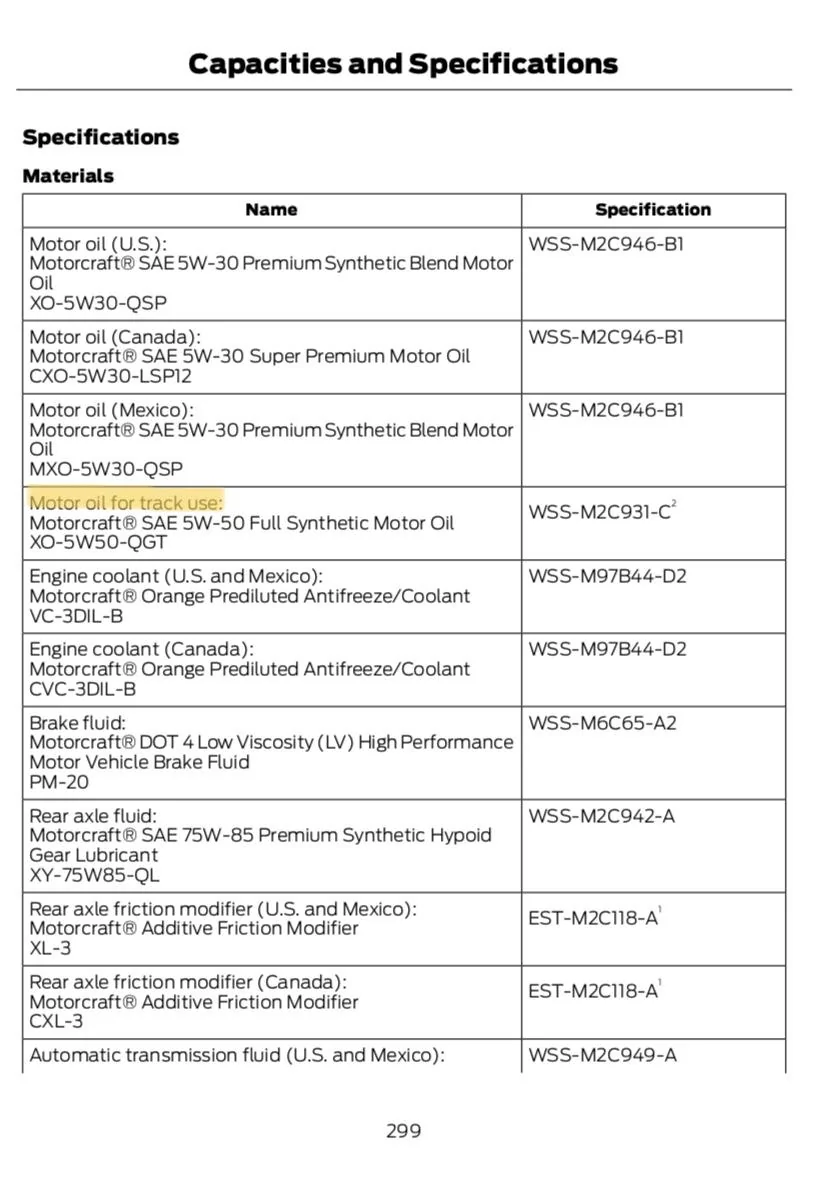

I also just checked the online 2019 Ford Mustang Owners Manual. There are (2) pages of oil viscosities listed. As can be seen by the snipped image below from page 299, 5w50 IS an oil listed, but is noted for ā€œTrack Useā€.
See image and where I highlighted.
So is this just another ā€œclick bait You Tube make-some-moneyā€ vid that was posted to get everyone thinking there is some directive from Ford????
Sure it’s in the owner’s manual, but it’s not listed as being the oil to use for DAILY use. Whether there’s any detrimental effects from running that viscosity daily, I have no clue. So I’d say use it at your own discretion and don’t take YT vids as gospel....
Unless an official doc comes directly from Ford....
