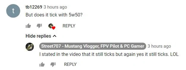

I didn't hear him mention how his engine sounded and ran on the Motorcraft 5W-50 compared to the former 5W-20 used in his engine before the oil was changed.
Update - went and looked at his YouTube comments. He said it still ticks with 5W-50.
