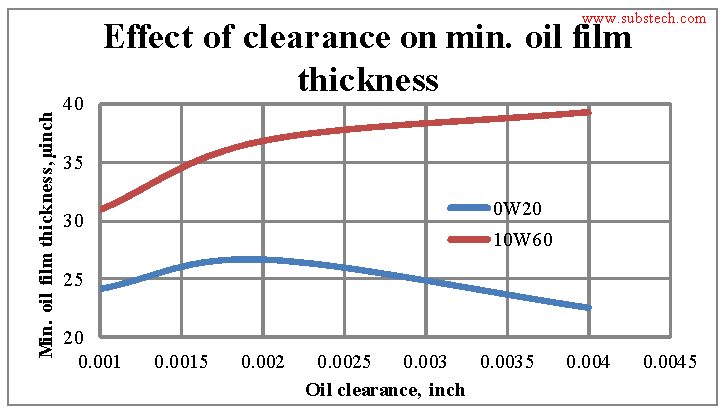

Fact is, the tighter the bearing clearance the less potential the hydrodynamic oil film will have to provide an adequate oil film thickness to keep the parts completely separated. See the attached graph which shows that no matter what the bearing clearance is, a thicker oil will result in more MOFT. The thinner oil (0W20) in the graph shows the MOFT falls off at clearances above about 0.003 inch. Any oil viscosity between those two curves will fall in between them on the graph
The MOFT is the only thing that keeps parts separated. Once the MOFT goes to zero then metal-to-metal contact and wear occurs, and then it's the anti-wear additives that have to take over to minimize the contact wear. Could be those race engines also use some pretty crazy anti-wear additives to help reduce enough wear to get them through the race. I'm betting those engines show some pretty good wear after a race or two, because othewide they wouldn't be rebuilding them.
