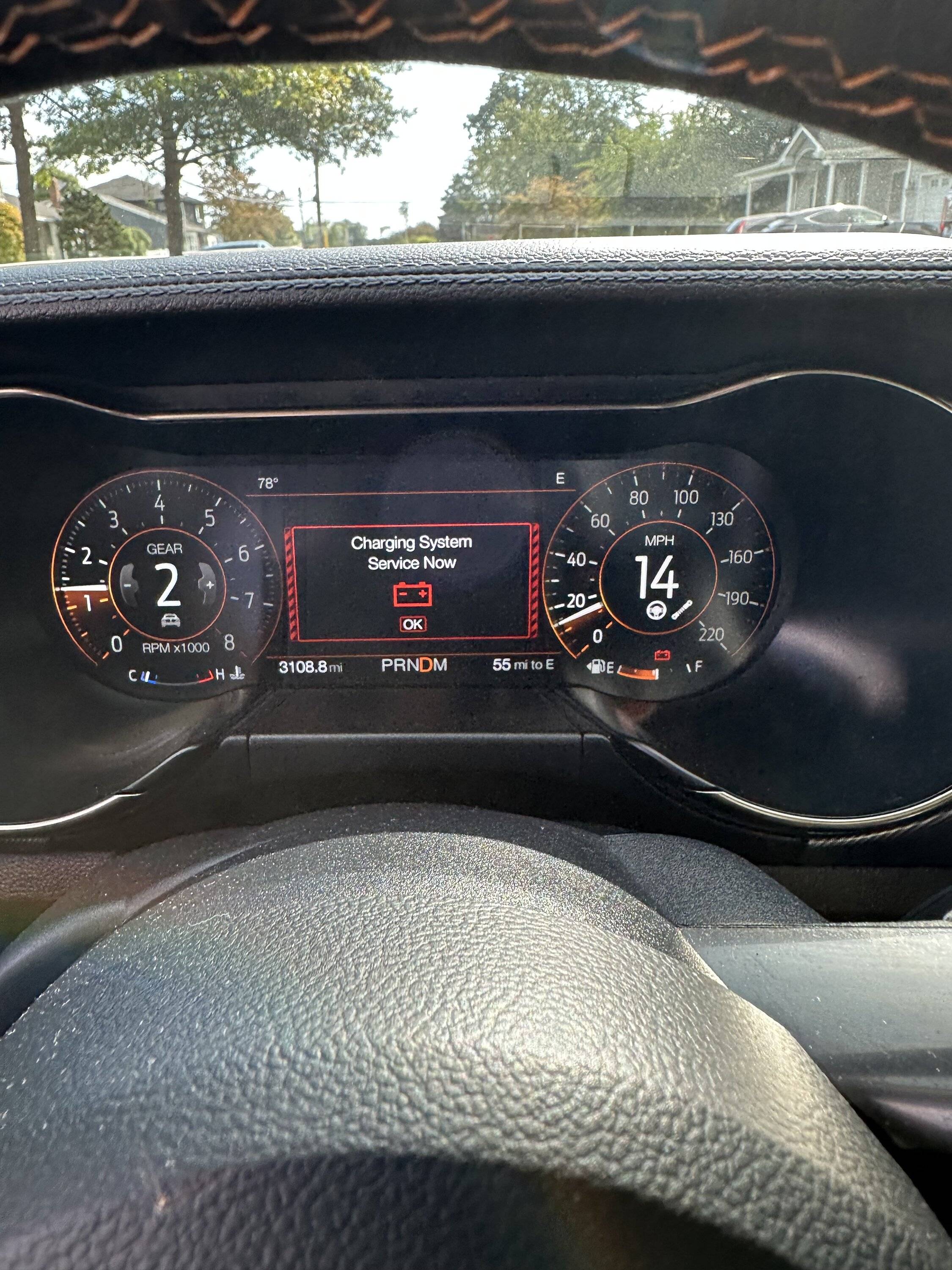

Charging System Service now (Overvoltage)

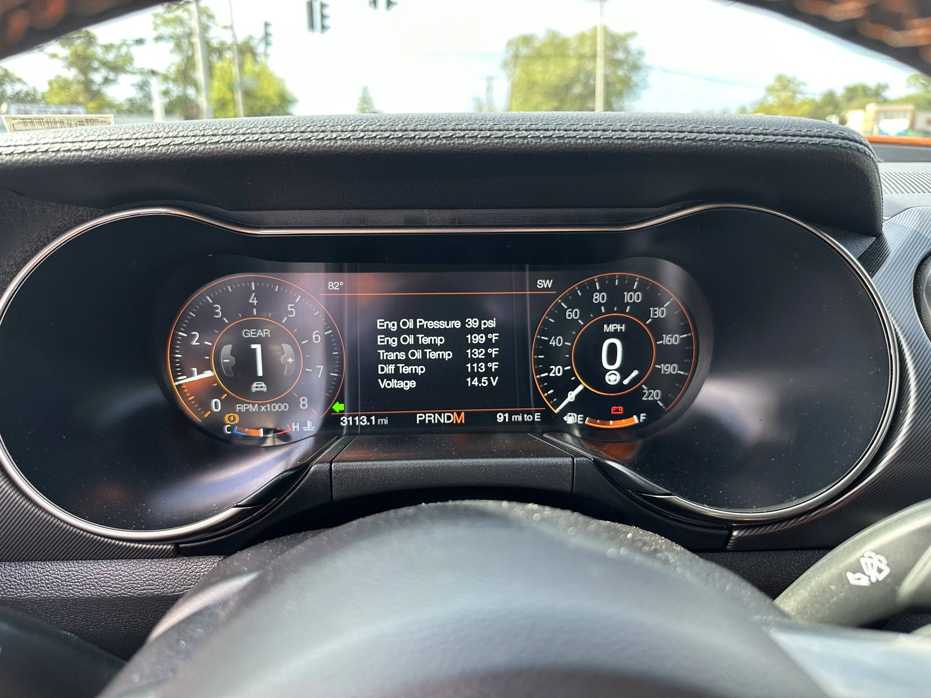

Car voltage is 12V when car is off and 14-14.5V when car is on. My alternator and battery test fine on my Innova 5610 reader.

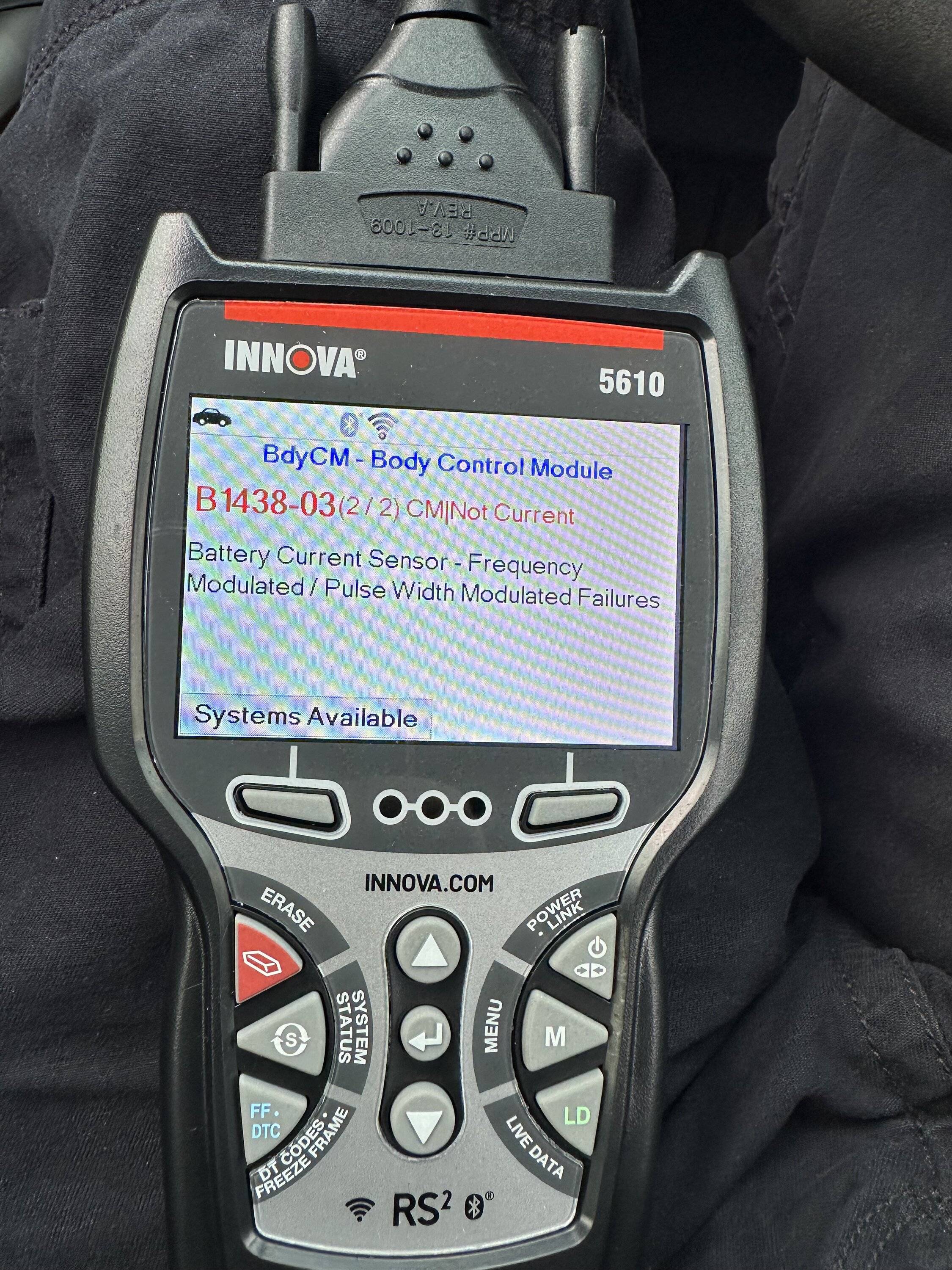

B1438-03 - Battery Current Sensor - Frequency modulated/pulse modulated failure

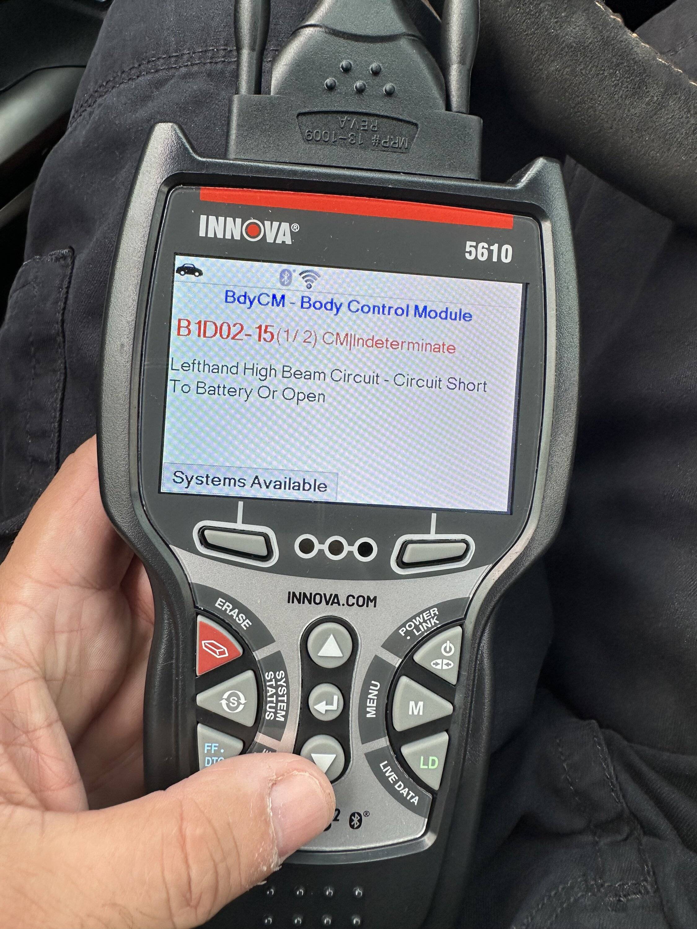

B1D02-15 - Lefthand highbeam circuit - Circuit short to battery or open - Does lefthand mean drivers or passengers side?

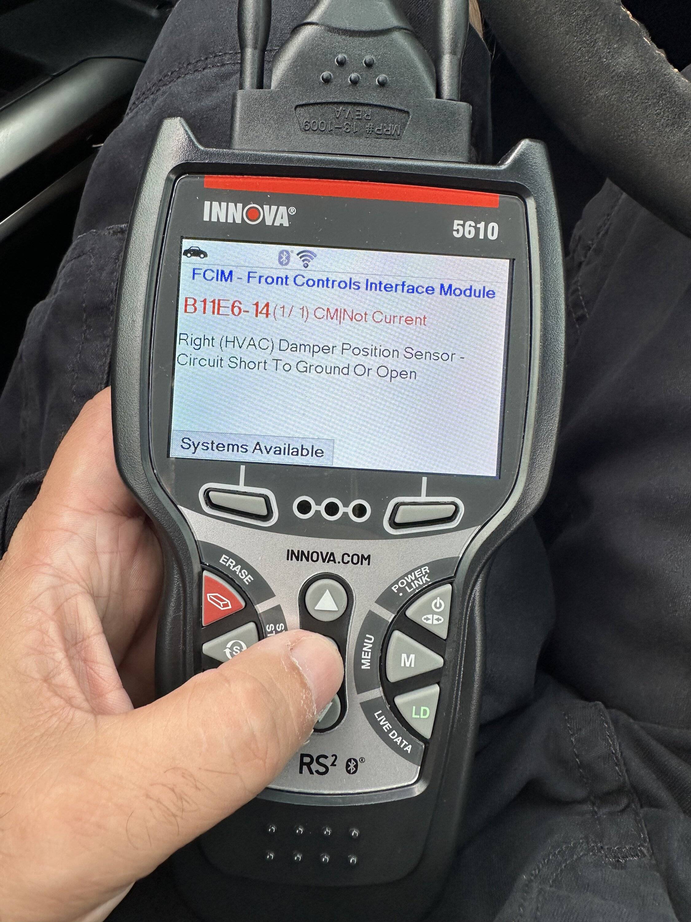

B11E6-14
- Right (HVAC) Damper position sensor circuit short to ground or open

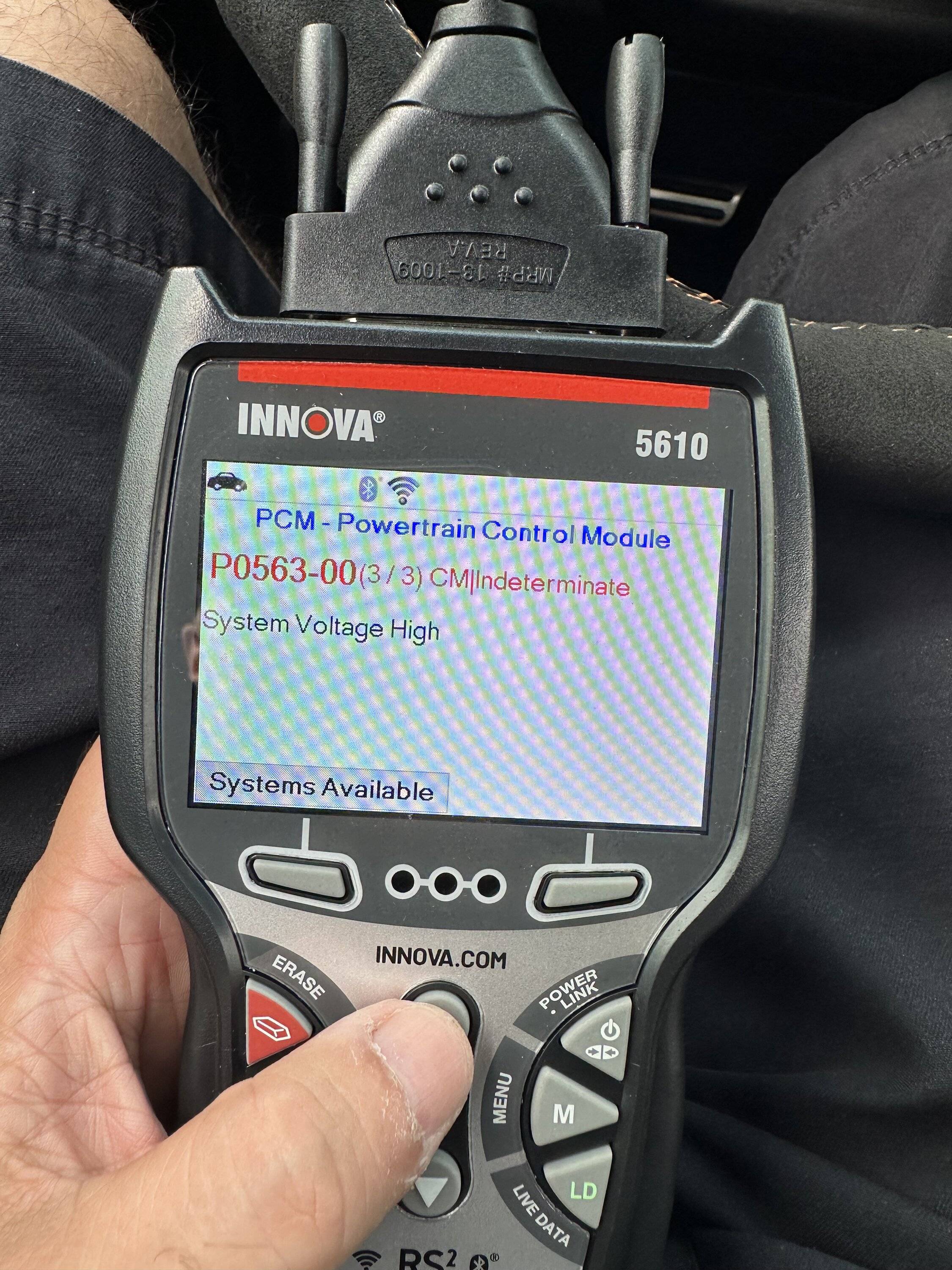

P0563-00 - System Voltage High
The AC woks find and so do my lights and high beams. The message comes right up as soon as the car has power.
I cant test grounds on the headlights without taking the nose of the car off which is a pain in the ass. I noticed the HVAC dampender is also affected. I dont see how the lights and HVAC are connected on same circuit so I am wondering how I can best trouble shoot this without taking the nose of the car.
