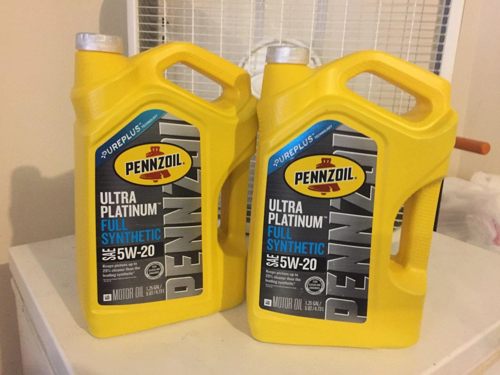

Amazon $24 bucks per 5 quarts plus $10 rebate per jug. Not bad for full synthetic. I just hit 3000 on original fill. Probably do first change @ 4500 miles.

Just did my first oil change @ 3100 miles. Oil was amber color coming out. But interestingly enough, the factory fomoco filter was 1.5 inches shorter than recommended FL500s. Smaller oem filter?? Penn Plat 5w20 is good stuff. :).
