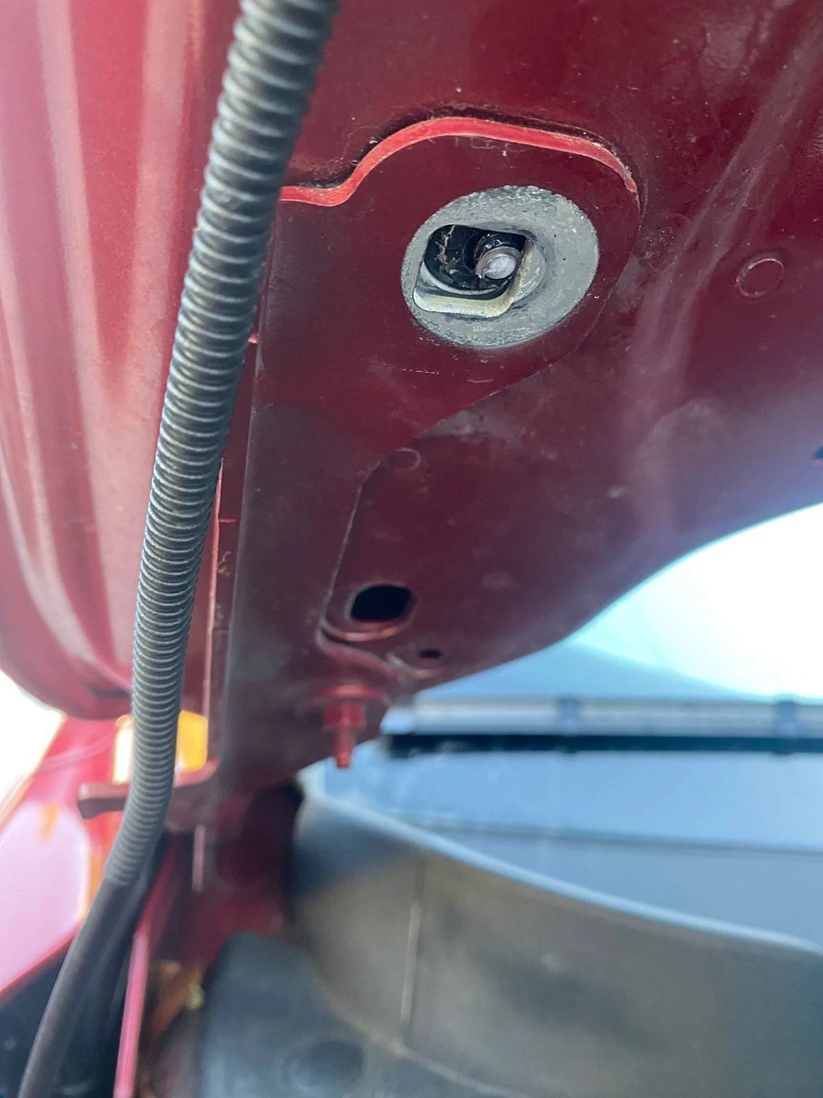

First disaster - snapped hood bolt

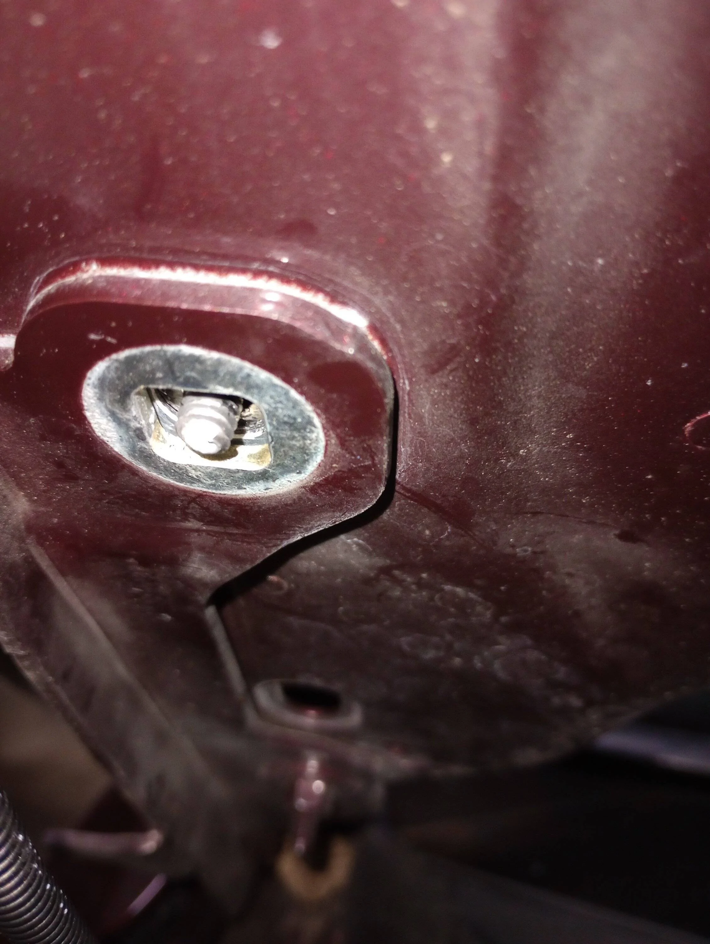

Ok, I saw these earlier in this thread but I can not visualize how these would work. Does it crimp on the the broken stud attached to the hood? Or into the new hood struts bracket? Thanks for the help!

Rivnut is just rivnut, not sure what install instructions you expect? :) You stick it into a hole, press-in with rivnut tool and that's it. Obviously, broken bolt needs to be drilled out and some prep might be needed. I can't guarantee that it would work but that is the first thing I would try.
Of course, I'm fully aware of Rivnuts and how they work. But, has anyone actually used them on the hood to fix the snapped welded stud? You can't install a Rivnut in something and make it work correctly if the area you want to mount it in can't accept it correctly. Is there actually enough "meat" in the hood once the snapped stud is removed (if you can actually remove the snapped welded in stud) to make a Rivnut work correctly? It's been suggested many times in this thread, but I have not seen one post from anyone saying they used a Rivnut successfully and showed photos of a Rivnut installed where the snapped stud was. That's my point of the question.

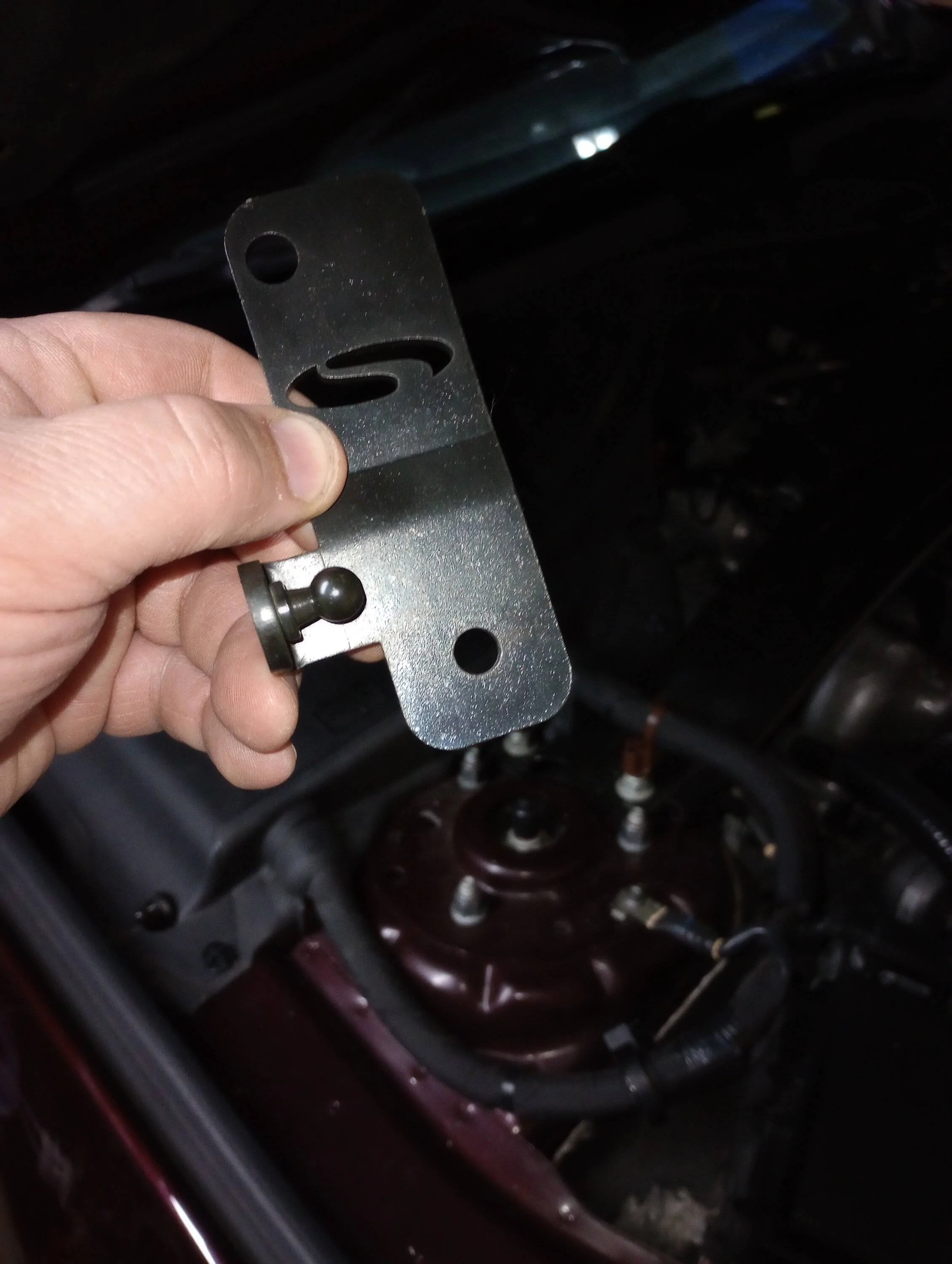

Edit. Found what I was looking for.
Use one of these.
Grind to length.
https://www.mcmaster.com/barrel-nuts/

Just happened to us too. Looking for solutions or a how to on the use of a rivnut.
Welp add me to the list, I hate ford for even using these in the first place.
Gonna go to my performance shop and they’ll see if they can fix it if not does anyone know somone who can fix it for me in the miami florida area?

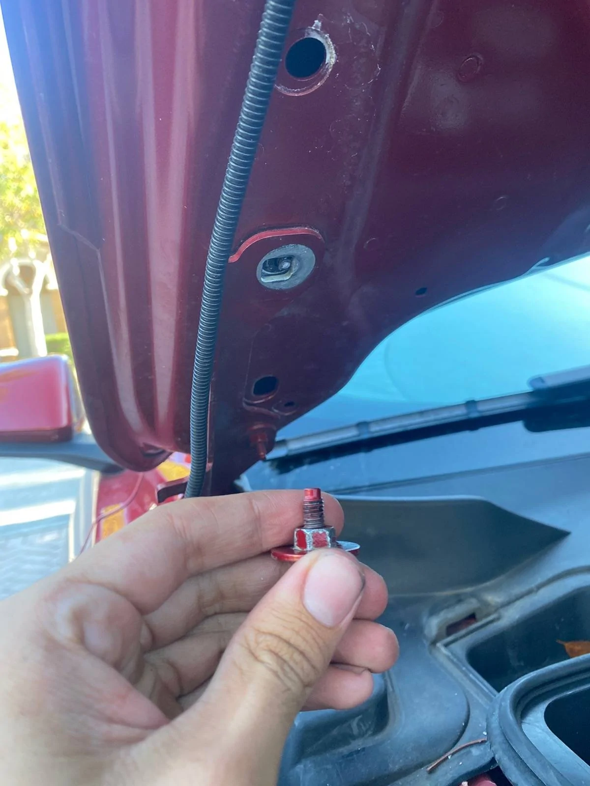

Did anyone else get these fixed recently, if so how did you do it? Was welding the broken bolt back on fine?
(Pictures and guide would be appreciated so I can tell my performance shop)
My local mechanic welded a new piece of threaded rod on there when I snapped mine last year. Didnt seem all that hard for him.
He welded a new piece of rod onto the broken part? That sounds like an easy fix.
Or did he take out the old broken bolt and put a completely new one in?
I don't know for sure. I think he just cleaned up what was left and welded on a new stud
