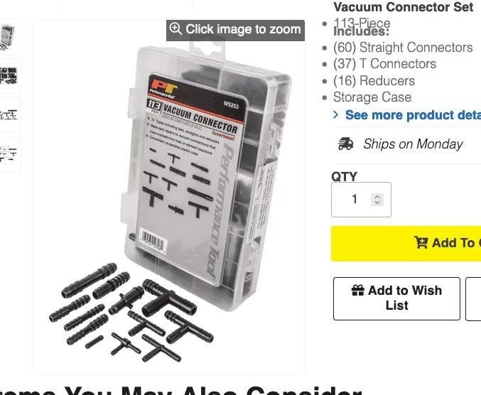

I think the lesson here in 12 pages is just use a hand wrench and snug it up w/Loctite. Forget the torque wrenches! Mine have been on a year (Redline) and they're fine. What I haven't seen mentioned is the length of the tube for the windshield washers. Mine is stretched out tight with the hood open and there is no slack. Anyone else have this issue?
You might look into these, and come up with a fix.
