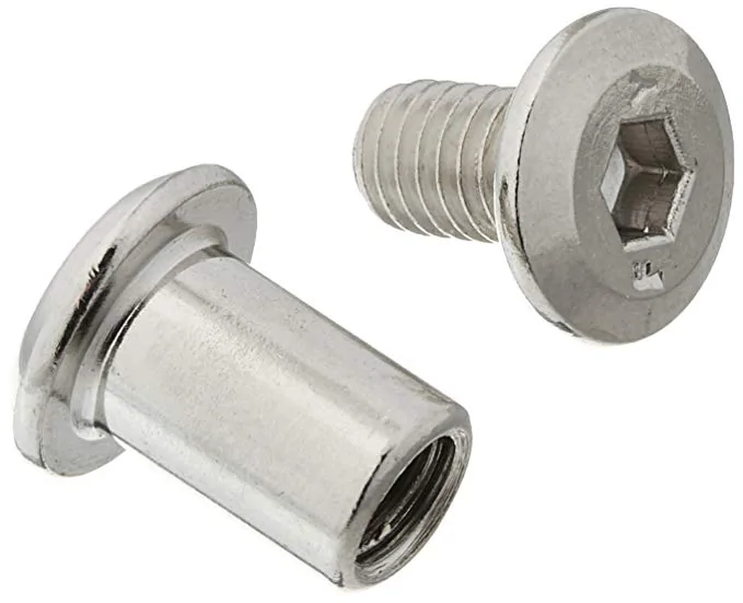

Going to bring it to the body shop tomorrow. Basically the fix in my mind is simply drill through the bolt stub with a new one and forget about hood struts and be done with it. I’ll let the shop do it. They’re always great. If they say nothing can be done cut my losses. Also the stability of the hood is fine. It doesn’t shake or rattle and seems just as tight and sturdy with 3 as it was with 4 bolts. It really isn’t a “big” deal it’s just an annoyance and a little ugly when the hoods open. Ironic that I wanted to change the hood prop due to it being ugly now I’m back to it with this gross thing now. Hopefully the shop takes care of it nice and easy and I’ll just forget about it. Lol.

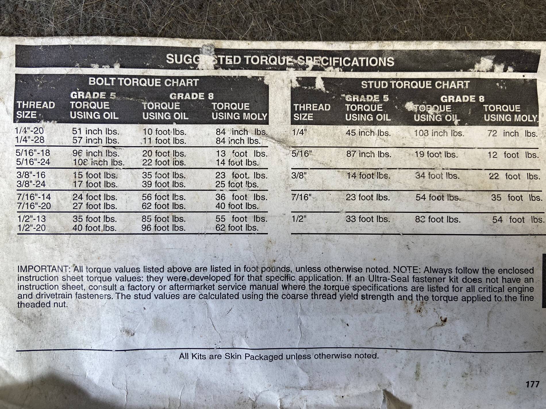

Ever better pick where & when a torque wrench is needed.
Hood struts seems to be not one. The material a fastener is made of is in play. Never mention but is a factor. The first picture of this thread clearly shows a bolt not up to the task.
Generally speaking not all, most automotive mechanical installs. Require one to break out the torque wrench.
Posting a reference chart some my find handy .
