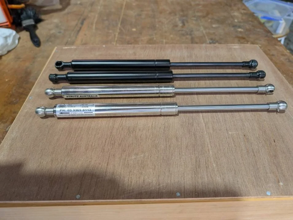

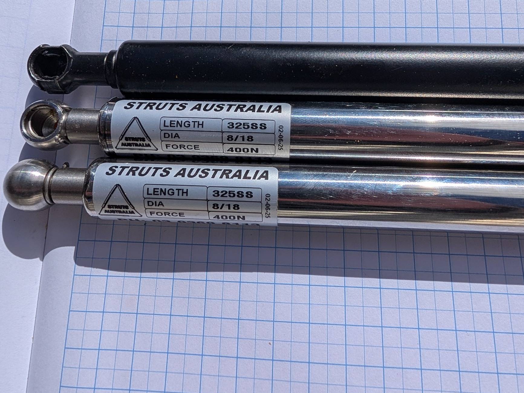

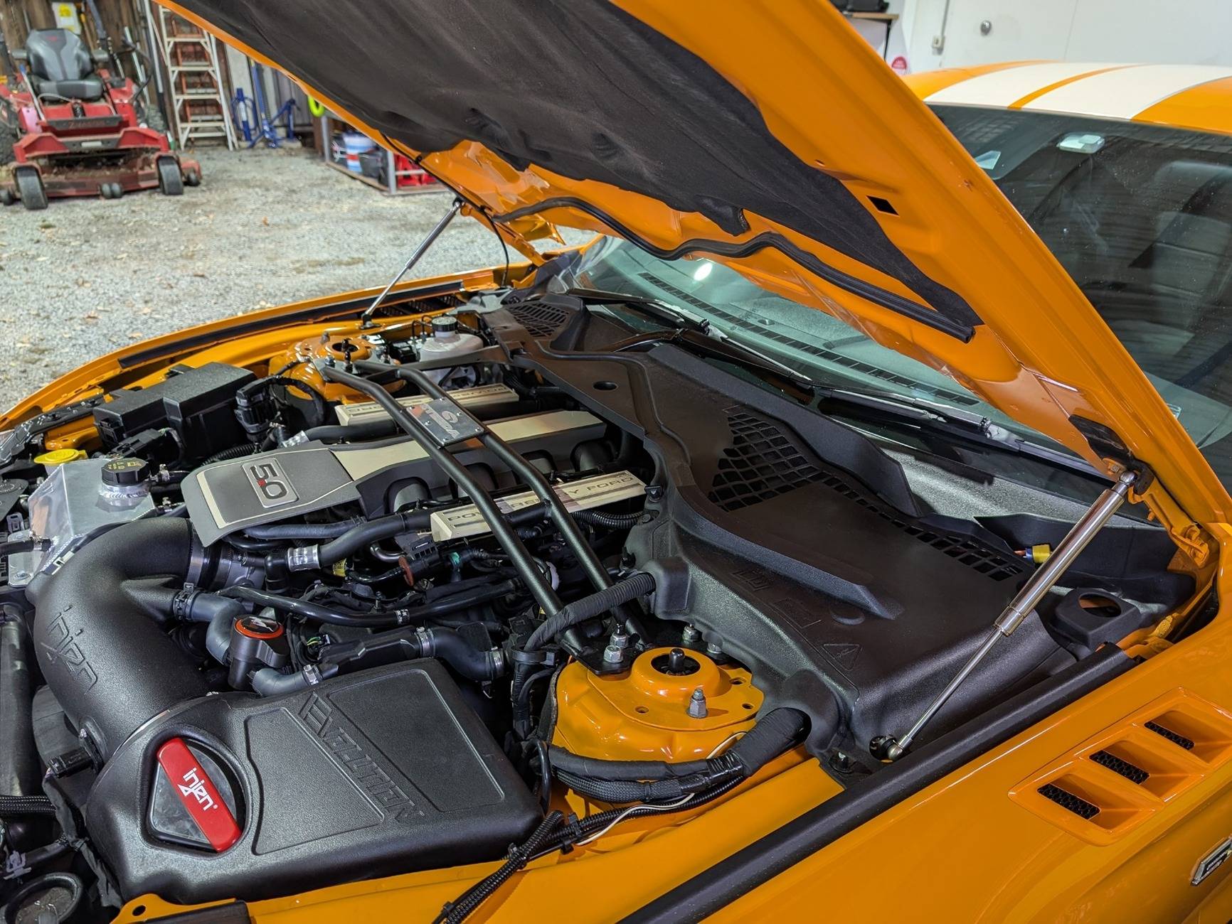

Steeda confirmed that their struts are unable to be regassed. They do sell the struts by themselves without the fittings but the cost quoted on shipping to Australia was horrendous. I have now replaced the Steeda struts with a set of stainless steel ones that I sourced from an Australian company. The Steeda were 335mm from centres of end cups. That size was not available in stainless so I went with 325mm and I can't tell any difference in function on the car. The other critical dimensions are 8/18mm diameters for the piston and body respectively. End cups are 10mm and I opted for 400 N force. With this force the lift of the oem hood is great and holds well. They look great too.
Pricing for the stainless was a lot more than plain steel in black but it was only slightly higher than getting the Steeda ones sent. They can be regassed as well for a very reasonable price.

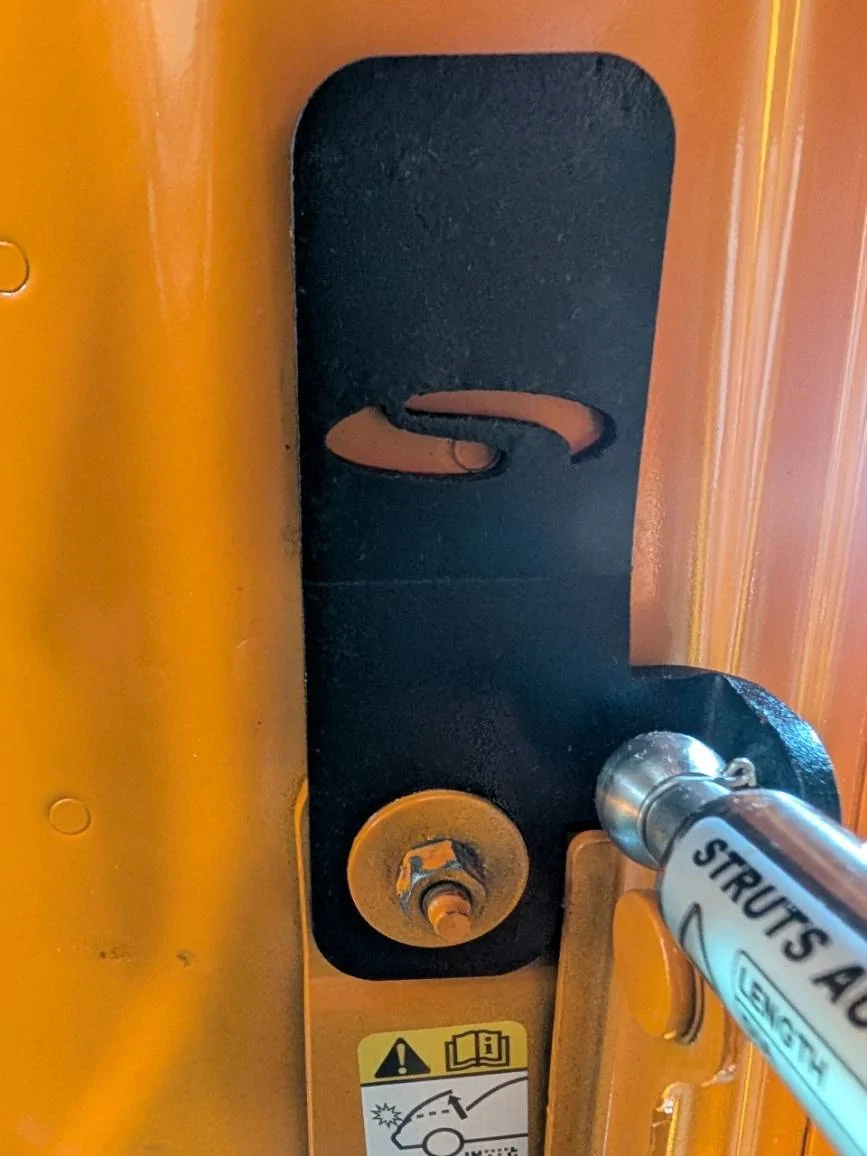

One disappointing thing I found while doing this install was that the "S" for Steeda cutout on the bracket that mounts on the hood hinge has started to rust. I have included a photo so you know what I am referring to but I took it after cleaning up the rust with WD40. I put a bit of spray down the back but they would have to be taken off to do it properly. Beats me why parts at this price point are not made and finished to a better standard.

The logo is a nice feature, but a known compromise (I suspect that’s why they removed it from the rear IRS braces).
The sharp edges and small cutouts present a problem for the coating, and even putting a lot of time into dressing that area pre coating, they will always be a risk (especially compared to a flat, logo free area).

When they laser cut the logo, paint won't stick to the edge unless they have been sand blasted or acid dipped to remove the slag. Your new struts look great! I put the ford performance on both of my mustangs one set is a year old and the other was just done in April of this year. Time will tell.
