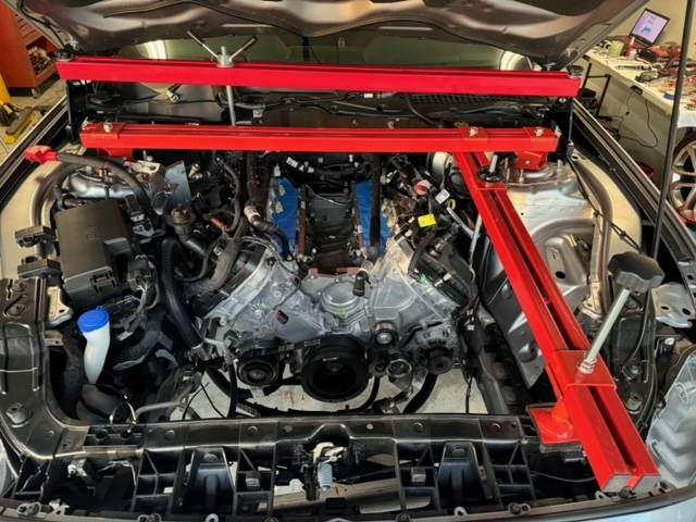

Yep, removing the battery box is a good way to go. I set up an engine support system, drop the K-Member, remove the starter and engine mounts, and the headers come out and go in very easily. One would be surprised how quickly this can be done. Makes life a lot easier.
MB
Where did you get that nice engine brace?
