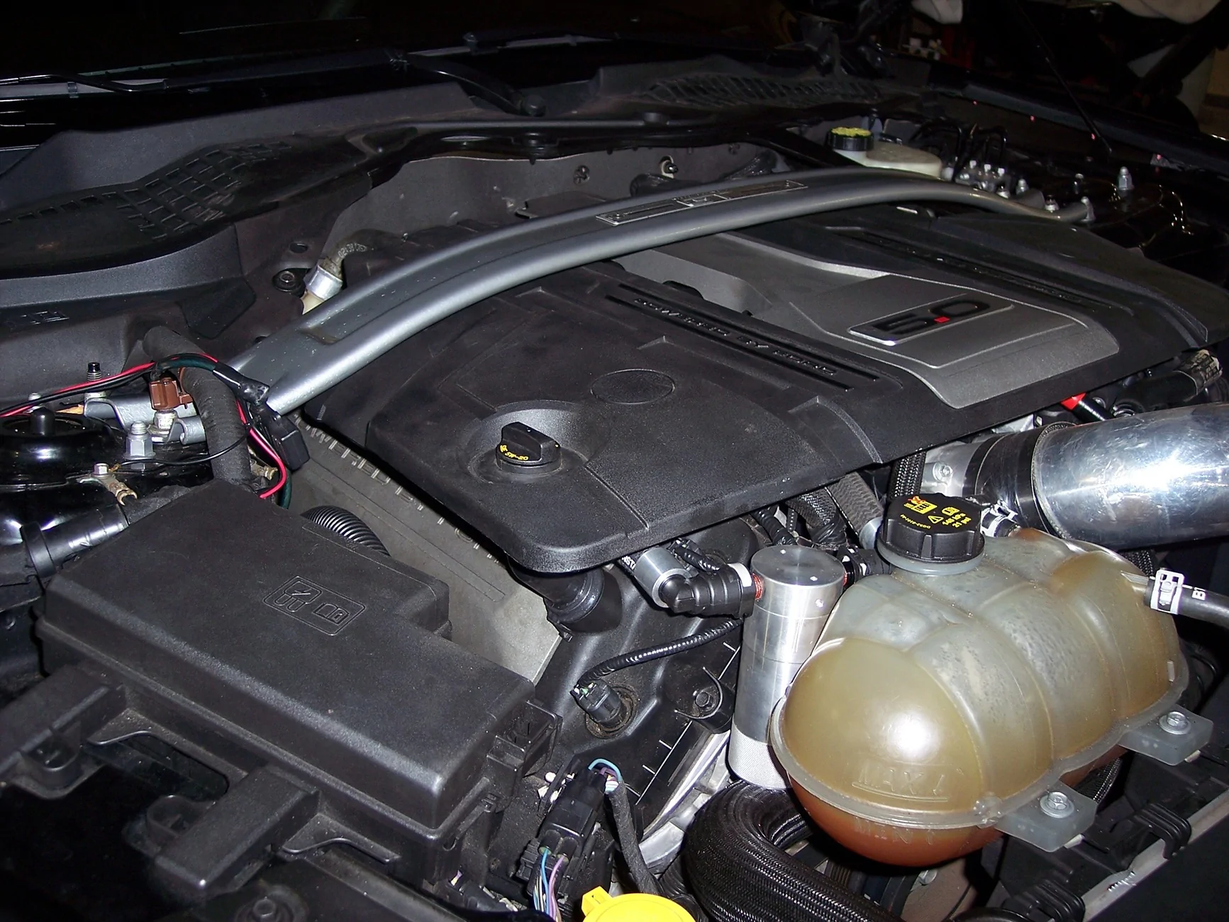

Full custom install using an Improved Racing can. Not very well known company in the Coyote community, but their stuff is top shelf. Best design can I’ve event came across. Yes, my install is way over engineered and expensive, but it was a blast of a project. They have a coyote bolt in kit now. Didnt have it when I did mine, but doesn’t fit the 350 anyways. I was able to help them develop that mounting bracket and hopefully solve some future 350 options.
https://www.mustang6g.com/forums/threads/improvedracing-custom-catch-can-install.205010/
