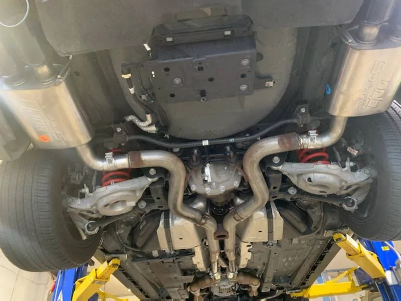

If you add a resonator Like the Borla 3" Resonator 60661 ( This Resonator contains an internal H-Pipe ) it will help a lot. One of my guys here added this in place of the H-pipe on his AWE Touring exhaust after he installed long tube headers for the same reason. This resonator was a direct swap with the AWE H-pipe, required no modification to his system. I can't say that is the case for every cat back but in his case it was. The other option would be to add some Vibrant resonators and have an exhaust shop weld them in to your H-pipe they offer 3in inlet and out with a 4in body. They offer them 12in long & 18in long.
https://www.beefcakeracing.com/borla-60661/
I went with this route on Stainless Power catless through a Borla ATAK cat back and it sounds great, if a little quieter than I expected. Super easy, sounds great, and drone free.
Terry I bought my Awe touring cat back setup along with my whipple through you guys and you were the best! Looking to quite mine down a bit with the Kooks long tubes and the blower the awe is a little too loud. I saw your post about the Borla 3" resonator but it says 2018 and up, i have a 2015 do you know if its still a direct swap for my H pipe?
