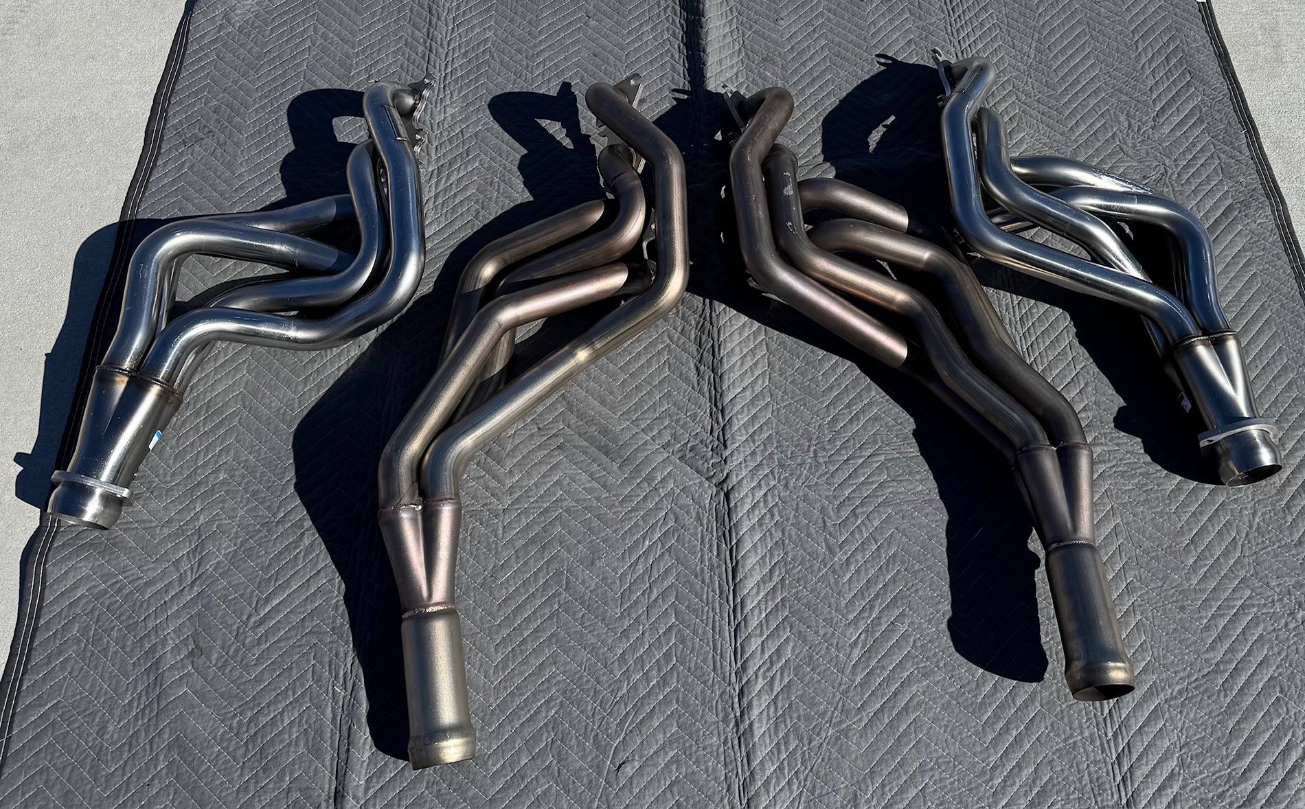

Right at six hours of work, 2Ms came out, Kooks went in. Here's a comparison between the two.

Glad you asked....although the materials and workmanship of the 2Ms is on par with others, design execution is severely lacking. The distance between the collector and where the mid pipe connects is longer than others, so 2M placed the upstream O2 sensor further downstream and the bung is welded on the horizontal centerline, not at an angle like basically every other quality header maker.
The problem this presents for an auto is the O2 sensor interferes with the travel arc of the shift linkage. Plenty of clearance while in PARK, but anything beyond NEUTRAL and the heat shield on the linkage union hits the O2. If I relocate the bung at an angle above or below it's current position, it presents other interference issues. If I move the bung upstream, the only clear spot places the bung forward of the collector cone.
After I installed them, I attempted to deal with this by placing a 90 deg adapter in the bung, but, of course, it served as a spacer and the wideband sensors have to be in the flow of the exhaust gases, so this presented a fueling issue, rough idle, and stalling. I removed the adapters to test the theory and it was rock solid, but, the car had to stay in PARK. Comparing data logs with and without the adapter told the whole story.
Since speaking to the folks at 2M was a total waste of time and energy, I ordered Kooks on 14Dec and they were delivered on 27Dec. I'm dropping the K-Member on Saturday, removing the 2Ms and getting the Kooks in place.
When I brought this up to other 2M owners with auto trans, they had no idea they've been driving around with their shift linkage jammed against their O2 sensor. The best I can tell, the manual trans presents no issues at all. I get it that folks are attracted to the price of the 2M stuff, which isn't why I bought them, but it's confirmed once again that one gets what one pays for.
