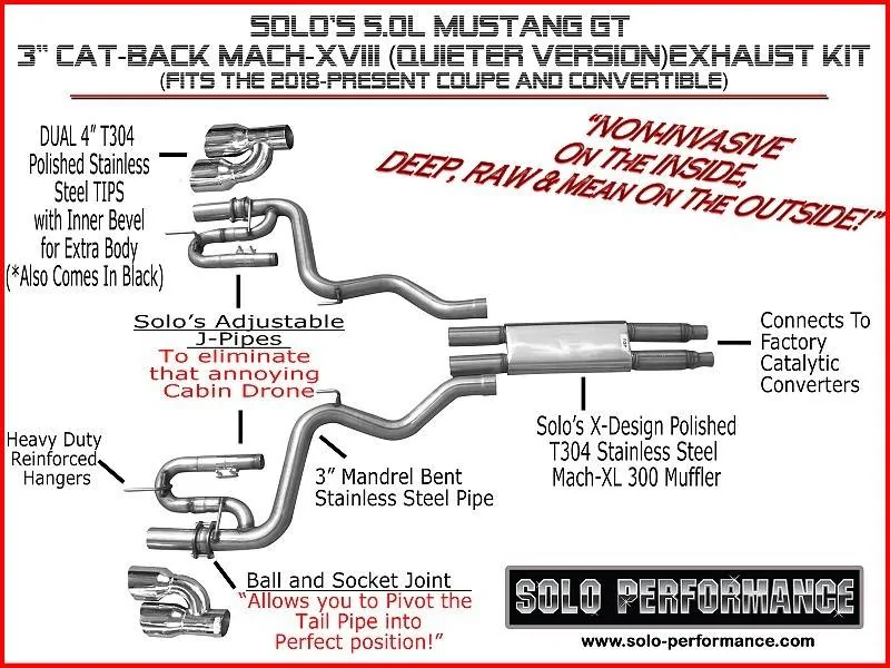

@GregO, do you have any experience with or opinion on the solo performance Mach-xl 300 mid muffler? It’s a part of this cat back:
No first hand experience.
SOLO does have a great following.
If you’ve gone to long tube headers and dB reduction is your goal dual side x side Stainless Bros. 4” round resonators is a good option.
There’s a reason Ford has chosen to install dual side x side round resonators on both the GT350 & 500……….

I have Solo on my Jeep. I do not have a resonator. It sounds great at less than WOT but at WOT no matter the RPM its very, very loud. I have sound deadening foam in the spare tire bay and its still LOUD. No drone but super loud. Not sure if thats equal for this unit.
Did I mention, its very loud :)
