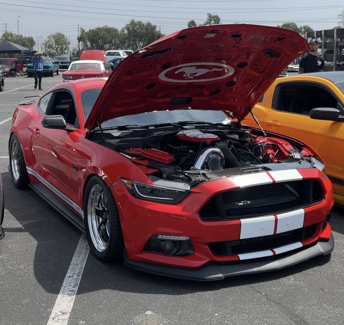

Hey this is Junior from N4SM, this is my Vortech car at about 850whp. I had the Sai Li system on it and it wasn't enough. Lund had to dial back my tune because of the fuel system. Ended up going with a Fore Innovations dual pump and haven't had any issues since. Sai Li is a good system but Fore innovations is the way to go.

That thing is beautiful what’s your suspension set up ?
