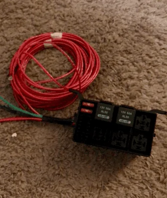

VERY easy system to install. The only thing I don't like is the harness is too long for the S550. It seems that the wiring was designed for the S197 in the trunk fitment. Either way it went in without issues and works as advertised.
