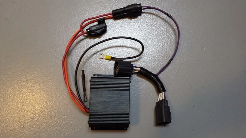

Nice I have a JMS pedal input I may be able to wire in or just pick up a VMP locally
I replied to your PM
Any pics would be amazing since I am electrically challenged

I will be $950 + $250 for the BAP so I am at $1,200 and we should be good for 950rwhp like that according to our estimations

I have a new in the box VMP plug n play BAP for sale. I bought it and decided to go return. PM me.
