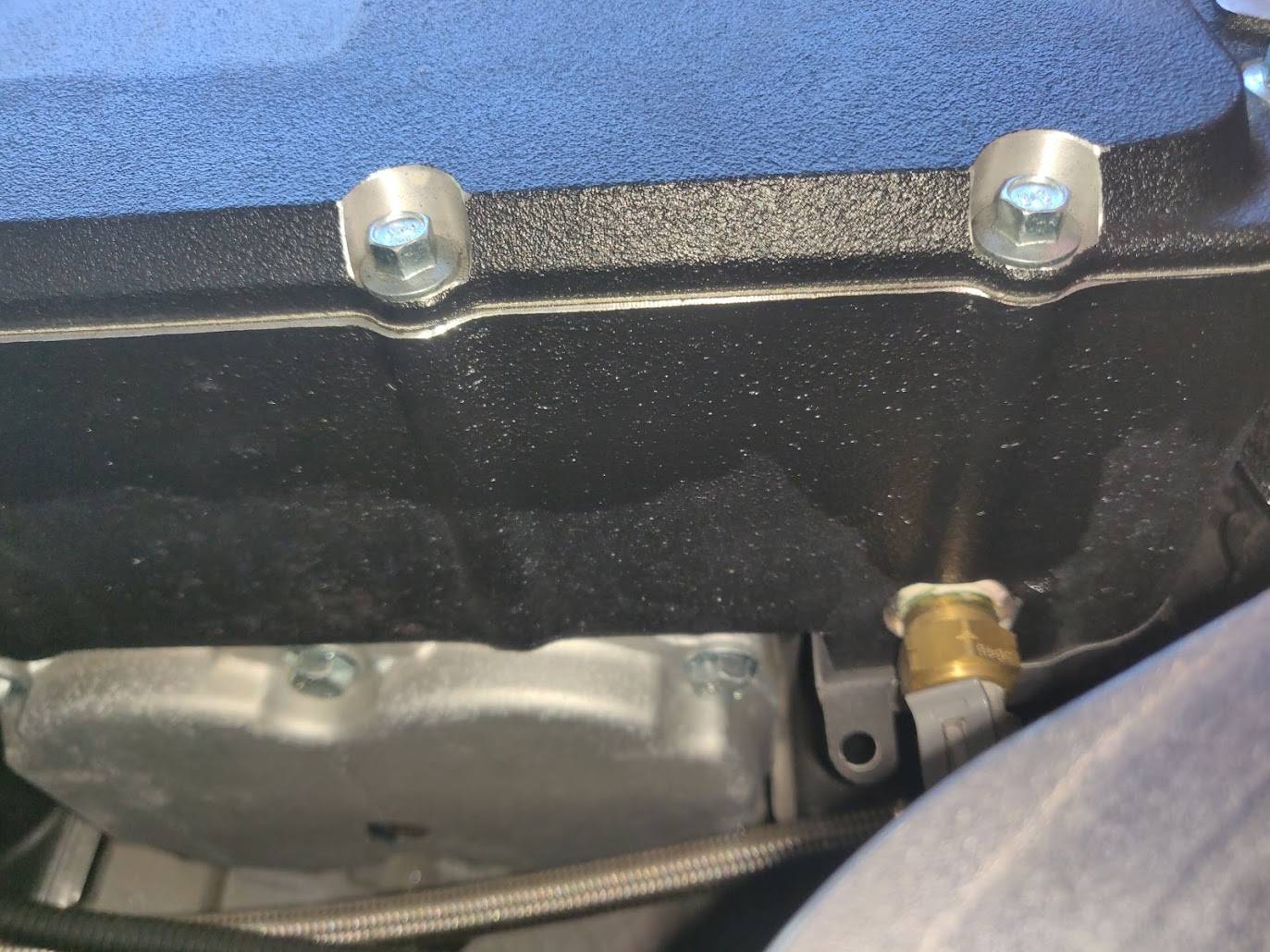

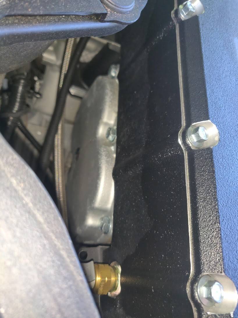

I noticed what looks like a little bit of blow by oil seeping from the top cover. Kit's been on the car for about year now. Anybody else have this, is this normal? Dry to the touch though.

If oil is seeping from the lid, that means you're going to have oil all over the intercooler too. I would pop that lid off asap and take a look.

Id ont think it's leaking, the color of the lid and the "wet" part as the same, and it's dry to touch, I think you prob drove through some rain at one point and it left clean spot on the blower. Oil doesn't evaporate, so if it leaked there it would still be oily until it's been cleaned, even water wouldn't wash it off

Havent noticed any performance degradation. I guess i'll just have to keep an eye on it. There's going to be some oil inside because i'm not running a catch can. The Stock IM was coated inside as well when I took it off at 10k miles to put the blower on.

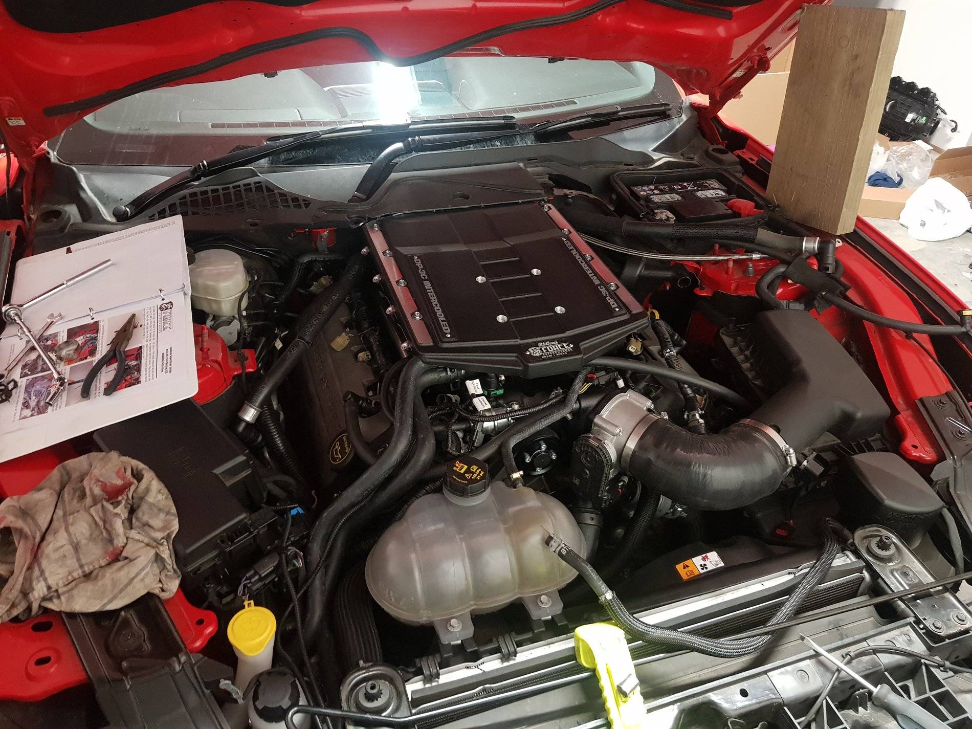

Well it's in! Not complete yet. Will wait for the brass sensor. I took the plastic one off on the bench top to make it easier. There was so much red loctite on it.
I've got the base tune from Lund. I'm ready to go hopefully by Monday if everything looks good.
It is a real tight fit on a RHD! I had to cut off some of the plastic cowl. I also had to trim off part of the K member.
I found that the intercooler was a tight fit between the factory radiator and the bonnet locking mechanism. I've ended up squashing some of the fins during install. So fingers crossed.
The magnet extension pen I bought pretty much saved me. In particular with the manifold bolts. Just get one.
I found that I hadn't cut off enough of the square plastic retainers for the harness. I had to trim a bit more off otherwise you would have no chance with the injector rail...
I had some trouble with the intercooler hoses that go into the upper and lower bungs on the supercharger. It's tight....
Hopefully the rest goes well next week..

I probably should’ve mentioned that the easiest way to make the HE fit on our RHD cars is to simply remove the latch protection device. The pics in the instructions don’t show one fitted so I can only assume that it’s part of legal requirement in some of the RHD markets. Not sure.
I found the same thing with the harness clips on the cam covers. You’re not alone.

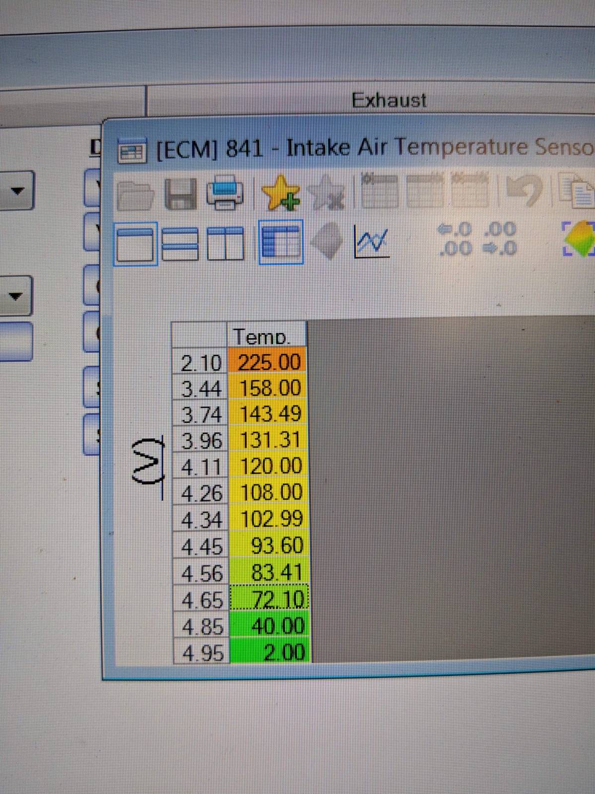

for anyone who's tuner gives them shit about the plastic sensor, tell them they have no more excuses, they either lack the will or skill, but they do not lack the data
