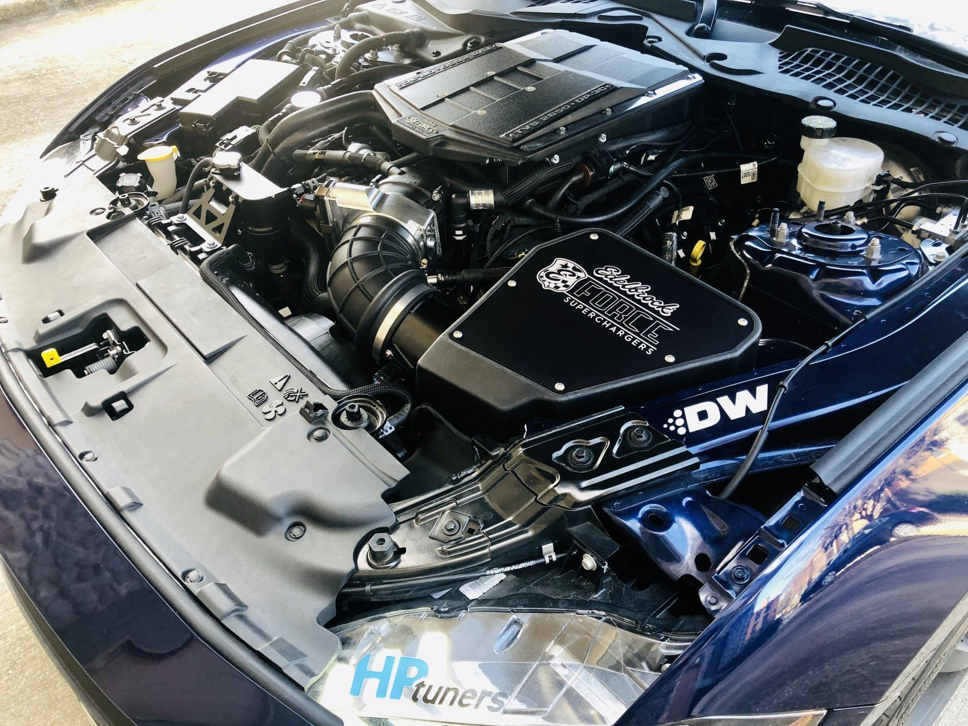

I bought the stage 1 Edelbrock kit, made 638whp in 7th(616whp in 6th; stock headers and cats still on the car), haven't had any complaints or issues to date. Edelbrock did send me a beta version of their TB and intake to test out before release and I've had pretty good success with it. Both me and my gf daily the car and she has no issues driving the car to and from work.
Power wise, the car pulls pretty strong, boost comes on really easy once you remove the nitrous pill from the bypass hose, I 'll be around half throttle making 6-7psi and easily pass almost anyone else on the road.
I haven't gone to the track yet since I'm still on stock half shafts, I do plan on it eventually once I buy some renegades half shafts. I also haven't dyno'd the car since adding the stage 2 TB and intake.

Very nice set up you have there , love the CAI , absolutely beautiful.
But I have one question , what do you mean by nitrous pill?

the hose going to the bypass hose has a small nitrous pill in it to help transition the boost in. Makes it a little linear, feels like a small turbo spooling, helps keep traction from low rolls and speeds .

I understand, I guess I am still getting used to the Eforce kit , also do you have a part number for the intake ?
