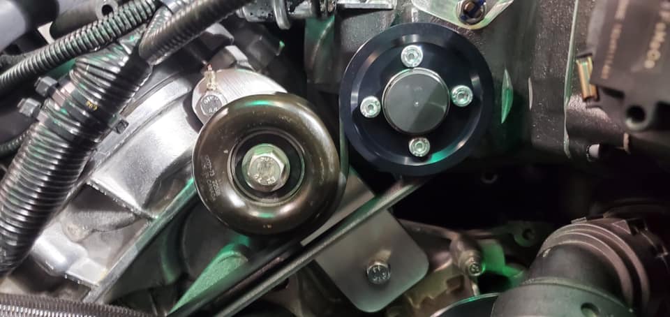

So I ended up ordering the aux idler for my Edelbrock. The guy who has one now has been able to get 17psi out of the 2.75" pulley with Lund tuning it. They told him it doesn't look like he has any belt slip, this was on the normal Edelbrock 2.75 too, not the griptec version.
It made 16psi on the 2.80 Griptec
Here is a pic of it with the 2.80 pulley(not my car)

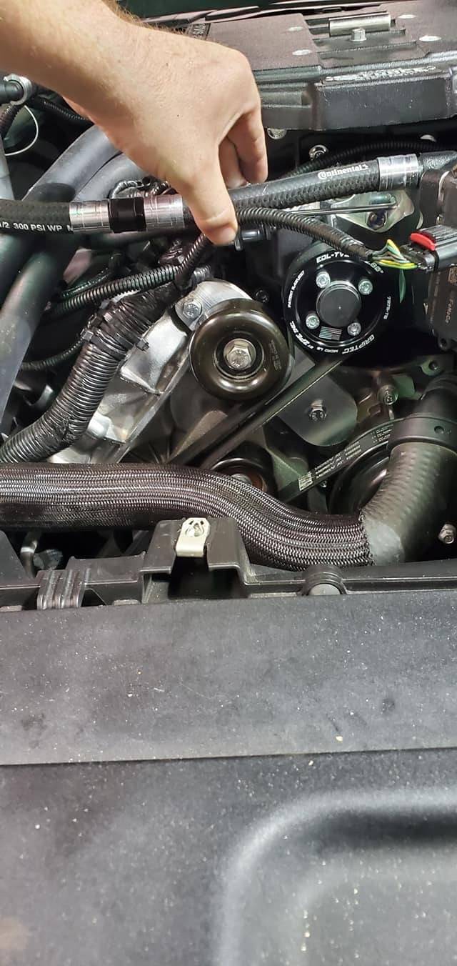

Is aux pulley kit for sale finally? Last I read, it was still in development. I'd love to keep my 6 rib but also push to 15+psi or so for a couple dyno or track days lol
Already paid for mine, hasn't shipped yet though....also here a pic of it with the normal $35 2.75 Edelbrock pulley
