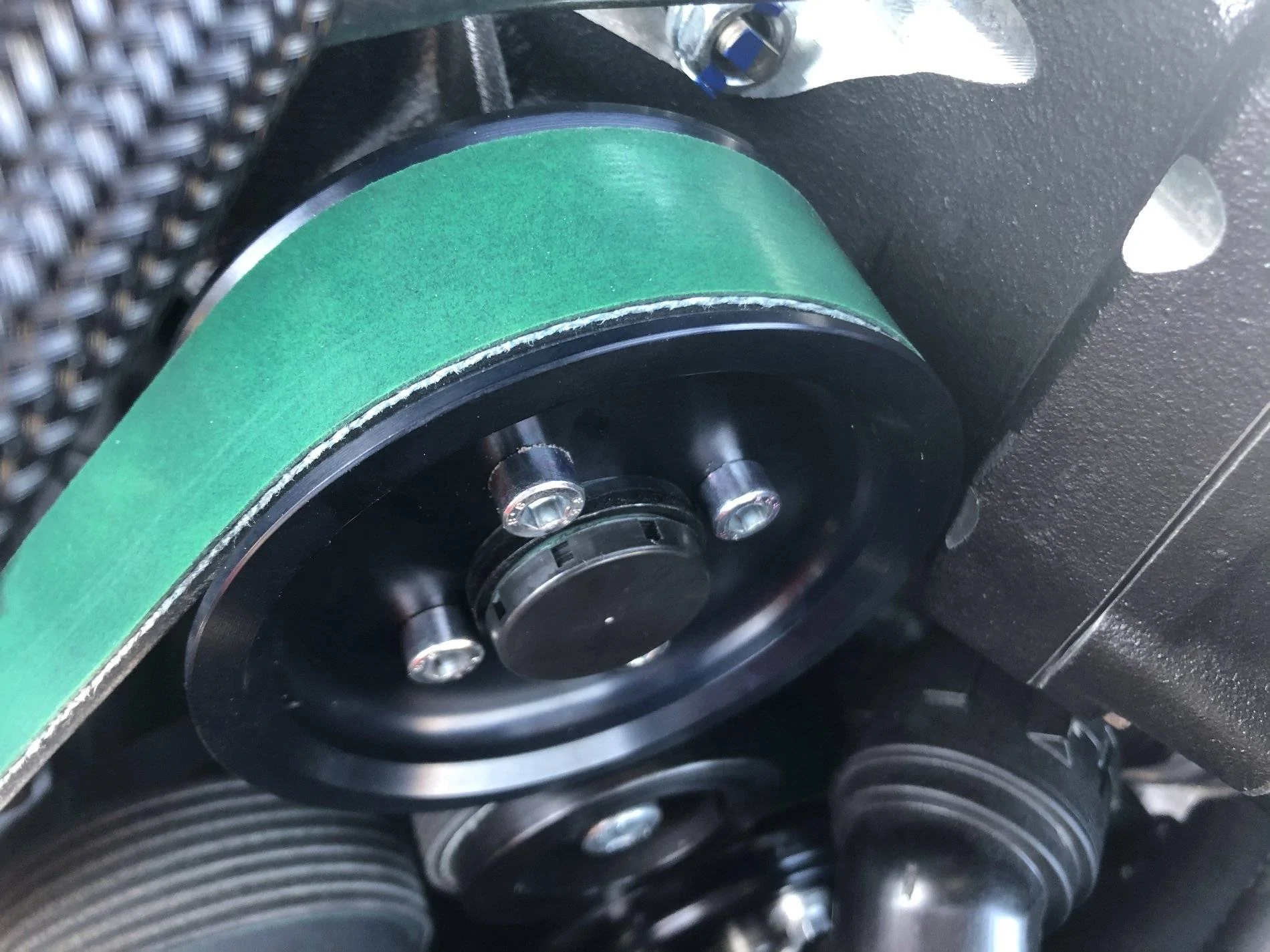

That's a lot either way for the 6 rib and the engine if your stock. Every 1/4" drop on the 6 rib is 1-2 lbs of boost. I see 11 on the gauge with the 3.25 upper. Drop to a 3 and u maybe you'll see 13 lbs max. I wouldn't recommend running 14 lbs that would like a 2.8~2.75 belt slip would be likely. Run a griptech pulley if you can.

I’ve ran a 3” and attempted a 2.7” on the 6 rib. We have really high density altitude and the 3” made 11 psi.i I had to run the 3.25” recommended belt for the 3” pulley.
you can fit a 3.75” pulley. It’s the largest that’ll fit on the eb

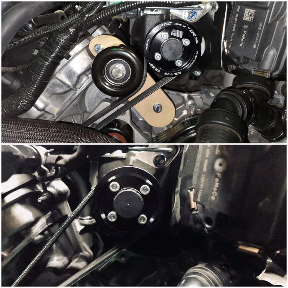

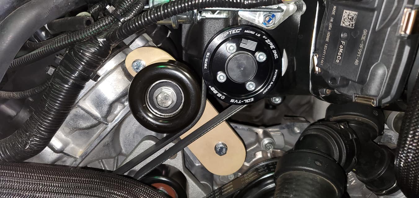

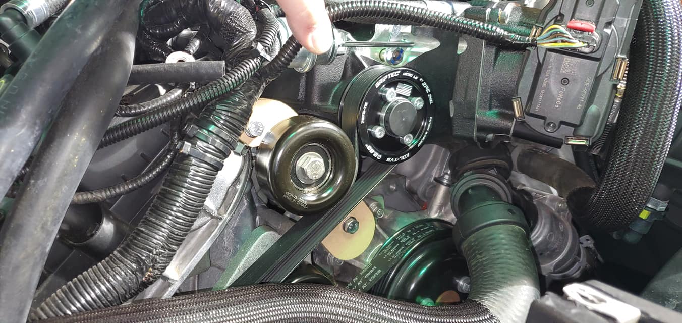

Seth in the Edelbrock Facebook group is working on a aux idler kit for the 6 rib, adds more wrap and should let us run 69mm(2.75" pulleys w/o slip). Thats just a mock up piece he made to get the spacing right, said he will test it out once he make a aluminum version
This pic here shows the difference in belt wrap with the aux idler and w/o it
