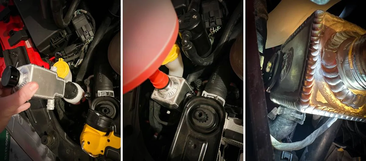

That aluminum tank was worth every penny to me. I had it powdercoated black for $35, chased the threads for the bolts as far as I could [they are shallow] and it has been perfect, with no leaks and that's on my daily here in SoCal.
Good to hear. I may shoot mine with black paint, but I might not. Depends on how much time I have. lol I was looking at changing everything over to an ice tank, but the one I want goes where the battery is and I don't have time to do a relocation. Trying to keep it simple for now.
How fun was it to burp the air bubbles out of the system? I've never drained it that far before. The instructions say the plastic bottle's lid will let the air out, when it works. I wasn't sure if the aluminum lid would be as easy.

2017 Mustang GT
Pinched off the hoses with a pair of flat locking pliers put the tank in and topped it off. No issues with air bubbles or anything else. Now, I wish I had a ChillerKiller or one of those other AC cooled systems... But aside from the cost I don't want to take my GT500 nose off the car and risk damaging those clips on the sides... LOL
Getting the air out of the system can be a pain. Pinch off pliers are needed to get it bled properly. Once it's done right you will know because iat's will stay around 7-10 degrees over ambient while cruising. When it was cooler out I have seen them get down to 5 degrees over.

I tried hose pinching pliers without the best results. The fluid was seeping so I was trying to hurry. I found out my screws were metric thread and the tank was made with standard threads. It immediately ruined the top threads and I didn't have a tap to try to fix them. I found a bolt that was a tad too long, so I used a shim to make it all work. For now, I just raised it up a hole and skipped trying to flip the bracket without taking the bumper off. So far, it feels super steady with the two hoses attached. If that doesn't work, I'll build a new way to mount it after the track day. I'm hoping the burping funnel was able to get most of the air pockets out of it. Time to drive and put some miles on the car.
Yea, I apologize about that I had a welder do these I'm guessing tapping holes ain't what he's good at. once you get it in there and running you should be able to forget it.
