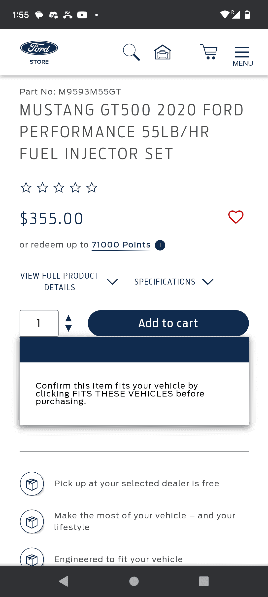

But you can use the 2020 GT500 52 lb injectors if you want. I don't think though that they are that much cheaper than a 1000cc injector, I only paid 550 for mine pre pandemic.
