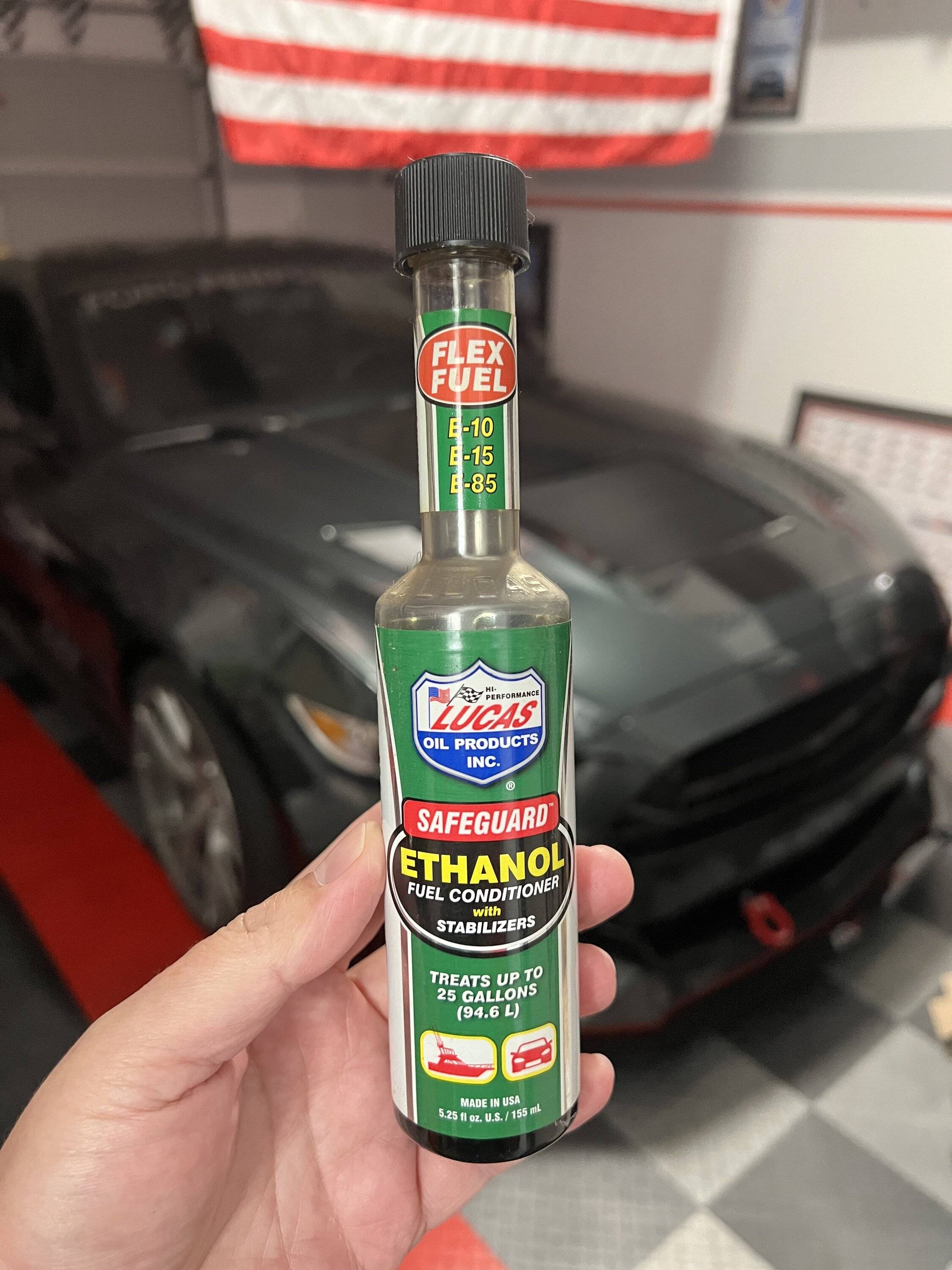

I can't think of the name of the Lucas additive I put in every tank & just finished the last of it this last tank.
2morrow
DesignR/DriveR/RiceEatR
Nov 15, 2015
58
6,495
6,108
NorCal Bay Area
Todd
'16 Mustang GTPP
Ask and you shall receive.
