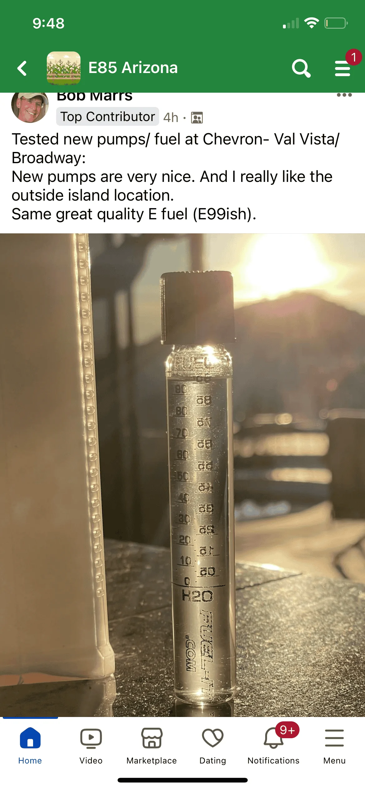

Testing is a pain haha but here is a screenshot of someone who tested a station today. I have personally tested this station multiple times and they consistently have 95+ E%. Usually it’s 98% and the other 2% is additives so no one drinks it.

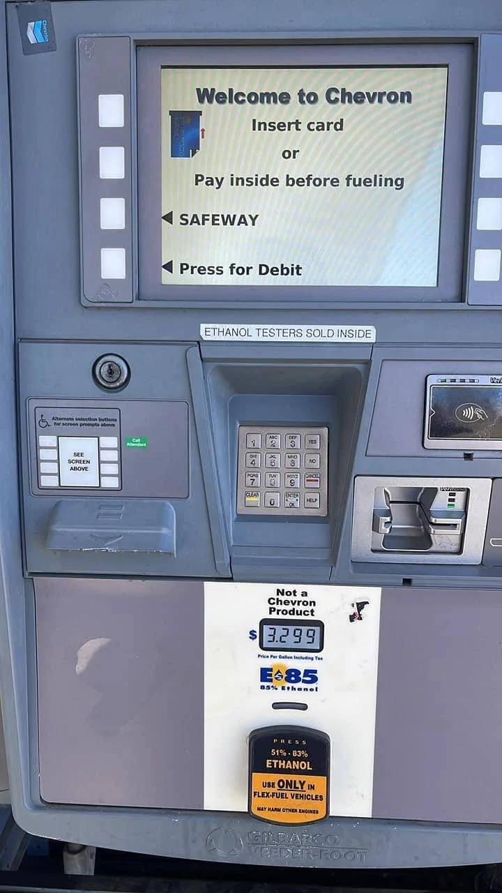

Black pump is new pump. Included a pic of the old pump. Same ethanol content for both they just recently got a new pump

Well again, if you're not letting the tube settle properly, it's going to read SIGNIFICANTLY higher than the true content.
And that little E85 logo, in order to comply it has to follow the ASTM, so something isn't right. Either you're testing incorrectly or they're truly selling "E85" with content outside the ASTM standard.
Are they simply selling the "race fuel" through the E85 nozzle?

I’ve tested many stations. It’s 98%. Me and about 100 other people have confirmed. You can tell instantly it has a really high ethanol content compared to normal e85. I’ve let it sit 20+min before.
There is another station that sells 90%+ ethanol and they have it labeled as “premium e85”. They also have another regular e85 pump that’s in the 80-85% range.
And no they have a separate pump for the 100 octane fuel. It’s just the same terminal.
