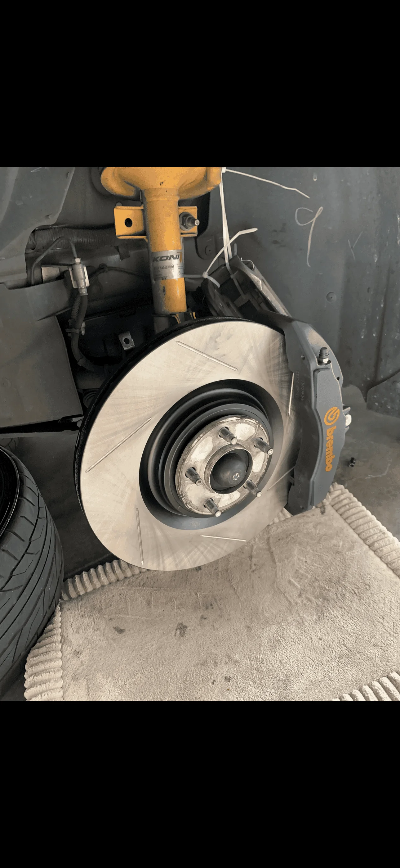

I am not going to get into the performance aspect of it. But I will share my positive experience with these slotted rotors below when I upgraded my GT to Brembos on my S197. They looked awesome and were quiet and never warped. (This was a daily though).

Slotted rotors are fine! Very different from drilled. You’ll find they eat your pads faster than blanks but not to the point where its bad.
