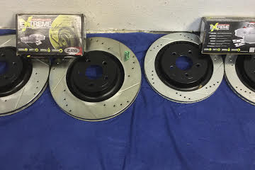

FYI....my car is street driven and occasional shows. Like the millions of other users of drilled/slotted rotors. It will never see the track or extreme consistant high speed braking.
Picked up my Z26 Ceramic pads and am ready to install my rotor Pros and new brakes.

Well said , enjoy.

Where did you get yours? Mine have silver hubs

Be careful n make sure your dust boots are free before you screw in the pistons on the rear or your going to tear them . I sprayed mine with wd40 and freed them first . A pair of needle nose pliers work well to screw them in.

I used Black Caliper paint and 2 beers!!! :cheers::cheers: I wondered if I shoul as they did look purdy. But since that's where most of the brake dust accumulates...I Thot it was a good idea. With the Z26 Ceramic Pads there's supposed to be waaaay less brake dust.

Looks good , curious as to how the paint will hold up.I'm running the ceramic pads, no dust .
