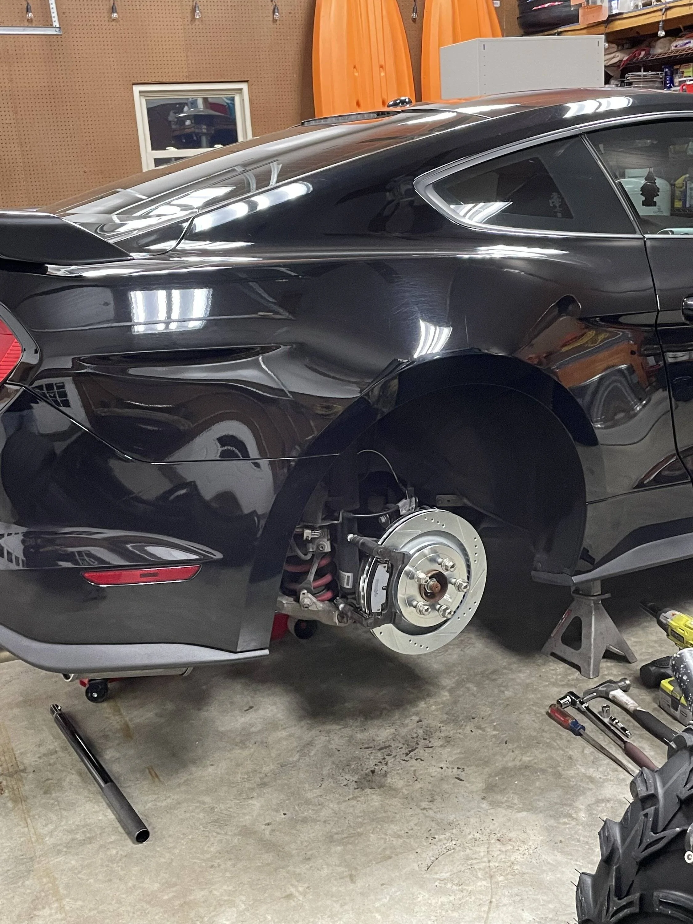

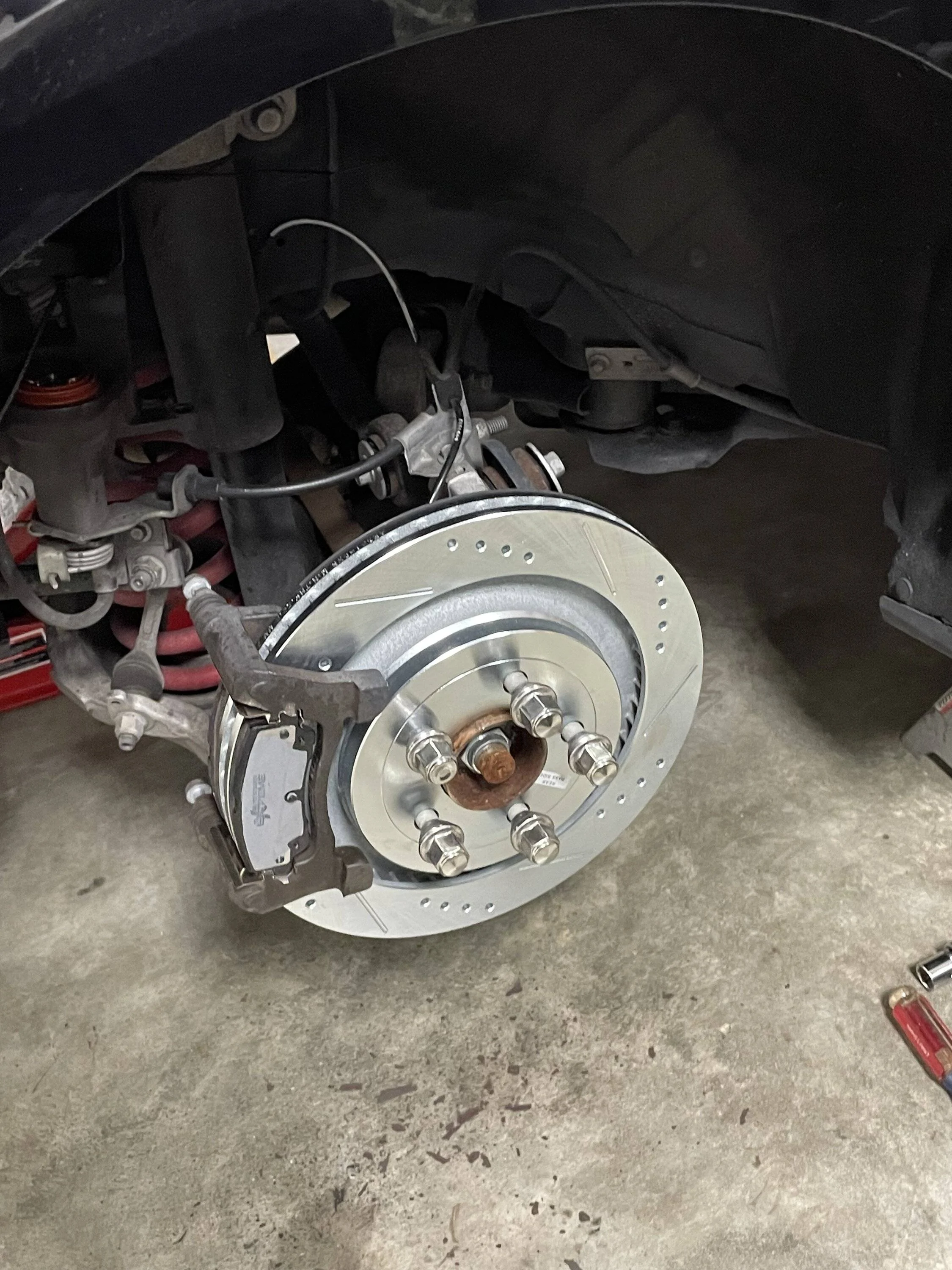

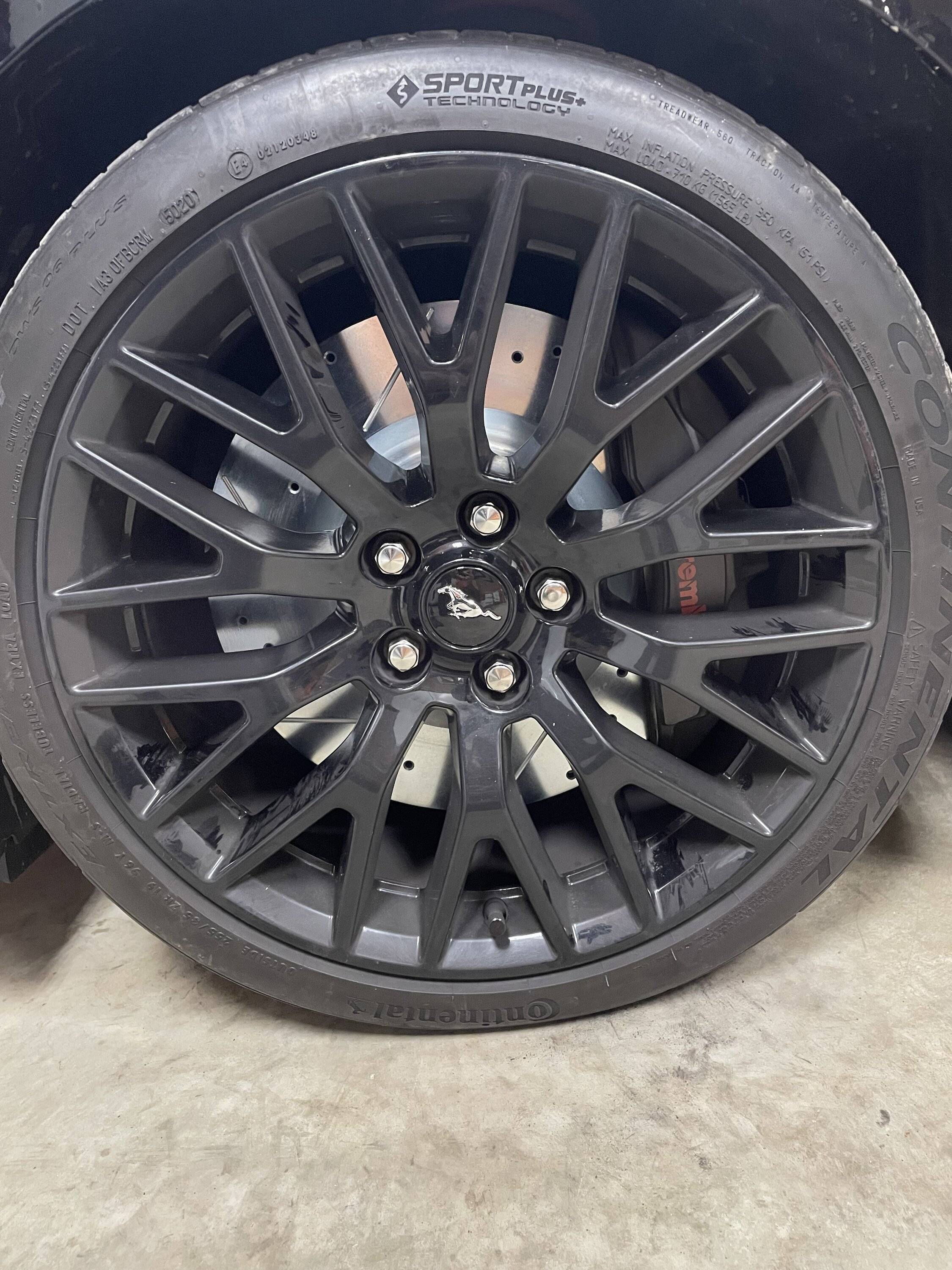

I just changed my rotors to Drilled and slotted rotors, I’m curious to see if there’s much of a difference in cooling/braking power. Any thoughts?
