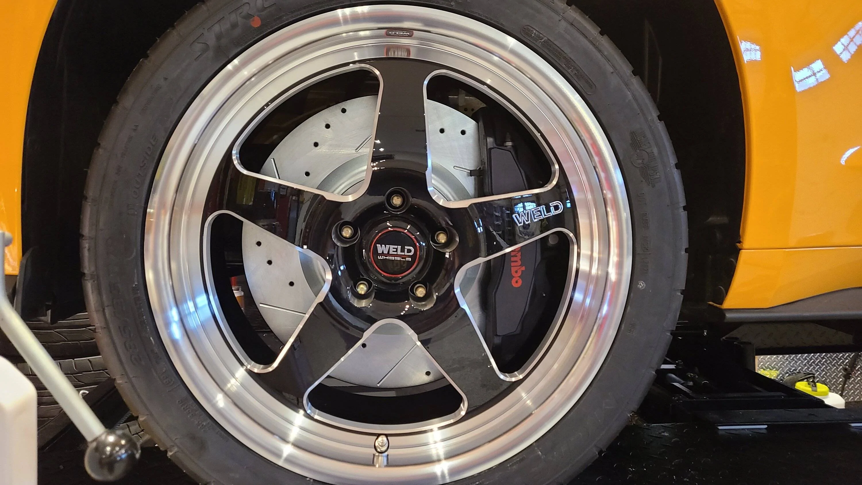

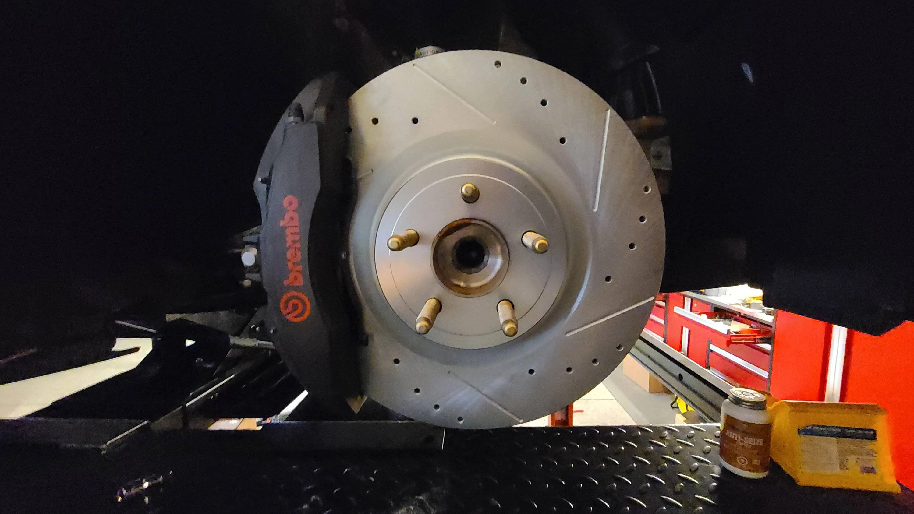

I did the Powerstop kit, Z26 I think it is?
Anyway, every bit as good as stock, far less brake dust. 100% satisfied.
Spirited driving, no track work.
Your setup looks sick !
