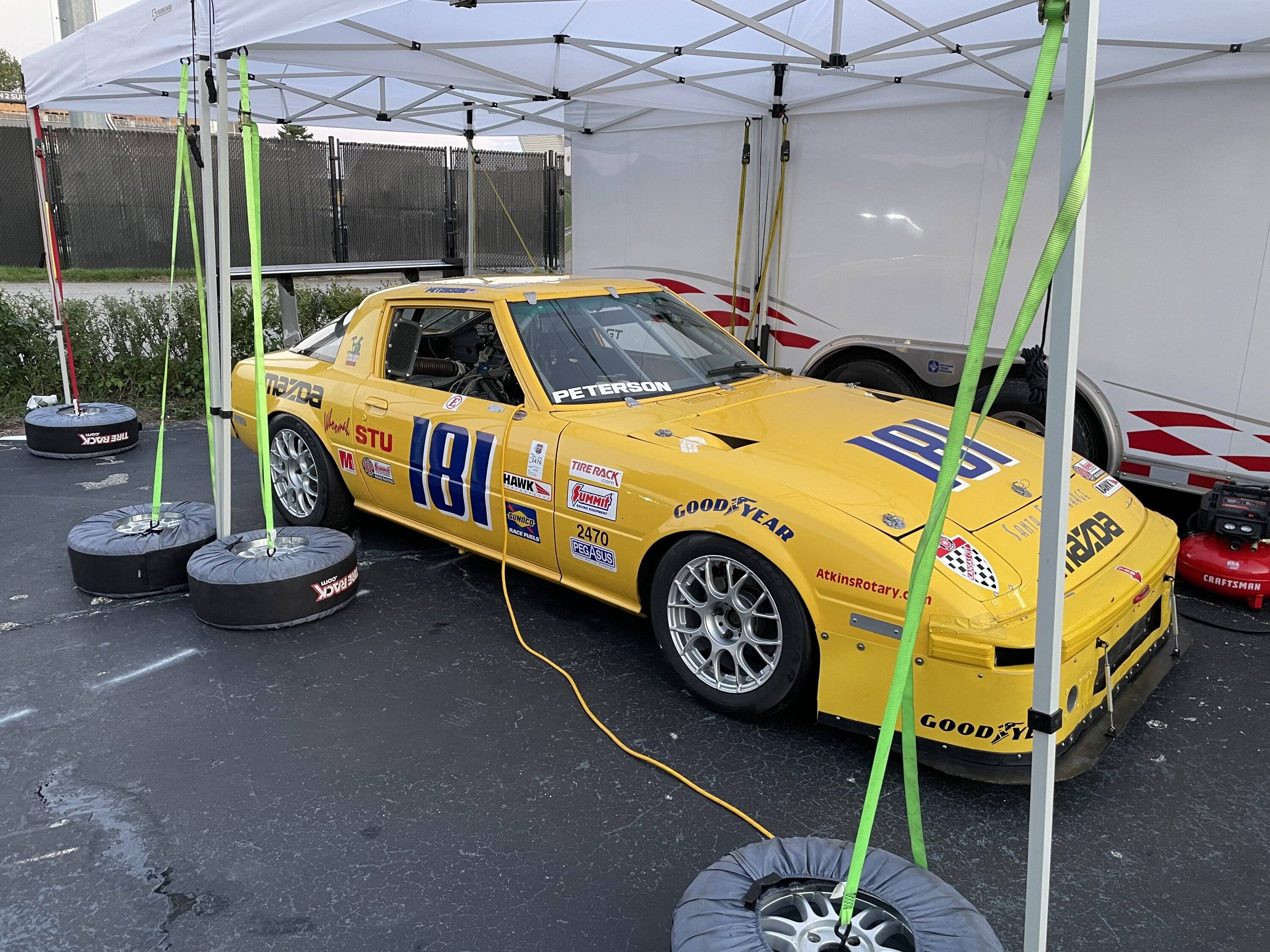

I have bolt on spacers on my road race RX7. They are a necessary evil because I needed to convert from the 4x114.3 pattern to 4x100 pattern on the front of the car. 4x100 wheels are cheaper and lighter than 4x114.3 wheels.
Any way, I looked around at what was available commercially and decided it was better to have them made. So www.santafegarage.com made me set of spacers using USA 6061 billet material and ARP studs. Also everything is hub-centric. They are a pain in the ass but I found a way to keep them torqued without a helper. Adds another item to the nut & bolt check.
All of that said. my RX7 weighs 2475lb wet with my fat ass in it. Much lighter than my 3968lb Mustang so keep that in mind. I did hit 132MPH at Indy with this setup.

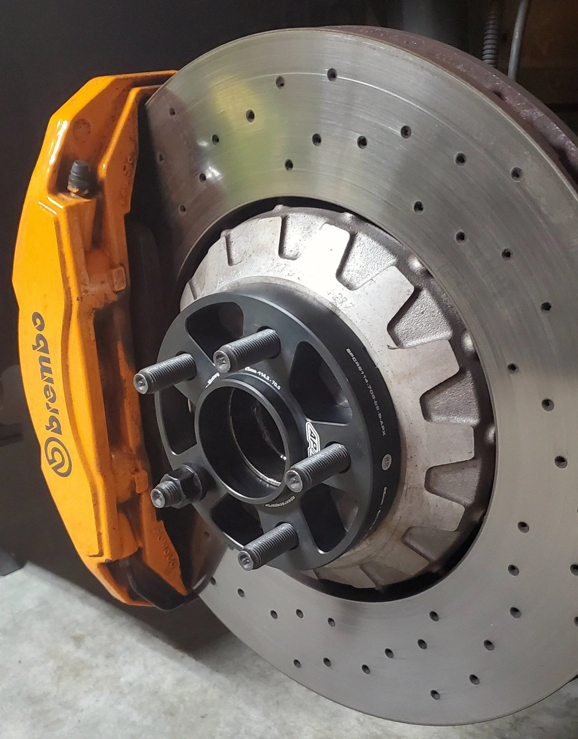

I run that exact setup OP. Extended studs a most and grab some open end lug nuts while you're at it. That way you can take the spacers off and go back to street wheels and tires too if needed.
Street on top without spacers, track on bottom with spacers.
25mm Spacer with longer studs
