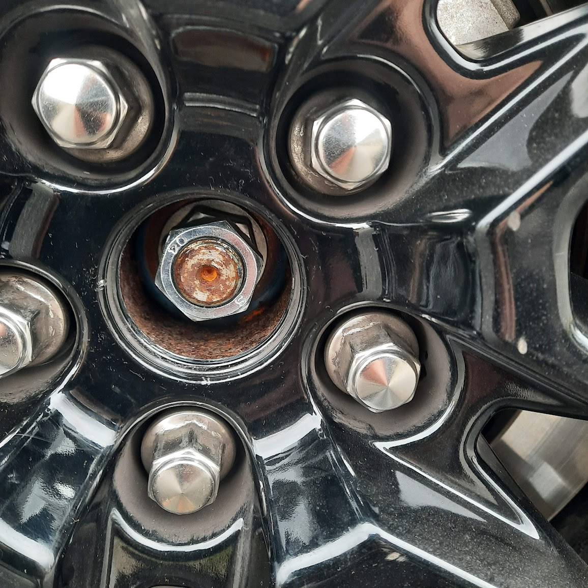

If you have ever experienced a hub failure due to loose axle nuts it is.
Installed jam nuts from Optimum Performance today. Is this a normal amount of rust/corrosion in there? Before install:

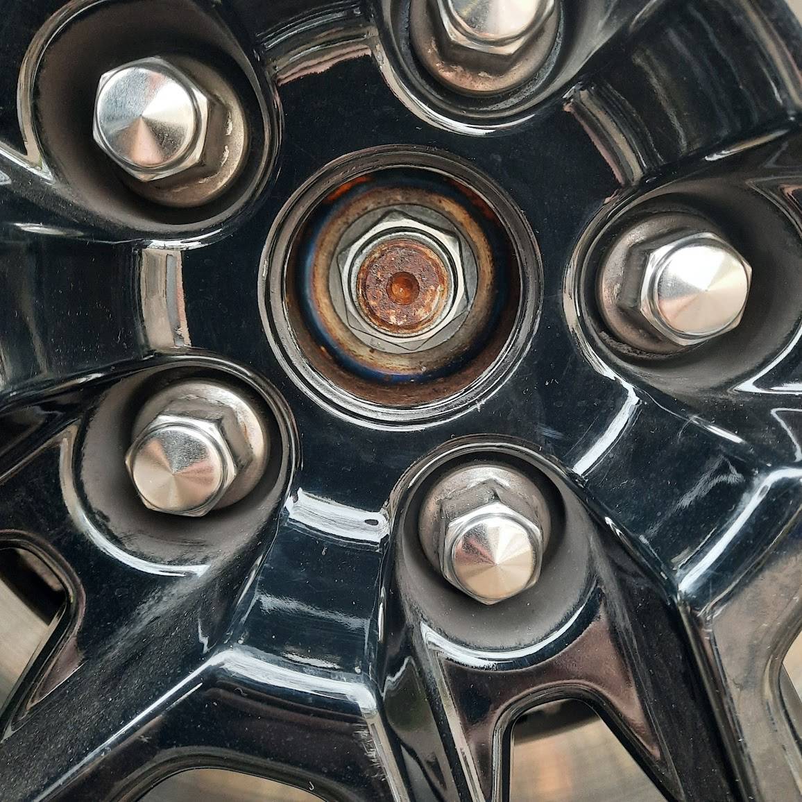

After installing jam nut:

2024 Ranger Raptor; previous was the 2019 Shelby GT350
Yeah, unless everything is painted rust is normal, this also comes from wheel cleaners, road salts, brake dust all contribute.
Thank you. I kinda suspected but I feel better now after getting a professional opinion.
