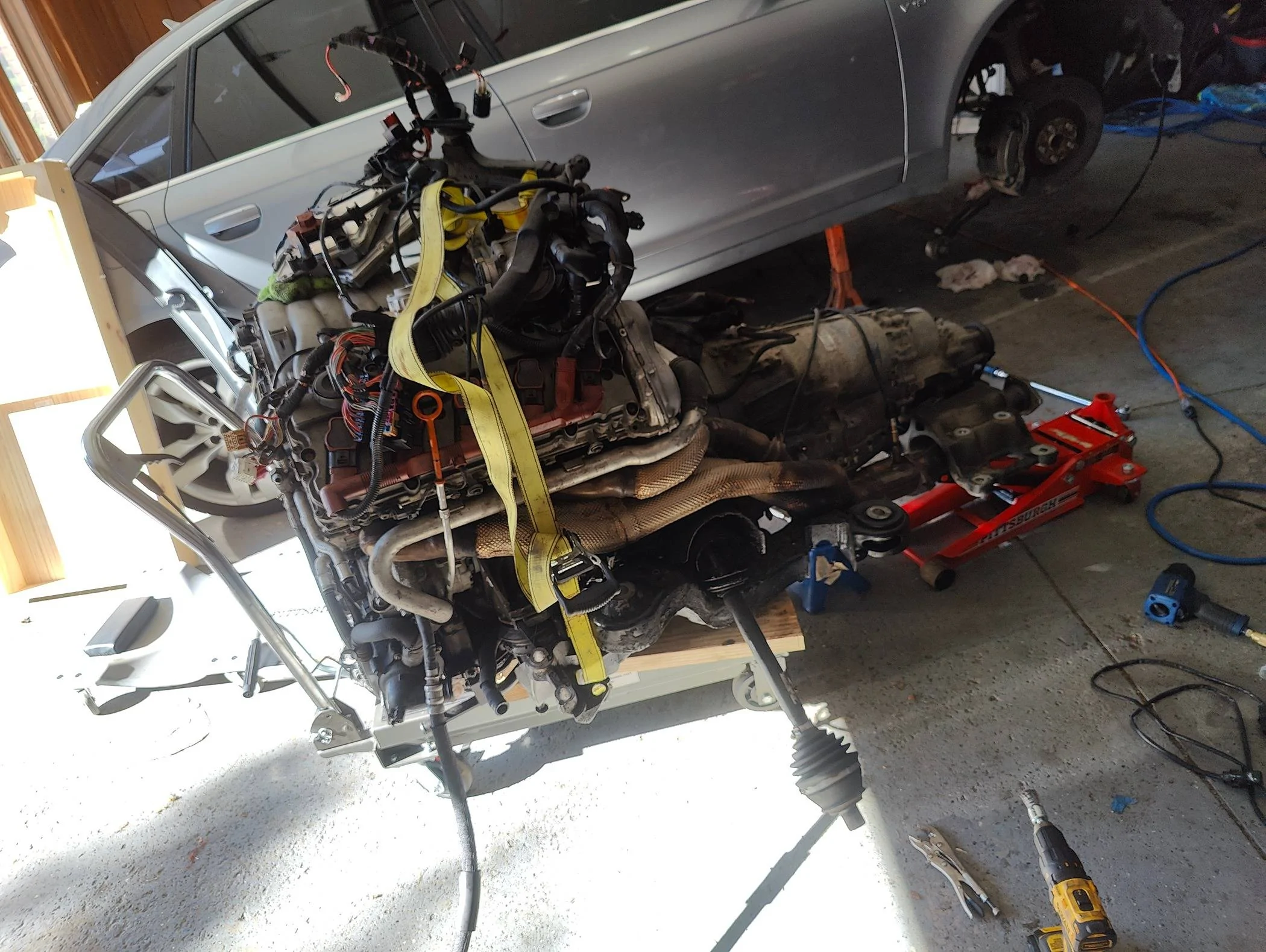

Has anybody removed a mt-82 without a lift? How difficult it it realistically? I am Definitely comfortable mechanically, I removed the engine/trans from my Audi s6 over the winter and that was just on Jack stands in the garage. (2 more cylinders than my 17 gt) So I would imagine it is doable. I could also use a quick jack doing this. Really just comes down to me not wanting to pay the money to have a shop put the clutch it.

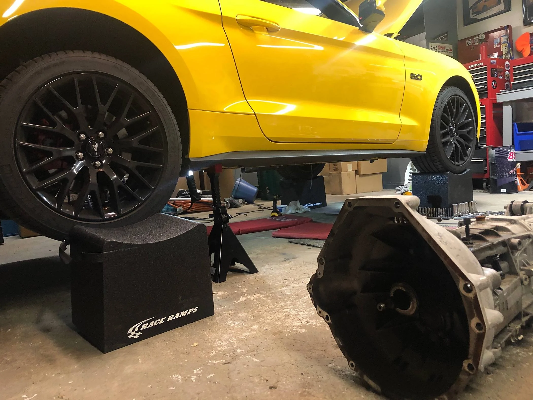

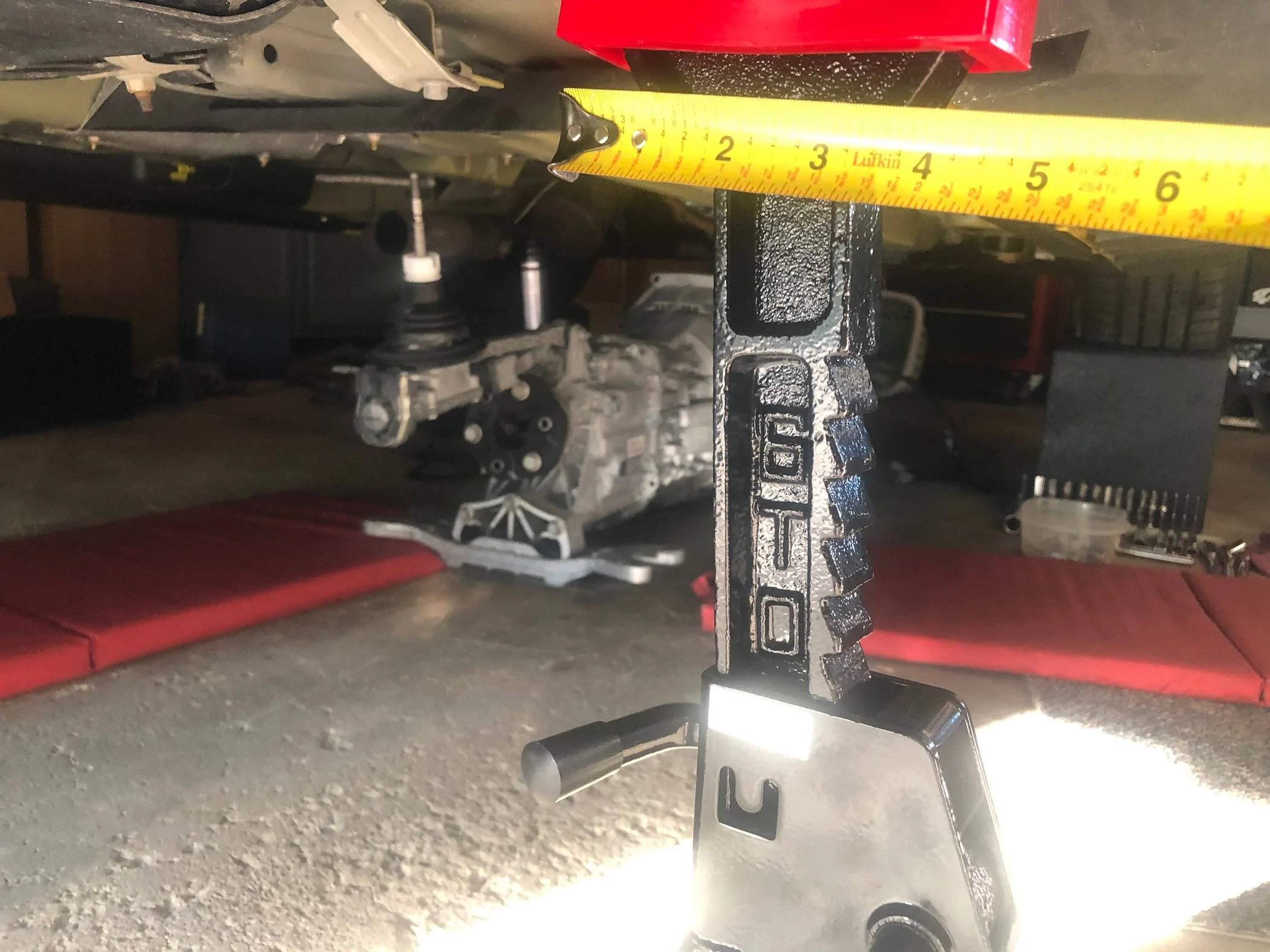

You got this! I want to say you’ll need to get the car about 23” off the ground. That should be enough to get the tranny out.

Sweet. Appreciate the info. I really just need to put a new clutch in so worst case scenario, it can stay under the car if I don't have enough. But I don't think it'll be a problem.

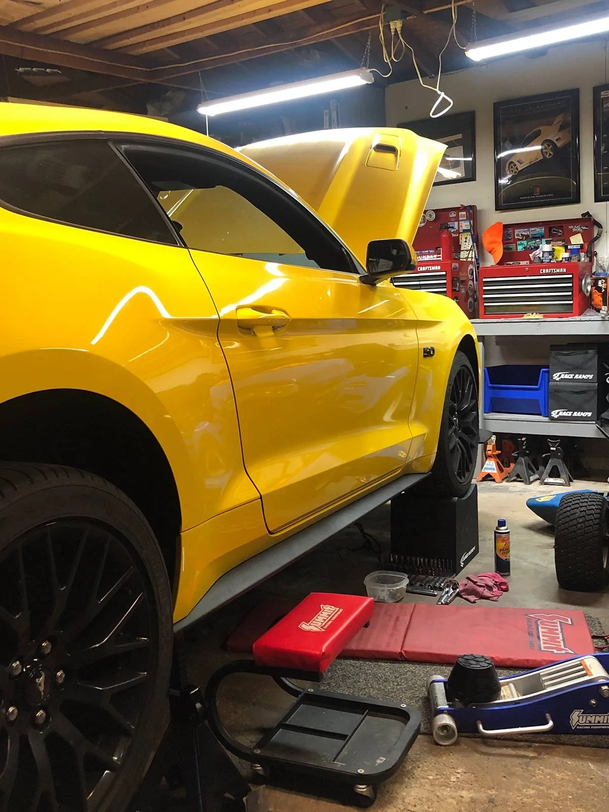

I did my clutch on jack stands in my garage. 23" is about right. I got the Harbor Freight tranny jack and that made it easier to control as well.

Did my 15’ on jack stands years ago with some help and a trans jack so I highly recommend using one as well. I would imagine the QJ’s would be sufficient as long as you have the higher lift model

Was also able to do this on jack stands & cradles. I didn't buy the tranny jack but did tack 2 angle irons to one of my old jacks & it did the trick.

I used the bigger 6 ton jack stands and a transmission jack from harbor freight with no issue.
