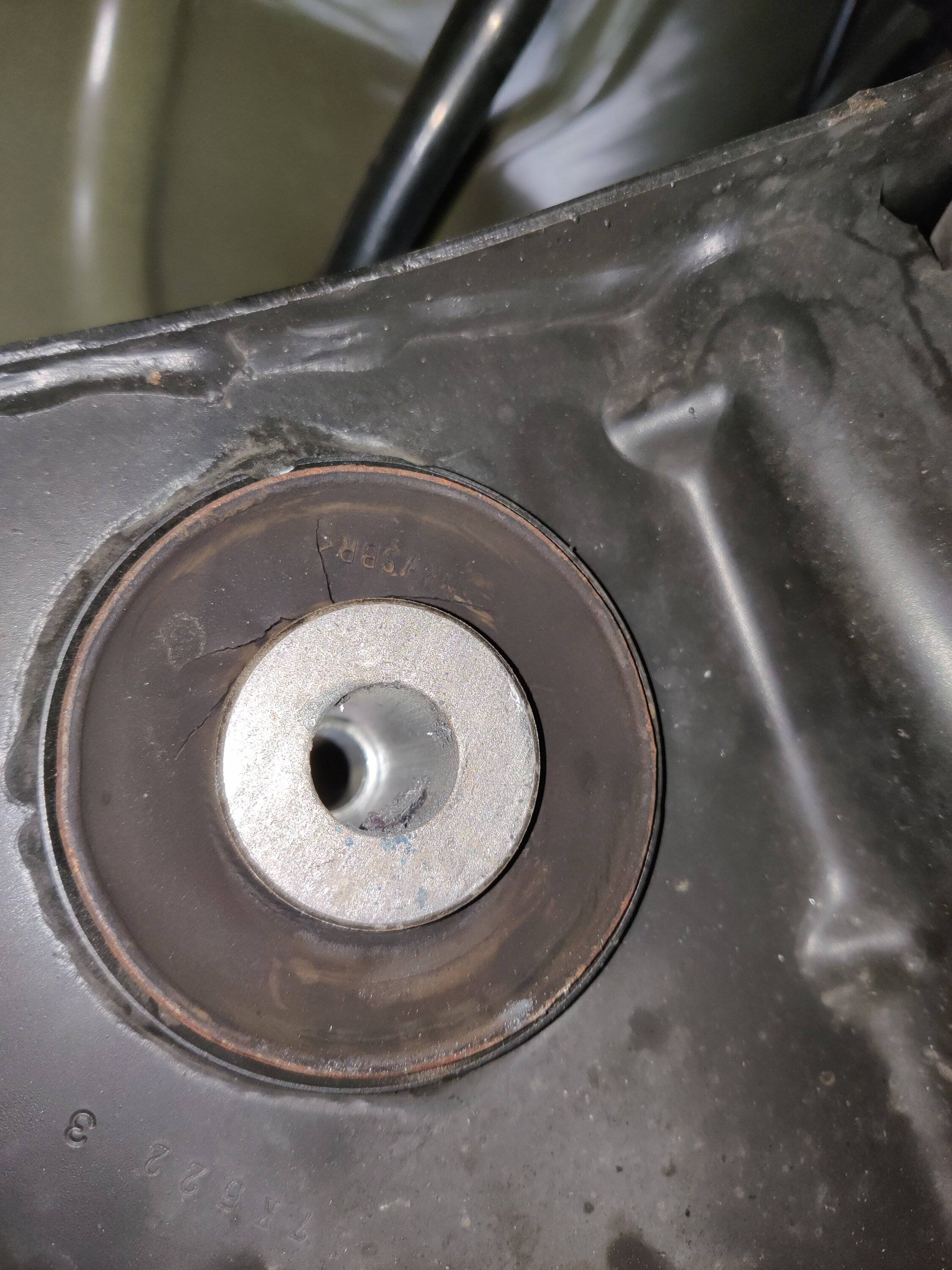

I'm in the middle of a diff swap and one of my rear bushings looking worse than I thought. I installed white line pucks previously when I noticed some cracks. But...I have the diff out now so...opinions? Should I just replace the bushings entirely?
Attached pic is from between the bushing and diff.

IMO cut them out.
Yeah...I guess I may as well. Feels weird putting this back together but leaving that bushing looking like that.
Now the problem...I'd go with whiteline kdt933, but looks like these are 4-6 weeks out...I can't delay finishing this for that long. I guess bmr is an option...is there anything else? Not wanting to add a ton of NVH...car is mostly track at this point but I do drive it to the events and other trips.

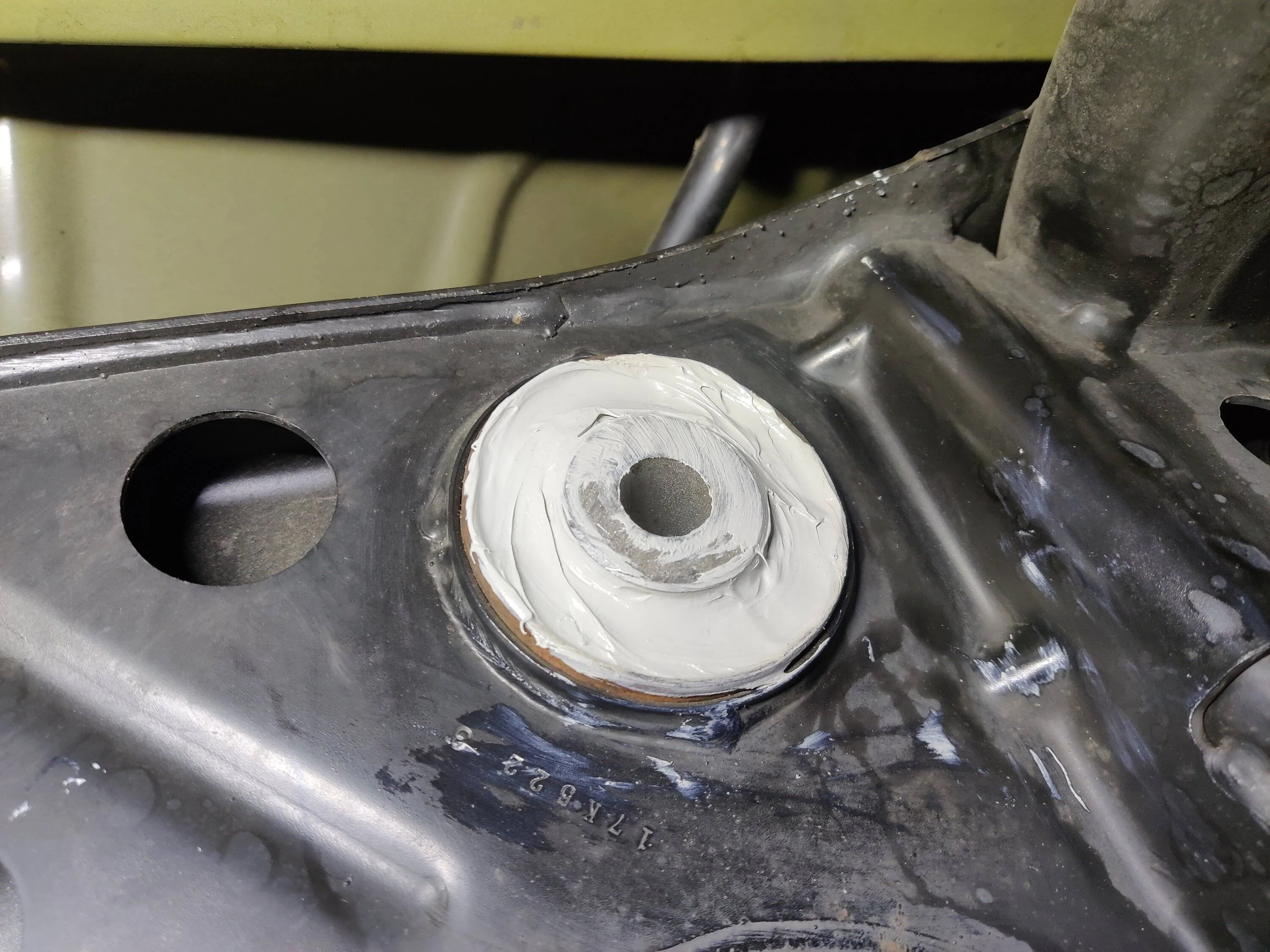

Having no time to wait several weeks, I took your advice, got some polyurethane that hardens about 45 durometer (should be about what the stock rubber is, if not a tiny bit stiffer) and filled best I could. Looks decent, seems stiff now. Kept the whiteline pucks too with the bolt shims. Hoping it'll hold. Should find out soon enough.

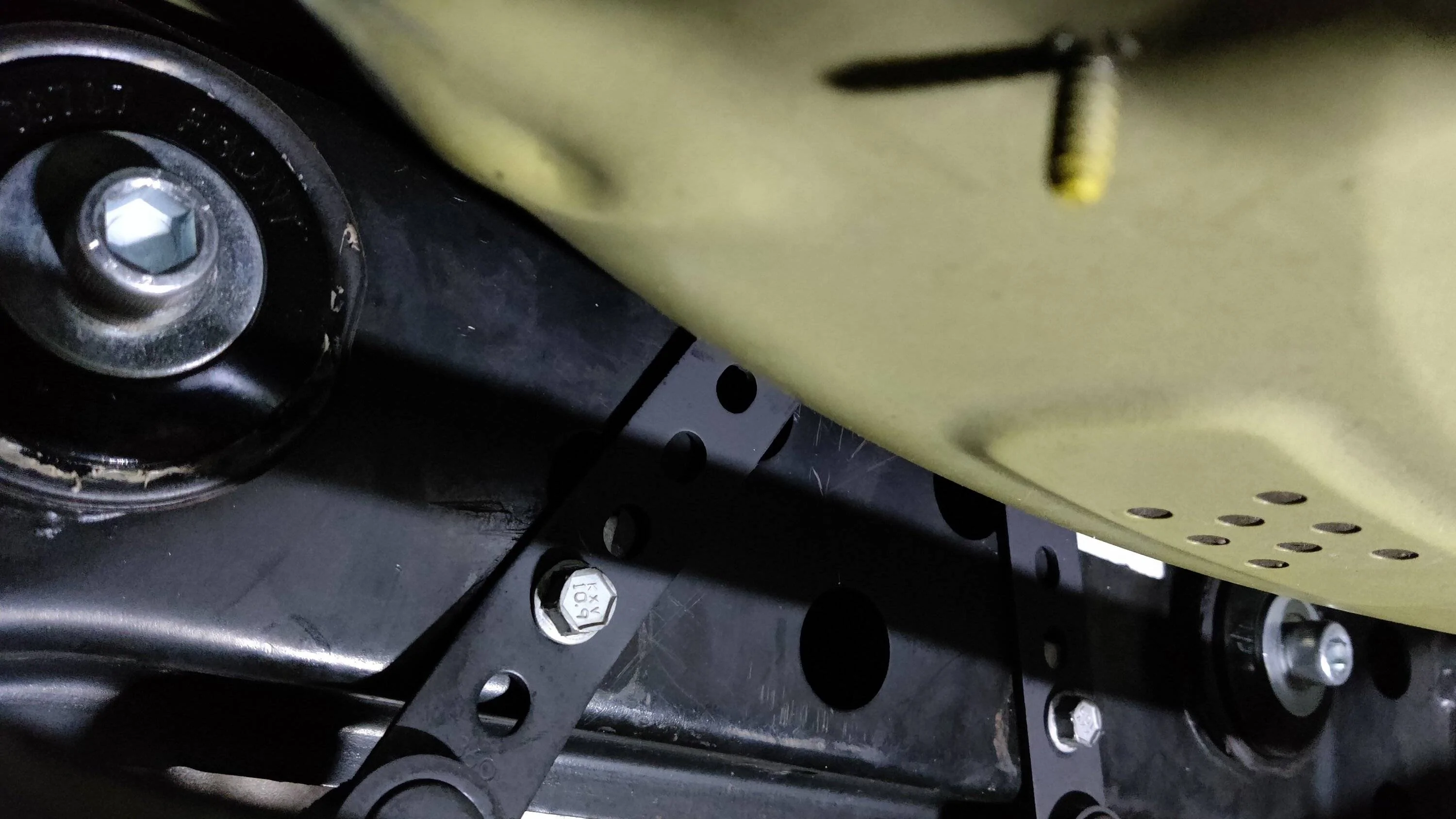

I did - Straight drilling didn't work very well to make a usable hole in the soft rubber though. I suggest using a small hole saw bit or just a hole punch to actually make a few usable holes. Either way, I filled with a soft polyurethane(40-45 durometer) as best I could and covered all cracking in the existing rubber. Picked up the stuff at a hardware store. I hear 3m window weld also works well (But will be a little stiffer). Mine were cracked all the way through the bushing. I filled it very thick on the diff side and very light on the rear side - so I could still use the whiteline pucks that I had to continue to mitigate further damage. Also added the full length bolt sleeves and upgraded bolts. Hoping to not have to replace the entire bushings. So far so good. I have not noticed any additional noise either.
From the diff side:
From rear of car (after everything was installed):

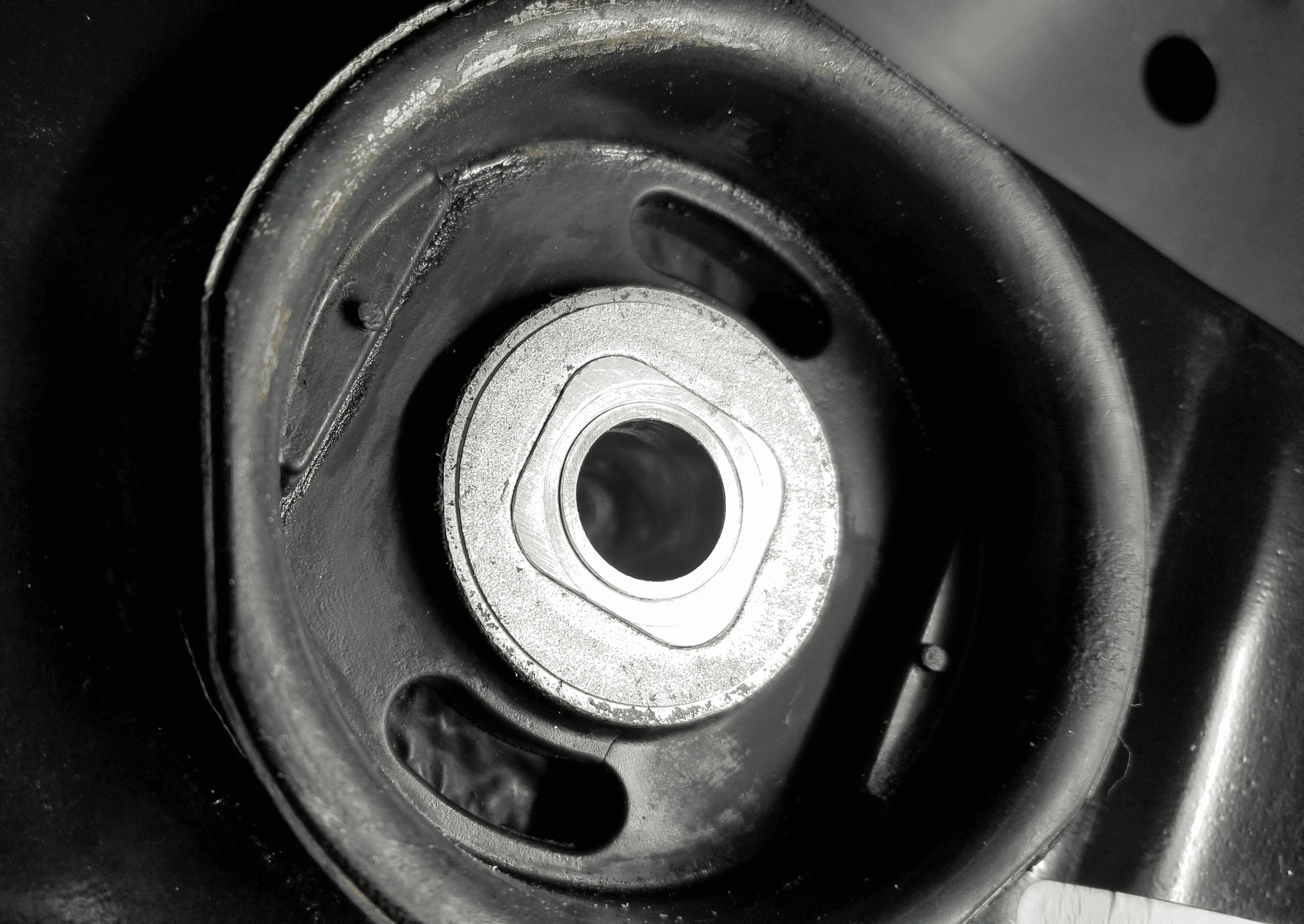

Thanks! My rear bushings have what look like voids but I never determined if they went all the way through.

That looks typical of just a thin skin where the tool has worn and allowed what we could call ‘flash’ to form between the two tool halves. I reckon if you poked it with a small screwdriver it would puncture and tear away very easily.
Did both sides of your car have those voids ? Based on the rear bushings, mine only had the voids on the right side ?

From the rear of the car looking forward, I can only see voids on the right hand side. The left side was solid. I couldn't see nor was I looking for voids on the other side of the bushings. My guess is they are there.
I was watching the video Steeda made of the IRS movement. That right side bushing stretches like a rubber band. So much, it's no wonder they tear.
