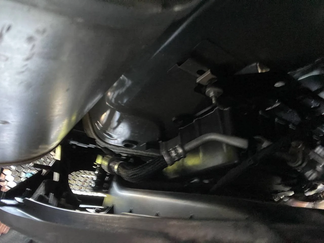

Any one have a pic of the diff cooler setup? Is there a fan on the coil?
Thought I took a pic at Barrett Jackson when they have the new Mustangs at 90 deg for underbody view, but no joy.

I'll get a pic for you later today. But there is not a fan on the heat exchanger. It's completely passive and relies on the car to be moving to work most effectively.
Generally these have worked really well on the GT350s.

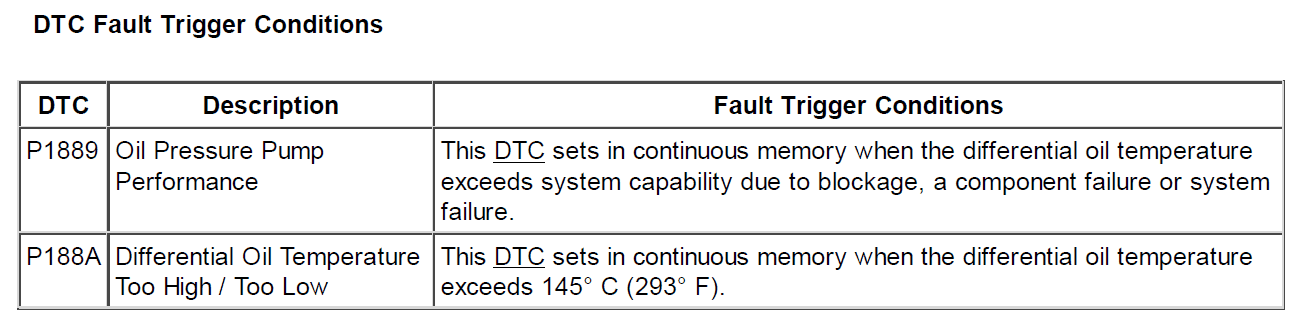

This may help :
I believe that’s the temp that limp mode starts ?

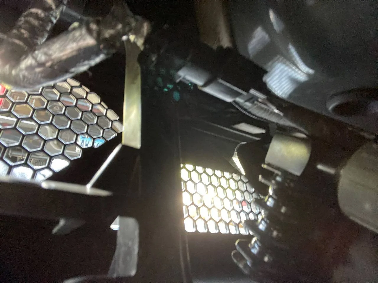

Per your request, attached are the best pics I could get of the diff cooler without putting the car on the lift (currently occupied by another vehicle). These are from the diff facing backwards towards the rear bumper. You can see the cooler lines and the heat exchanger just before the bumper, tucked in behind the box for the Evap equipment.
There isn't much room for a fan. I think you'd have to move the cooler and would likely end up with something like the FTBR setup in the end.
