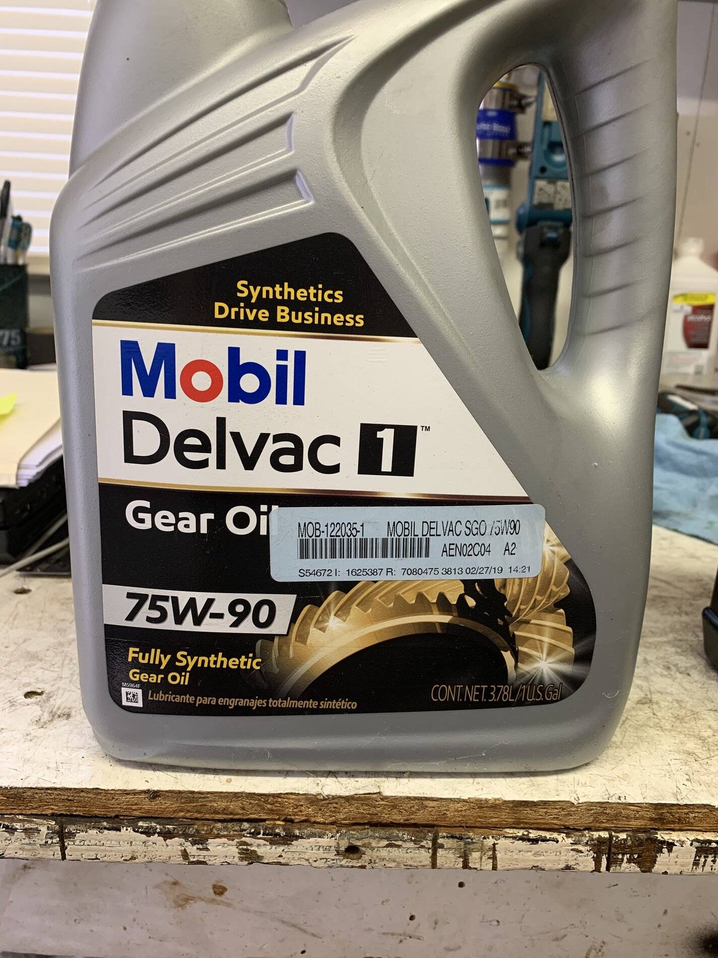

I have had good luck with Mobile 1 Delvac in my PP1 Torsen. Got several buddies running it also.
$35.99 per gallon at Summit Racing.
