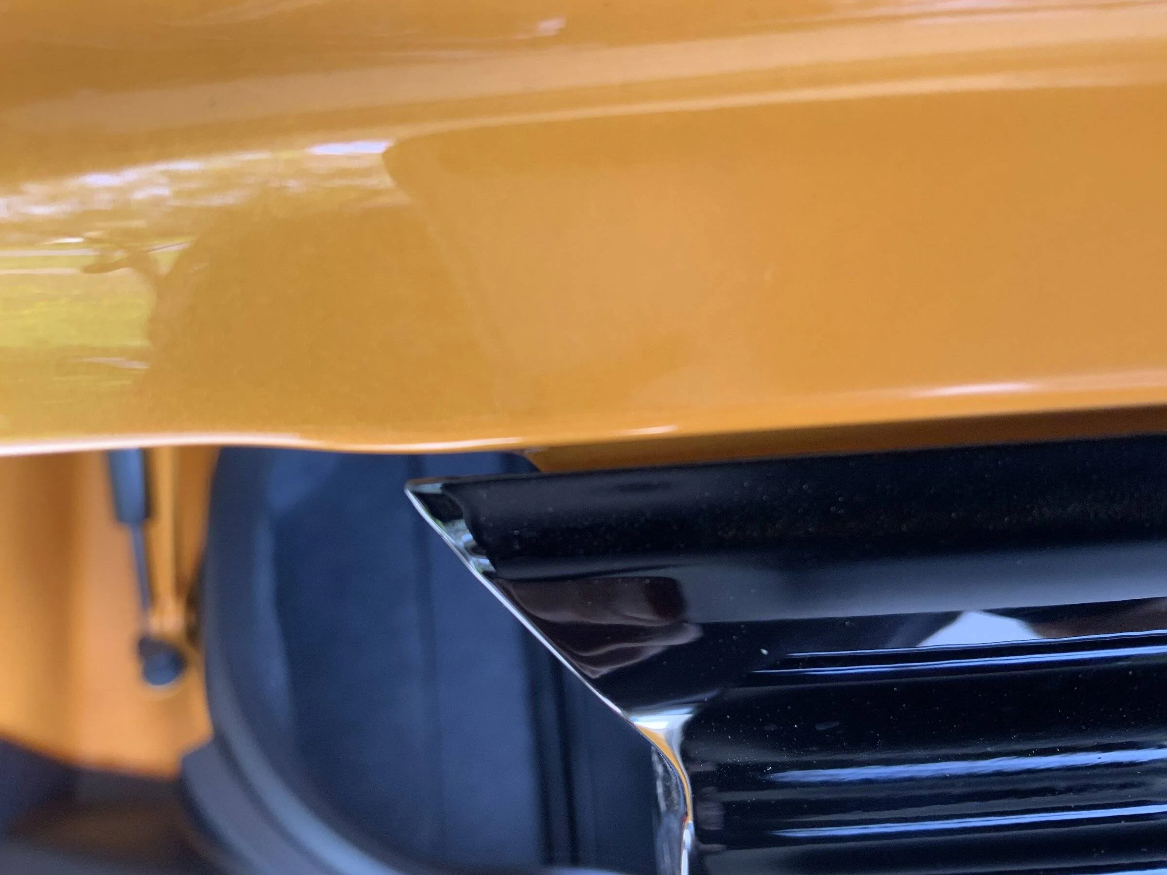

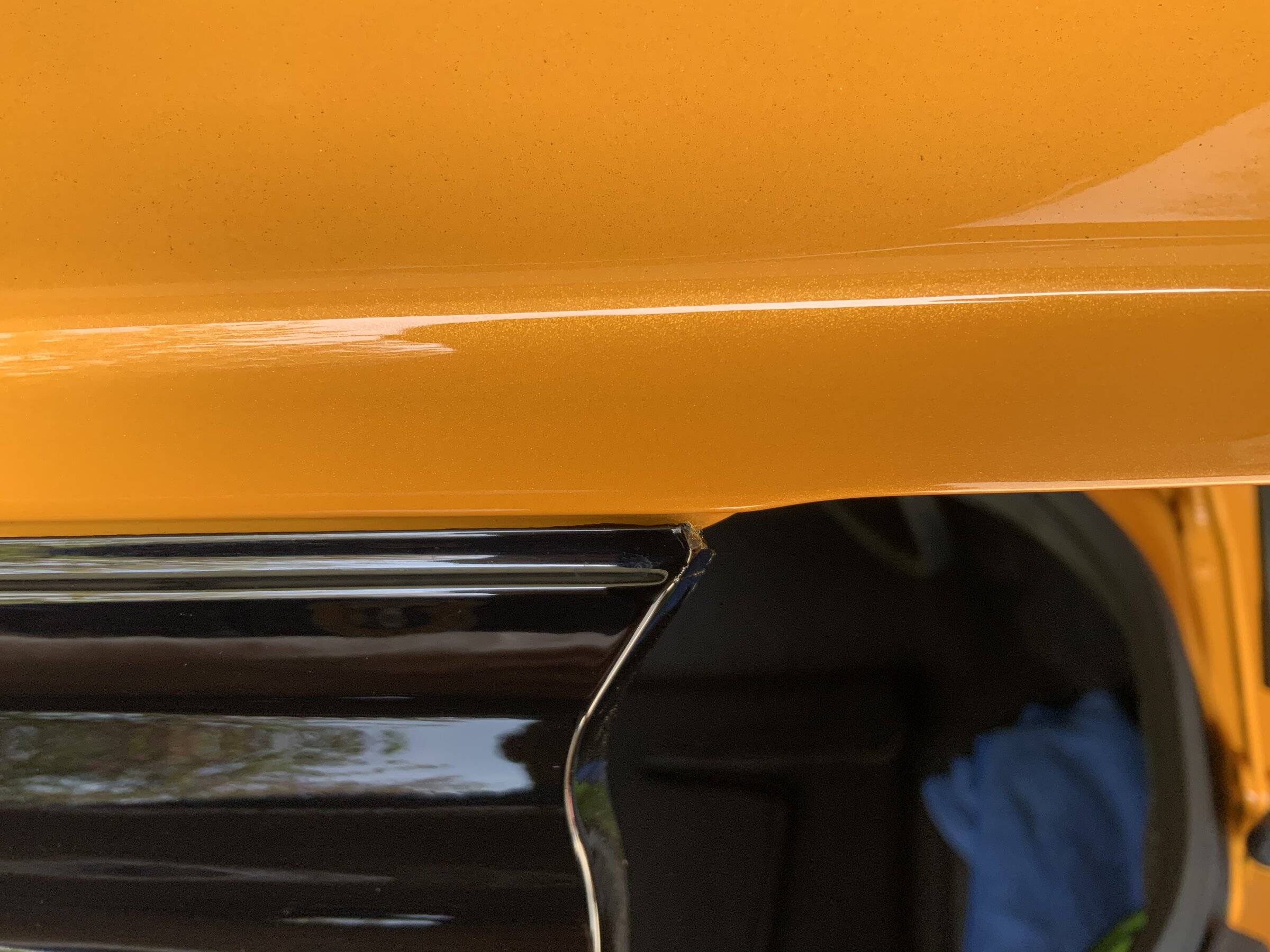

Thanks for the ideas guys. I just looked again and per the below pictures it is clear that the deck lid is off. I’ll try my dealer first and take it from there.

This is exactly the same issue mine had - looked just like that. The new lids looked the same and the tech that did work actually scratched the paint in that area doing the swaps. I kept the third lid because I didn't want to risk more damage only to have the same fit.
If you can't live with it as is, be advised they may make the situation worse. 😣

My decklid si set with even spacing right and left, but sticks out from the contour (as if it was not completely closed). Accidentally I talked to another Mach 1 owner here (with FJG package) who said he had it the same way. While @Charlemagne has it perfectly aligned (lucky bastard :wink:)

I adjusted my lid a little. It is held on by 4 clips on top and 4 screws on the bottom. There is a little room to slide it a little and one side of clips was not fully inserted. Not perfect but better.

Thanks, I looked at a couple of deck lid replacement videos on line and wonder if ther was any play in the slots for the clips.

My deck lid on my 21GT was mis-aligned too and I didn’t notice till it chipped the paint when opening the trunk. I had the dealer fix it and was happy with the repair.

You can adjust or reduce the gaps by adjusting the positions of the rear taillight assemblies.
Try this:
https://www.mustang6g.com/forums/threads/check-your-taillight-gaps.129865/page-4#post-3099616
And you can also try adjusting the rear trunk lid catch (and this thread also has users who did the washer trick noted in above thread):
https://www.mustang6g.com/forums/threads/fitment-of-decklid-panel.166985/#post-3398179
