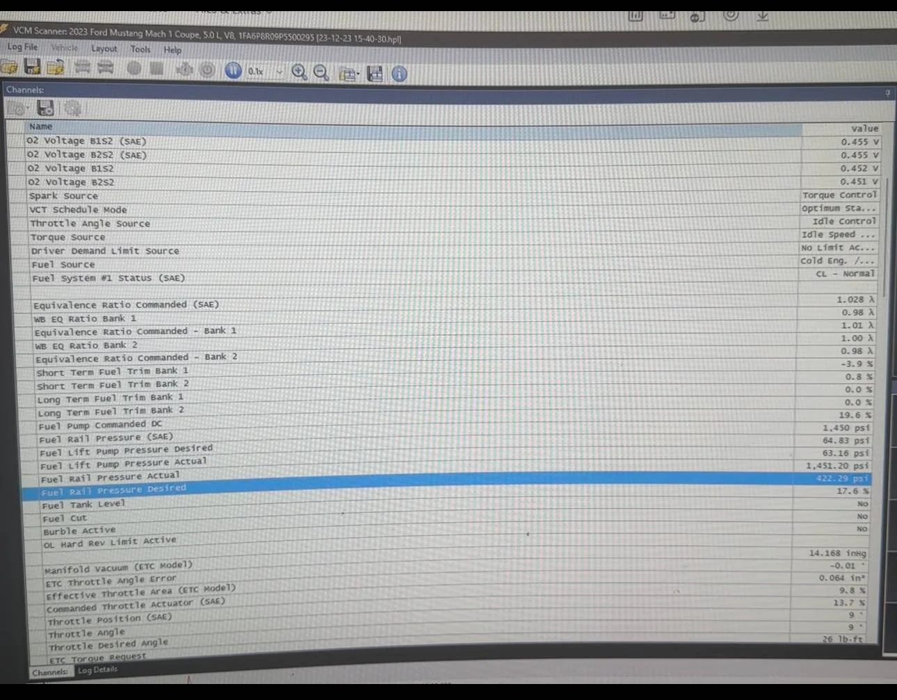

So the parameters that I found off were the fuel rail pressure actual vs Fuel rail pressure desired.
My fuel rail pressure actual rrsds 1400PSI after starting and it slowly climbs until the car starts to idle bad, buck, and stall.
The fuel rail pressure desired at idle is 400-500psi and increases to 1000psi at a rpm 2k
However, the fuel rail pressure actual does not follow the desired pressure and it keeps climbing and only decreases if I rev the engine. After revving the engine the idle becomes stable again until the psi gets 3x times the desired and then it misfires, bucks and loses idle.

the fuel status changes to op - fault when it starts the idle and issues mentioned.
The Fuel pressure at the rail was 1900psi while desired remained at 400.
Is it normal for it to be off that much?
I have a data log of when my car was running fine and the fuel rail pressure never got that high even at rev of 4500rpm.
