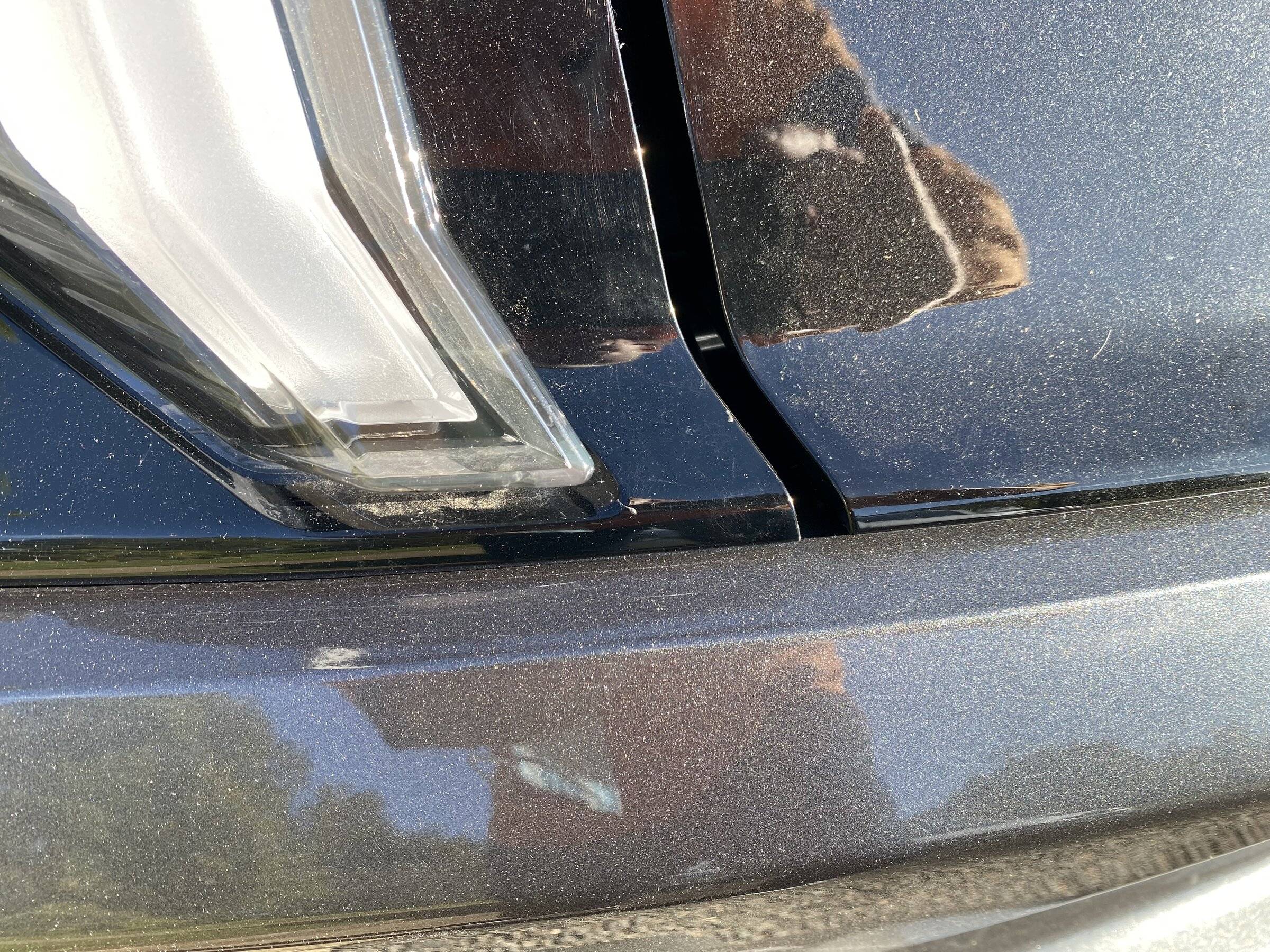

I finally got some closure today on my deck Lid Panel. After being told by the service manager that Ford doesn’t do warranty for fit unless it is 3/8” or more I went to the owner ( small dealership ) He said that the he would make it right and set up an appointment at a local body shop. While discussing with him I kept on hearing “trunk lid “ adjustment. I called and told him it is the “deck lid panel “ that is off and the trunk lid is perfect. I suggested that I bring it in to him so I could show him exactly what was off since he couldn’t see it in my pictures. Long story short we popped the two plastic covers in back of the panel, removed the 4 screws, and were able to move just enough to make it look ok. ( I had already done this at home to see if there was room for adjustment, but did not want to force it ) So after all this, it took 5 minutes to fix. Two things, dealers get bashed a lot ( well deserved mostly ), but my dealer was willing “ to make it right” . Second, I was lucky there was enough play to make the adjustment. Time to enjoy the car now.
I will have to try and pop mine off and look at it. Knowing it is there and off drives me a little crazy cause once you see it there is no unseeing it. Seems like it is off about a 1/4" or more on the left side sticking out vs the right side seating what looks like, perfectly.

Pics would help here on the solution that worked, at least of the back side. I hate to pop off the wrong thing. My situation is exactly like Vertex. And strange enough I have seen multiple 2022 Mustangs with this same issue. Some dude not working out that left arm enough on the line.

I actually repaired mine myself. Removed the tail light and adjusted the fit with a couple of rubber grommets. The tail light fit is definitely the problem. Photo to follow. Cheers!
