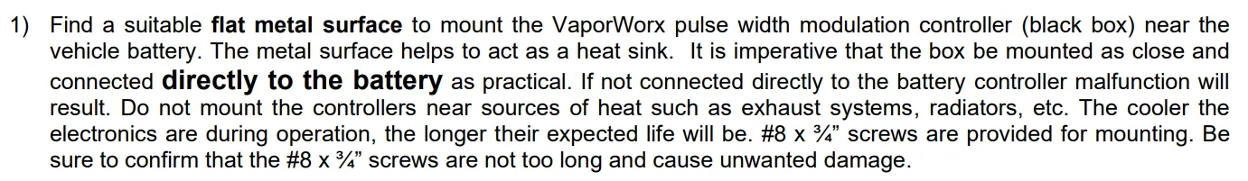

Where is the best place to mount the Aeromotive/Vaporworx controller? Their instructions state close to the battery, but not near heat sources. I don't think under the hood is ideal and I have no real room there anyway.
@Nobuemon are you planning to leave it where it is? @NGOT8R any idea where you plan to mount yours?
@SheepDog you ran this controller for a period of time, where did you mount it?

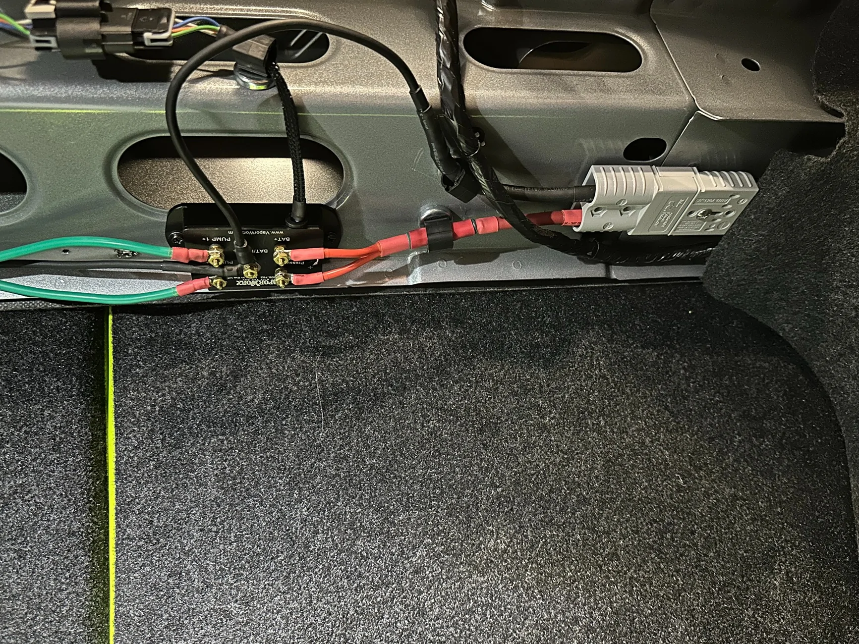

I mounted it in the trunk up on the decklid area. I already had power wires ran for my previous controller, so I just wired them into Anderson connectors so I could easily swap them out.

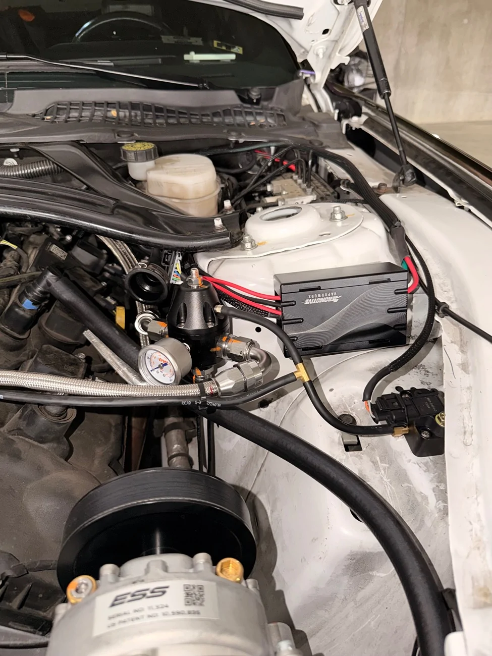

For now -- yes, since it's not getting hot at all and only warm to the touch. I'll reassess its' temperature next summer but as you've mentioned already, there's not much space available to mount it, unfortunately.
OK, perfect. That's exactly where I was thinking of putting it. Not exactly close to the battery, but as long as the wire is up to the task, no worries I suppose. I already have some good size power wires going from my pumps to the fuse box under the hood with 25amp fuses. It would be nice to just reuse those if I can since I already ran them through the car.
really 8AWG wire would do the trick. Vaporworx wants your ground wire to be a homerun to the battery as well. I had 4 AWG already installed, so I just reduced it but definitely overkill for this controller. I mounted the MAP sensor under the plastic radiator shroud/cover, so that my boost reference was as short as possible to my vacuum block. The wiring for the MAP sensor they provide will easily reach anywhere in the car.

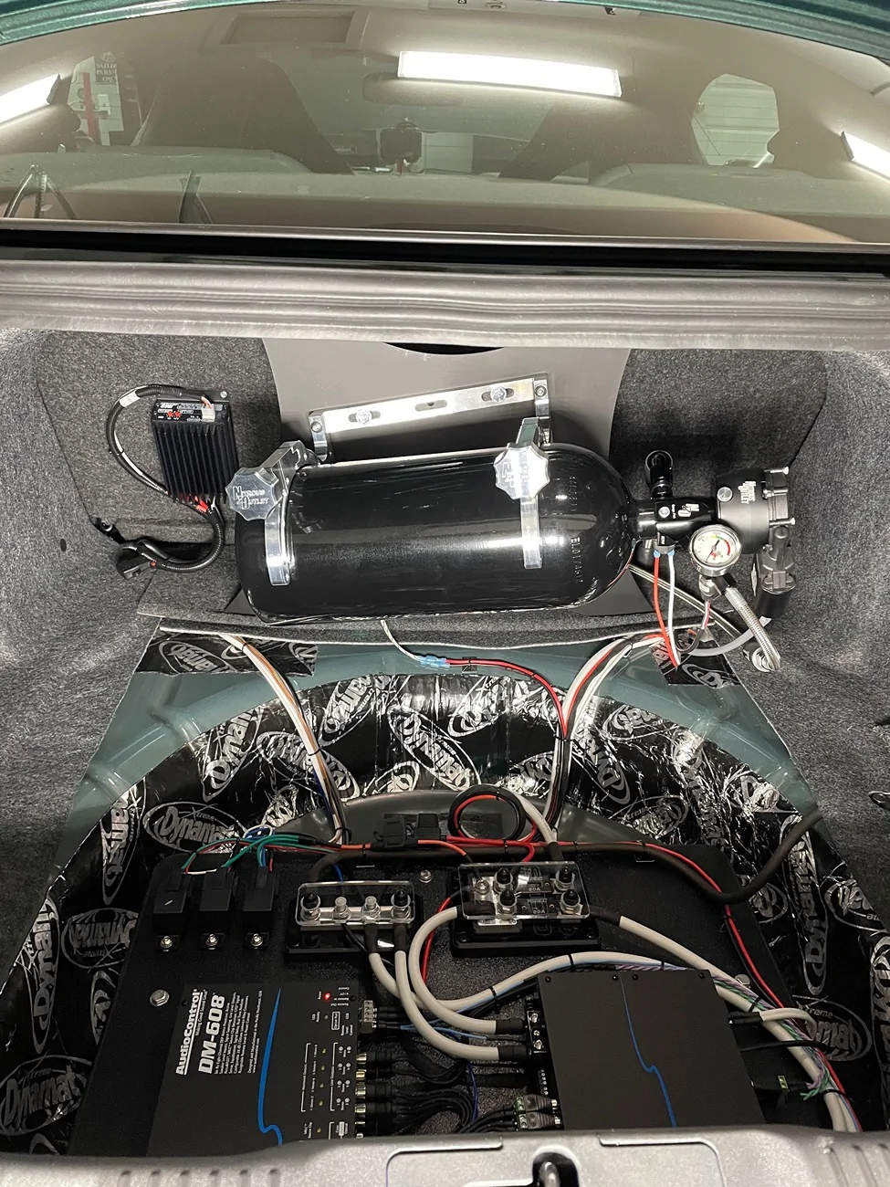

I’ll probably mount mine on the passenger rear seat back like I mounted my BAP on the driver’s rear seat back.
The BAP won’t be used with the new fuel system, but it’ll stay where it’s at before I give it away for pennies on the dollar, lol. I have a power distribution block (see white power wires) in my trunk, so I’ll connect the power lead there for convenience.

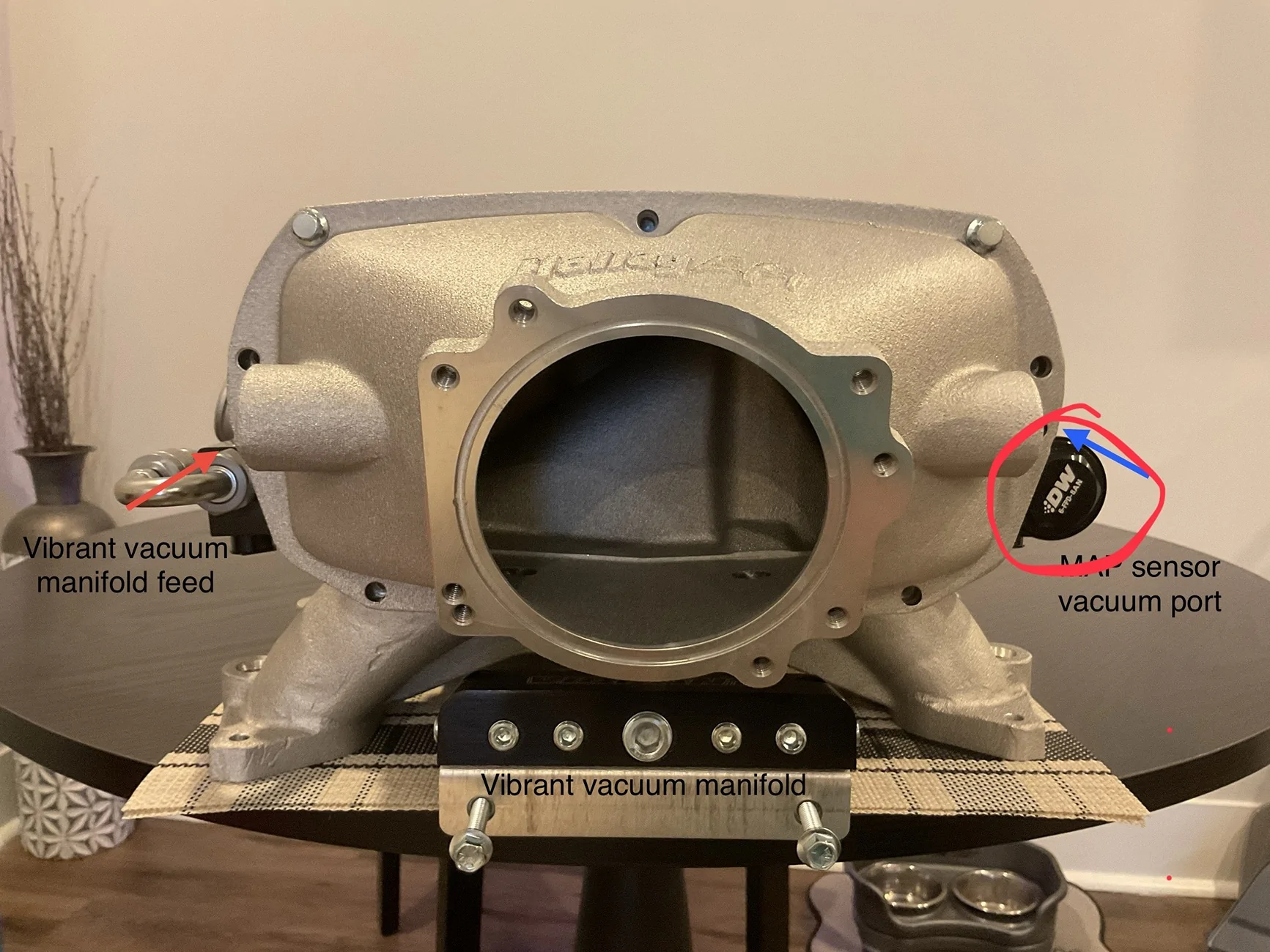

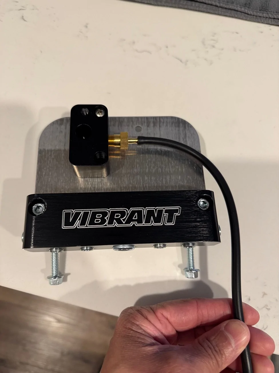

I’m not quite sure how I’ll mount my MAP sensor, but this is what I’m thinking for now. I’ll have to make a hard decision when I get to that bridge though.
Fyi, in case you’re interested, that is a Mike Thomas Fab combination fuel pump and vacuum manifold mounting bracket. It’s designed to fit underneath the intake manifold. If I decide to mount the MAP sensor as shown in my photo, I’ll mount the regulator elsewhere, use one of the existing regulator mounting holes in the bracket and drill a second hole to properly secure it.
