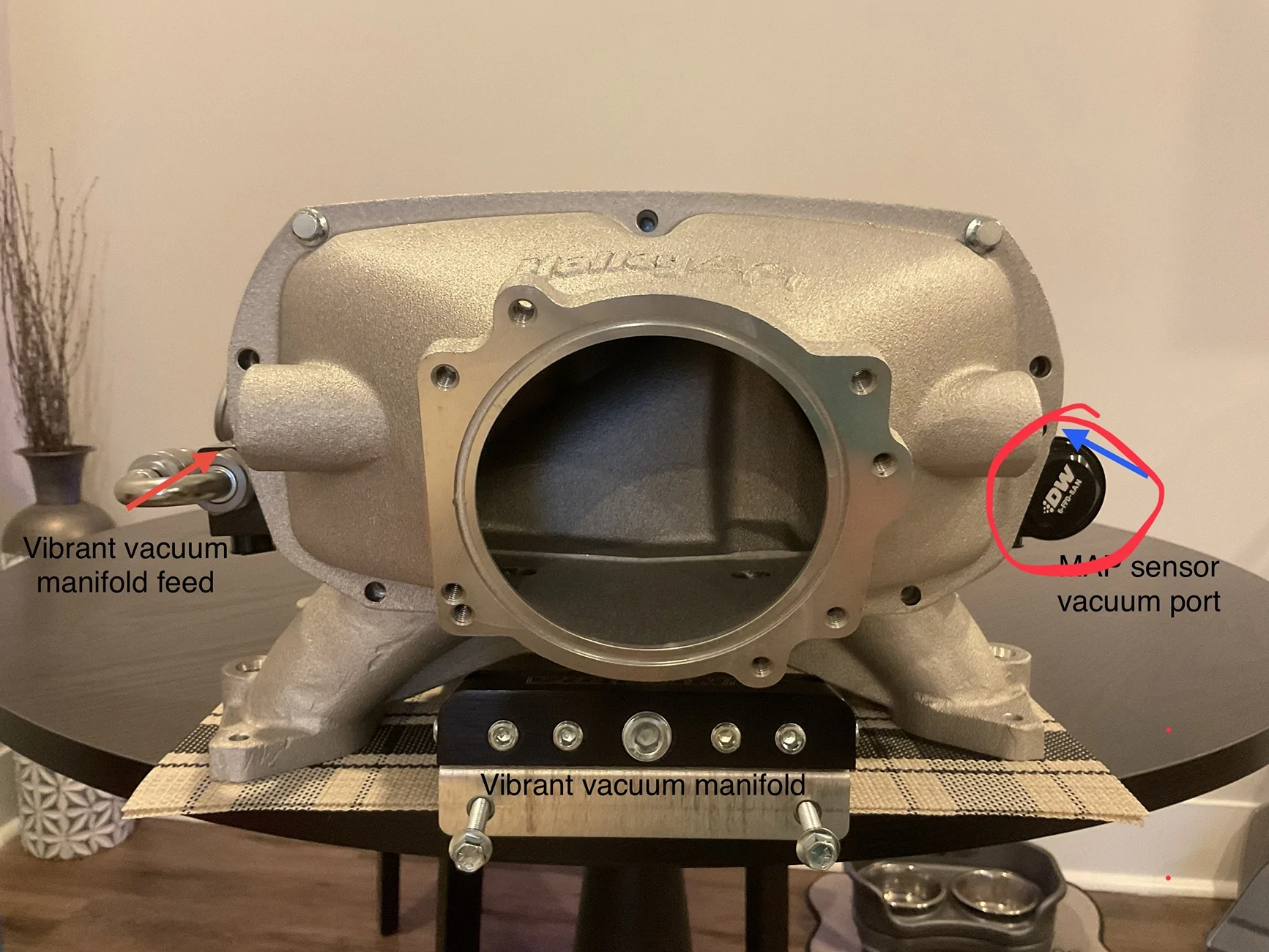

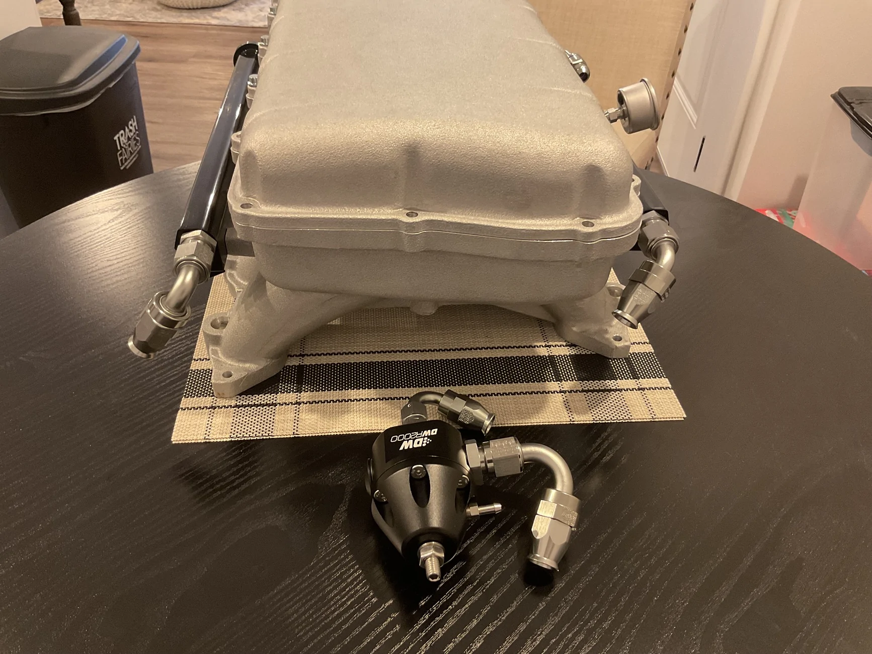

Is your installer going to utilize the SW pulse damper?

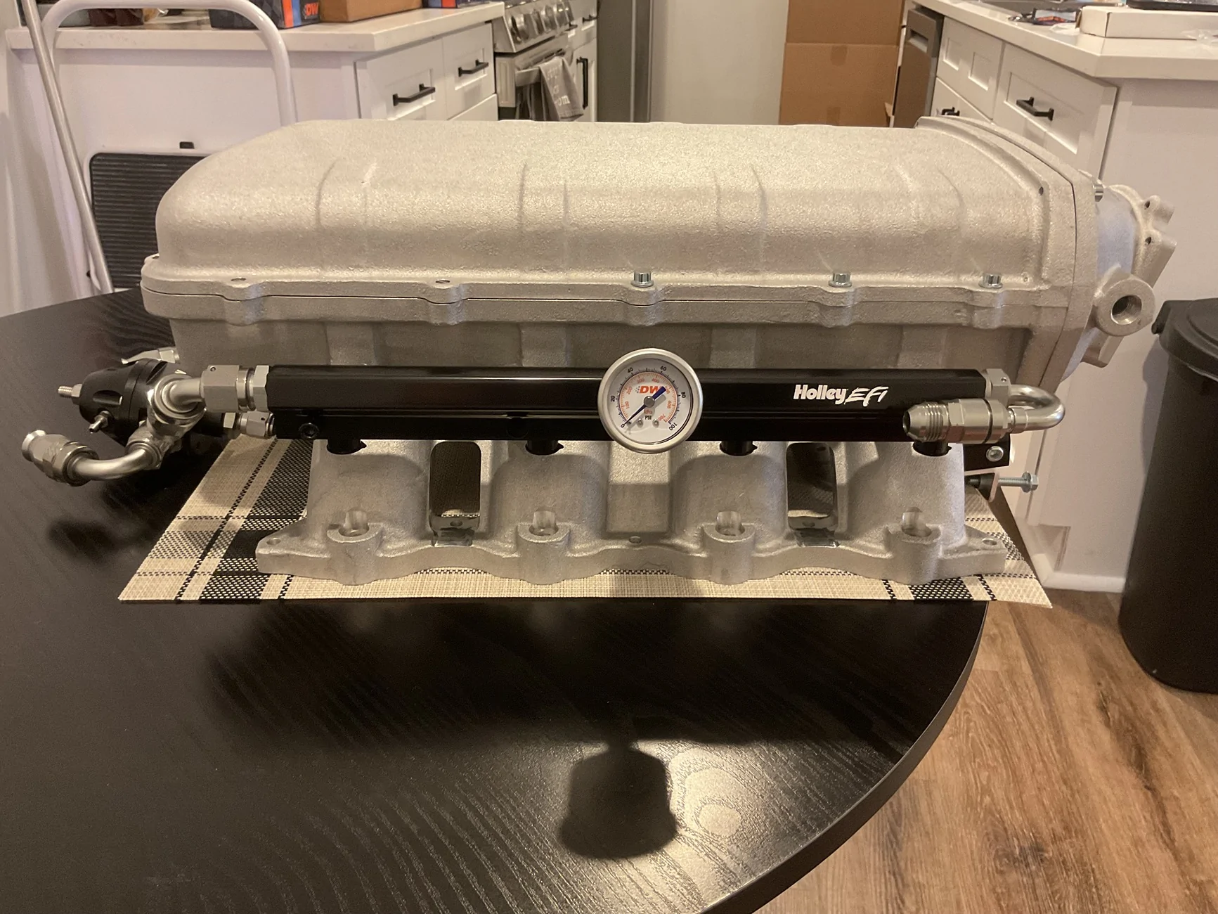

I was messing around trying to see how to go about installing mine in the Holly rails and here’s what I came up with.
It should be the same for the DW rails. I figure, why not try and use it.
Going to try to use it after finishing with the current setup troubleshooting, didn't wanna overwhelm the shop right off the bat haha

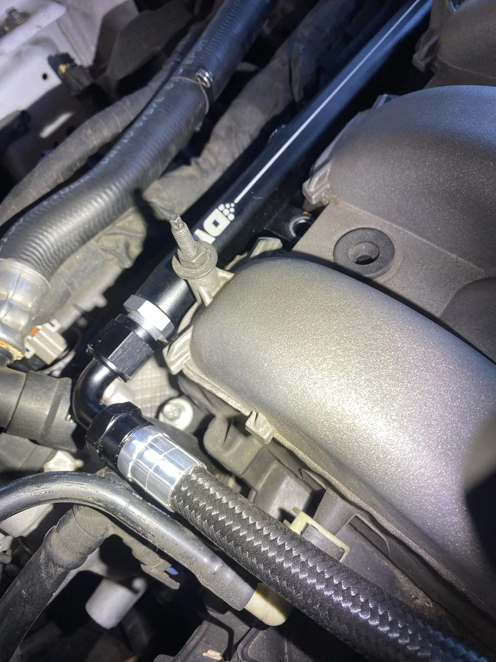

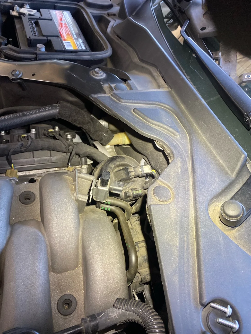

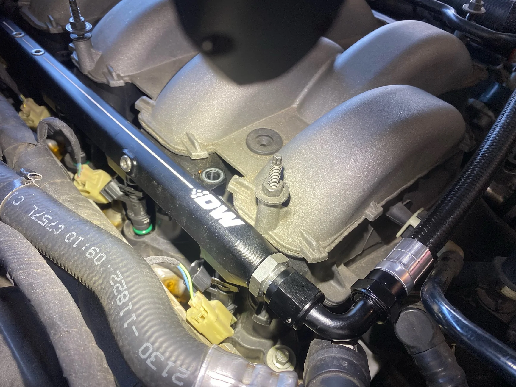

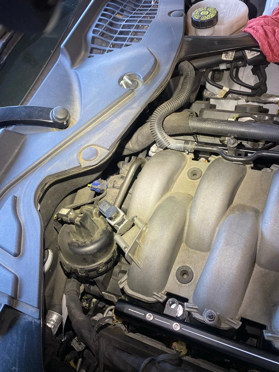

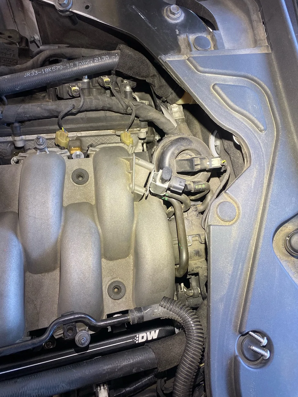

Here are the pictures! Hope your wisdom will help us find the correct path

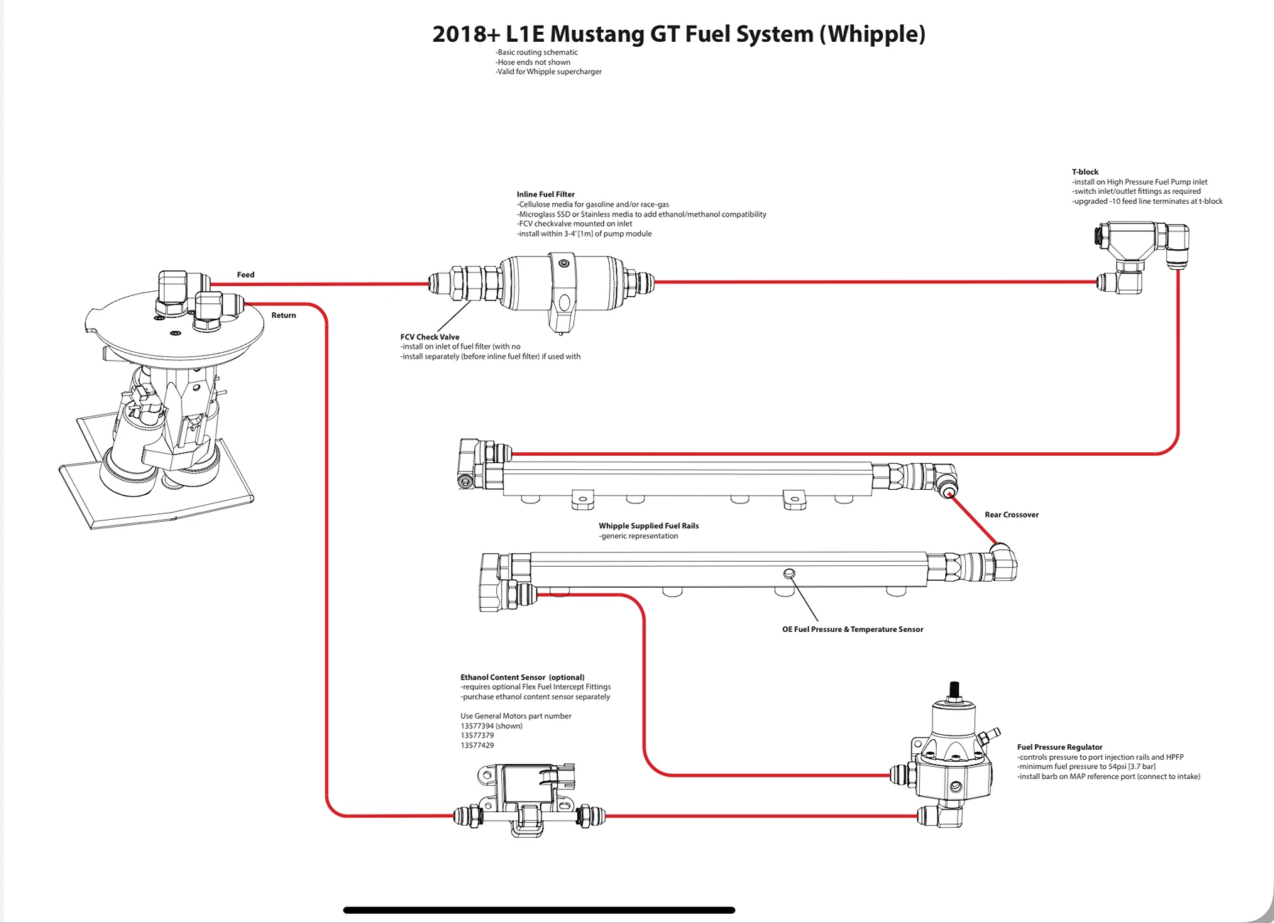

Is the shop just having trouble mounting the rails or something else? I notice the mounting bolts aren’t securing the rails to the IM.
I also see that you guys were able to run the crossover line in front instead of the rear.
Check out this diagram here.
Thank you for the diagram!
If it’s in the front and fully tightened, it’s touching/pressing on those lines/hoses you see on the left, and the shop thinks it is sketchy, borderline dangerous.
DW asked for my shipping info now, maybe they got some additional parts for me that I didn’t receive before.
Gonna keep you posted!
Let me think on this a bit and get back to you with a possible solution. Gotta make a quick run, so give me a couple hours and I’ll get back to you.
They didn’t order anything new yet, everything they have is what I gave them from my initial order from DW.
I meant before if the need arises to get something extra to make it work.
Okay. Another way to create more room in the rear for the crossover line is to delete your IMRCs and install a lockout kit. I have the MMR kit on mine. I had to do some slight modifications on it though. I’ll find the thread on how I did that and post it here shortly.

What’s that used for?
Thanks!
That’s where the Di pump‘s fuel line connects to. Look at the above diagram again. In the top right corner, the open female port on the left of the tee block is where the factory Di line plugs into.
