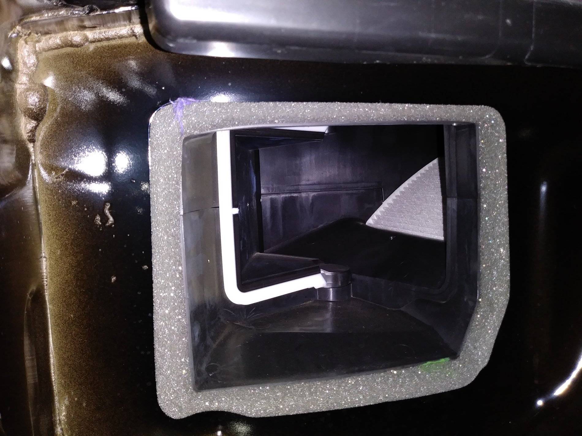

That mouse got into the blower motor because the cabin air filter can be accessed from the engine compartment when the HVAC system is not set to "Recalculation" mode. When it's set to recalculation mode, a door closes over the cabin filter access hole, which would not allow a mouse to access the filter.
Are you sure the HVAC door stays open when ignition if off (and not if recirc)? It'd be great :D. On my 2018 F-150, that door is ALWAYS closed unless you turn HVAC on, AND de-select recirc. I don't like that, since you ALWAYS have to turn the system on to have any airflow. With cars that allow fresh air with HVAC off (in 'fresh', of course), I don't need to turn it on most of the winter. Hope the Mustang is that way, and if the above statement is correct, it should :). Need to check it out.
When I took my battery box out of my GT, I know the HVAC was not in "Recirc". I could see the cabin air filter through the intake on the firewall - photo below. You can see the door (with the white seal) that allows air into the filter is open. That's probably how that mouse got in there on the OP's car. All he had to do is chew through the filter and he's inside the blower, etc.
I did not test to see if the door was closed in the HVAC was in "Recirc", but I'll bet it is. Why would the door move and open up if it was already closed at car shutoff.
