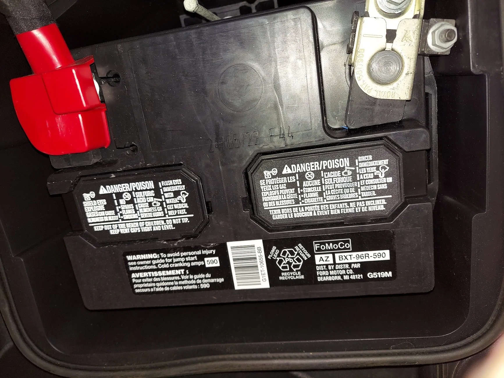

What is the brand, Cold Crank Amperage rating and age of the current battery? The stock battery is rated at 590 CCA, so what's there now should be at least that. If any less, I'd replace it.
Attached is a photo. If there is an existing Motorcaft battery in the car, look to some raised numbers in-between the fill caps; those will list the date the battery was made. If there is another brand in the car, try to see how old it is. Batteries wear out, no matter how well maintained. Anything past three years is suspect. Anything older than five, I recommend replacing immediately.
The stock battery is a Flooded Lead Acid type. If looking for a replacement, I recommend another FLA. Keep it stock. Keep it simple.
If the battery is replaced, perform a Battery Management System reset. It's simple and takes only moments.

If the existing battery is younger than five years and rated at 590 CCA or higher, charge it fully. Then perform a load test. It should pass. Parts stores can do a test. If you need to fully charge the battery, you might need to take it to a mechanic and have them charge it overnight.
