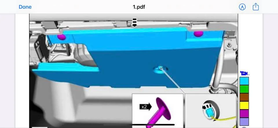

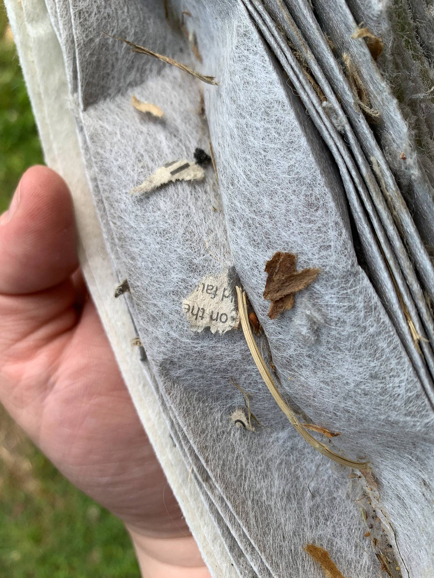

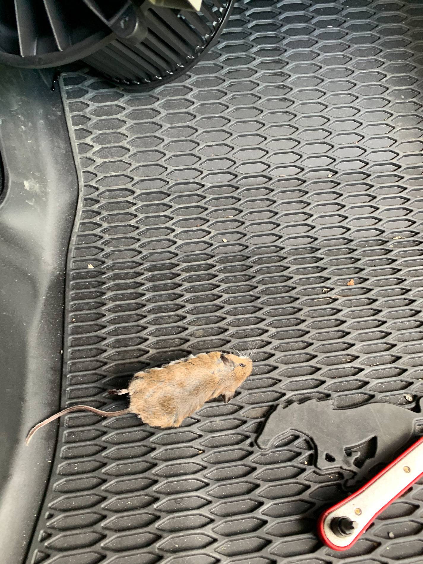

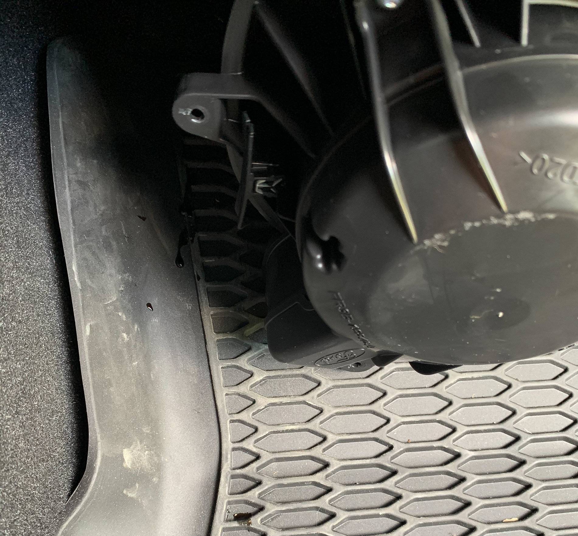

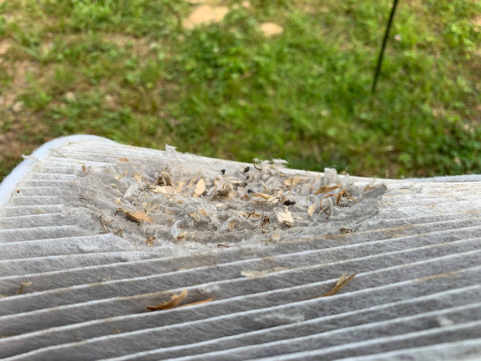

So last night I bought a service manual online and we worked to drop the blower motor. Inside, dead mouse and mouse blood. I've owned my Mustang about 45 days now and it looks like this guy has set up house in the vent system for quite a while. My car is a 2019 and came off the showroom floor. Inside the cabin air filter area where he had made a bed there were multiple shreds of old newspaper of which we have none, and we live near no one else. Additionally, the Lower Insulator panel that's supposed to be underneath the blower motor and HVAC equipment is missing. I'm wondering if this guy has been living there the whole time?

If anyone else has a 2019 Mustang GT or Bullitt, could you check to see if you have the lower insulator panel in your car?

Just checked my 2019 Bullitt for you, and the blower motor is completely exposed, so guess no insulator there. I'm surprised it's not better integrated, but it's a Ford. Ha ha. Is that what you needed?

Yessir, that's exactly what I was wondering. Thank you so much!

My pleasure. Hey, if you buy that insulator piece for under the blower, let me know if it fits as intended. I'd like to buy it too. Looks like one of the typical Ford cost-cutting measures. It might cut fan noise too. Good luck with the fix.
