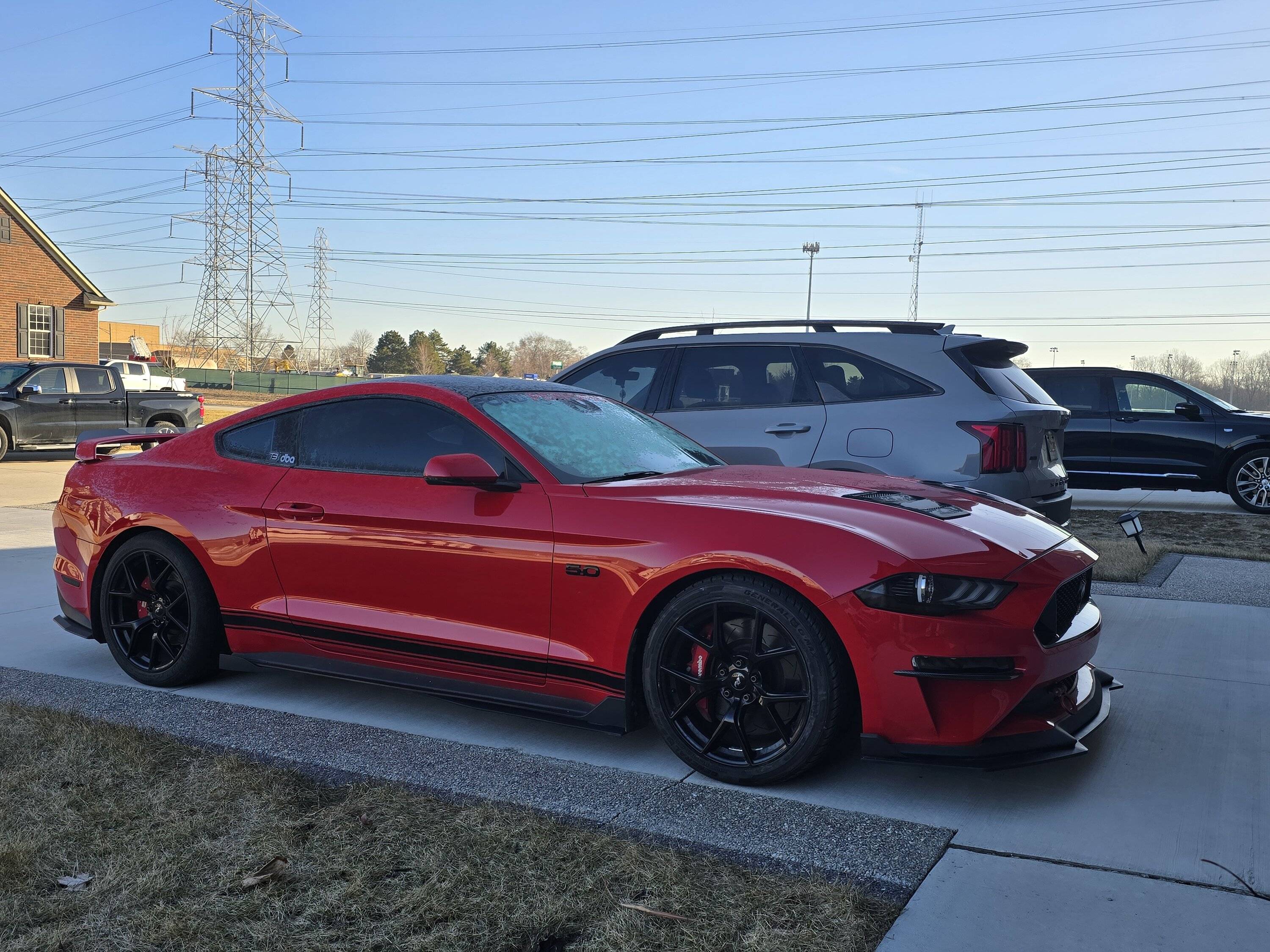

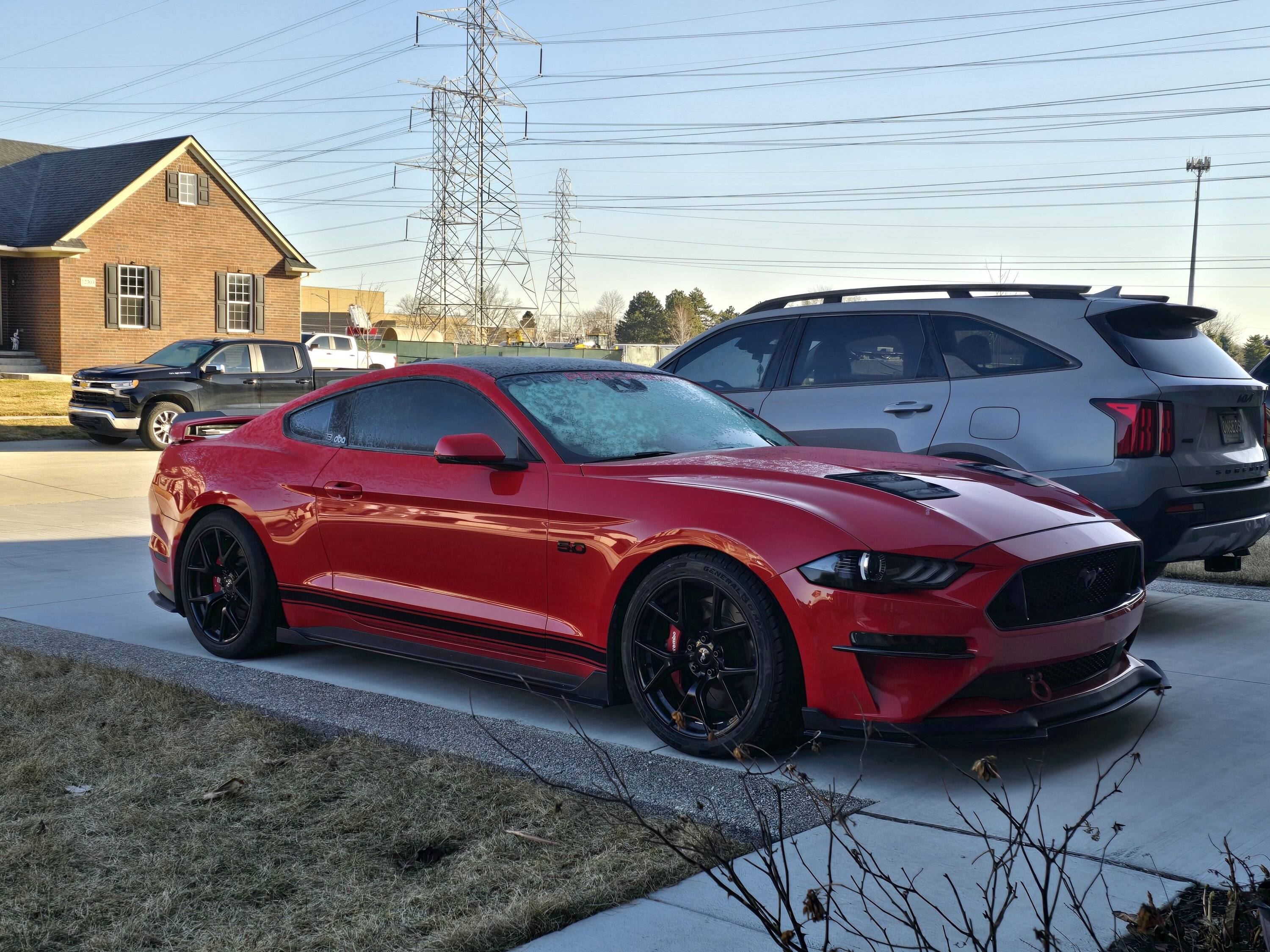

So I don't love the bulge but I do like the overall stance of 285/35 and the summer tire selection it comes with. I did consider going 275/40 square but I ended up settling on 285. My long term plan is to move to 19x10 and go with even lighter rims later on but I'm waiting on a house so I don't have to do tire hotel any longer lol. I might go 275/40 on the next set though just to see just because extra sidewall in the midwest never hurts (looks at the nearest pothole).
Should also preface that this is my first ever time running a summer and winter setup my prior car to the mustangs I owned was a 2014 elantra with all seasons. So these tires were my first big car purchase (and very well spent with both my eco that I had and now my gt).
Thanks for the nice reply. I put 275/35s on 19×9.5 inch rims on my DMG GT/CS and the gap is too much. I'm probably going to do Steeda min drop springs with B6 dampers and then consider the 275/40s if the gap is still too much. You’ve got a gorgeous car!
(BTW, I'm in MI too.)

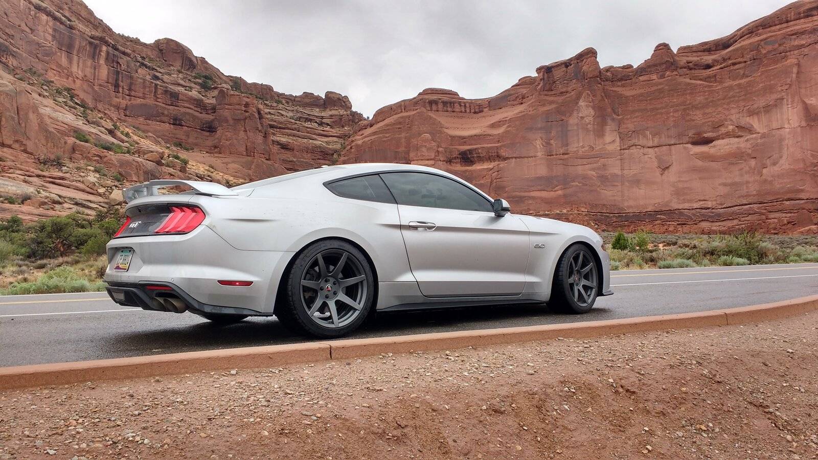

I wish this site was posted as a sticky to help people out with tire sizes: https://tiresize.com/comparison/
It is not going to be 100% accurate as tire manufactures are all different, but gives a close representation of what will happen when changing tire sizes from stock.
Going from the stock PP1 setup to the one in my sig, the difference was very small which barely affected the speedo, ie: -1mph at 90mph. Basically keeping the same sidewall, but a little over an inch wider. I went with Project 6GR wheels which lightened up each corner, too, over stock. Car is lowered, too.
Great looking set up! Love the back drop in the pic! Thanks for sharing.

This looks great! what is your setup and Instagram to tag you?

no spacers needed, they should fit perfectly. I run 285/35/19 square on my daily driver
Are you running magneride? Bc I keep seeing people say that with a wider tire it won’t clear the struts with a wider tire in the front
krishelnino
Apr 6, 2016
87
1,136
640
Detroit, MI
Krishna
2018 GT Premium MT82 Race Red
No magneride. I'm running BMR SP083R springs with FP Track handling shocks.
With 285/35/19 square setup I run a 5mm spacer at the front
With 305/30/19 square setup, I use a 26mm spacer
