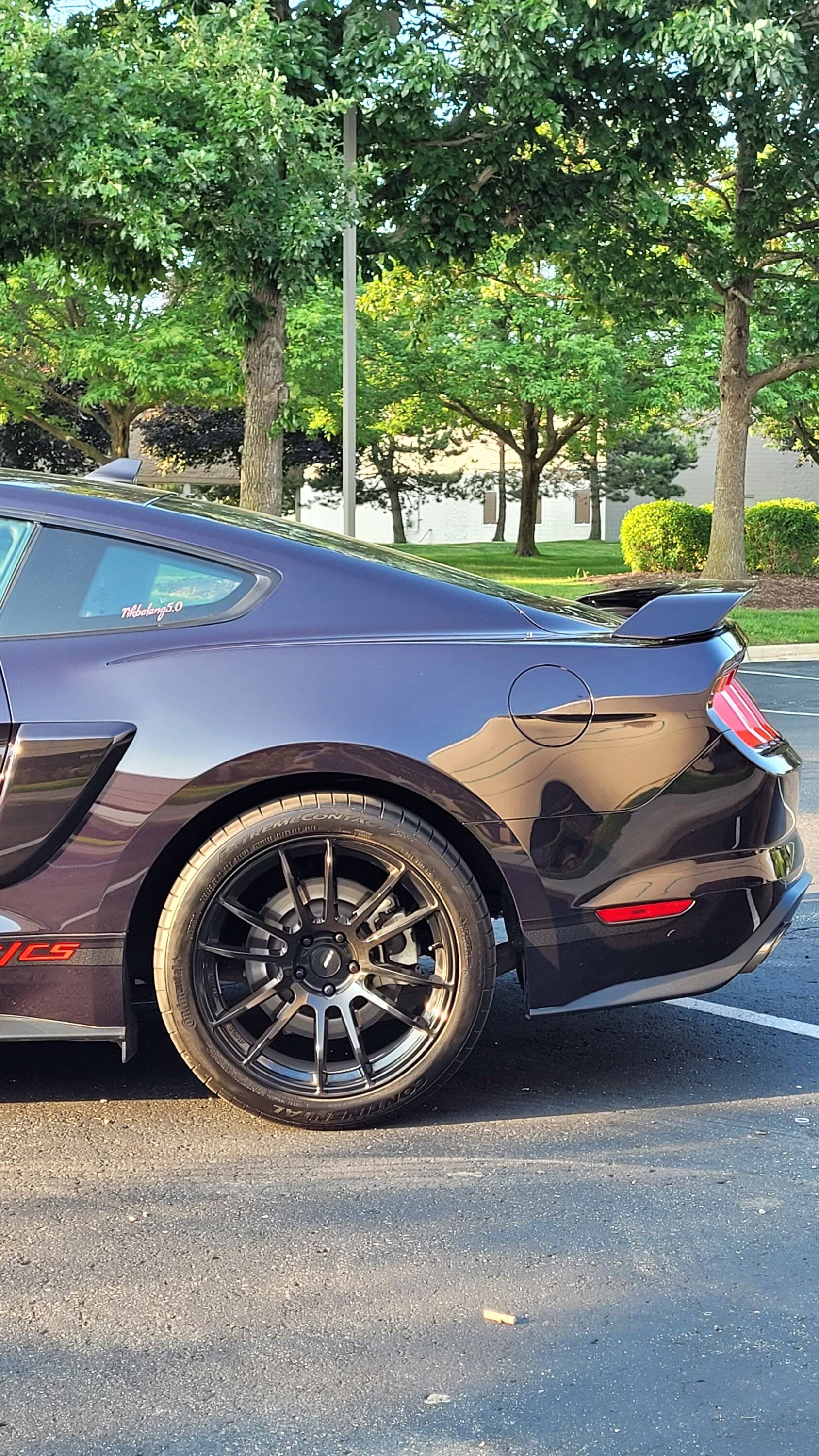

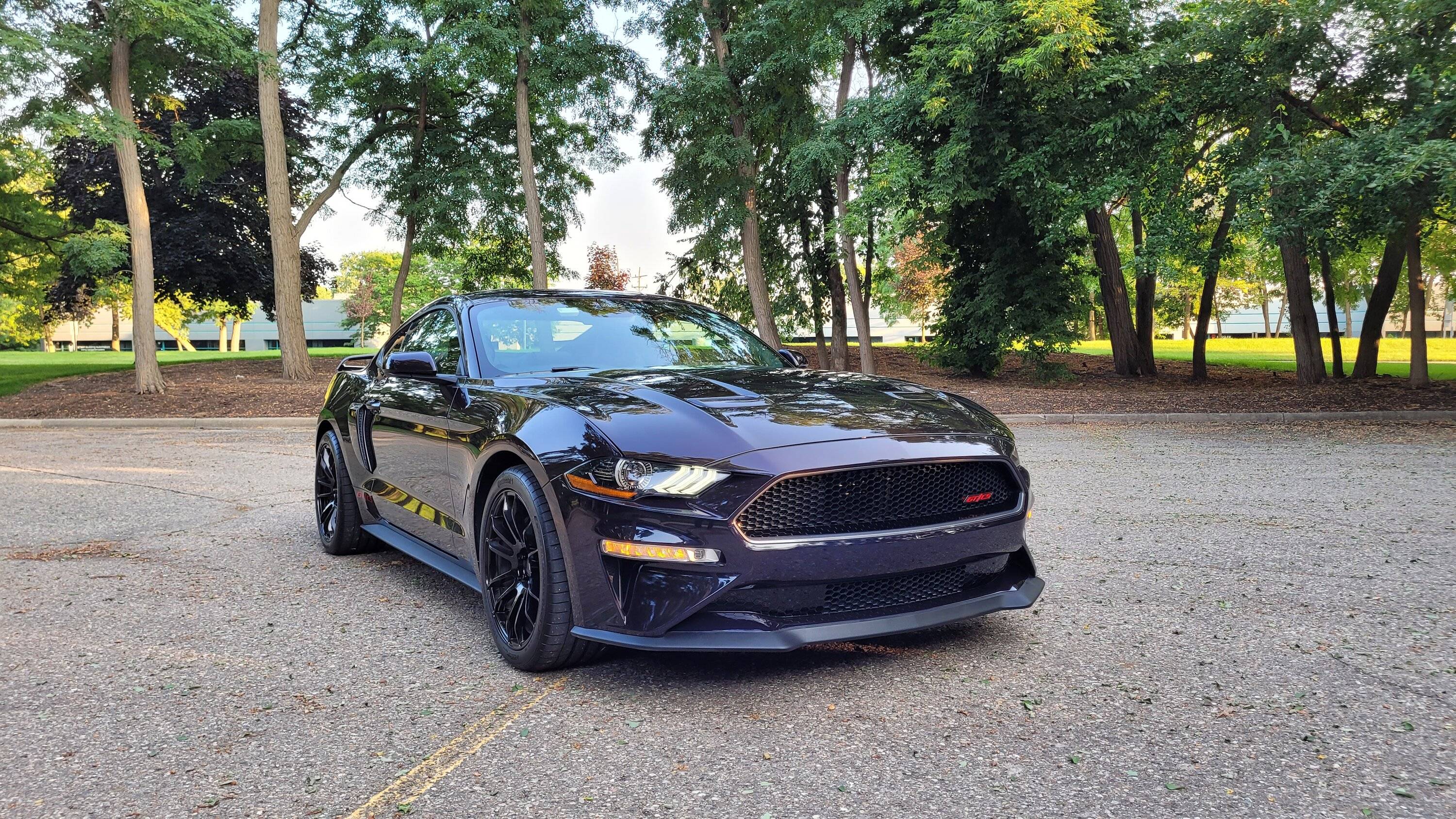

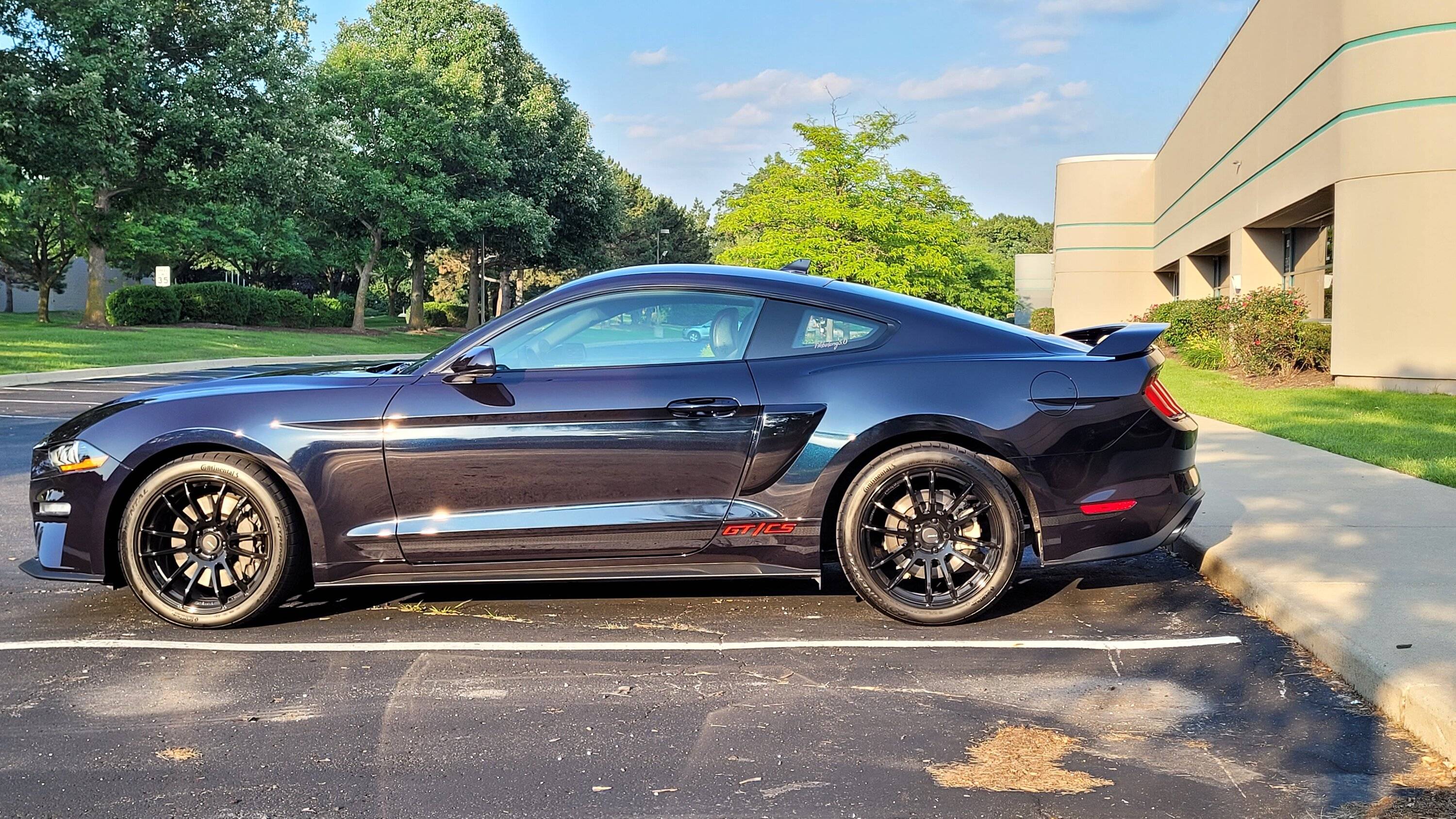

Just to make your life harder here are some pics of mine (19x9.5 w/ 285/35 square)
Nice photos. I'm interested in your opinion of tire bulge with 285s on a 19.5 inch rim. It looks like the sidewall is bulging pretty well. Have you ever tried a 275/40 on the 9.5 inch rims?
RedTetsu13
Nov 23, 2020
241
325
MI
Stephen
2023 Mustang GT California Special
So I don't love the bulge but I do like the overall stance of 285/35 and the summer tire selection it comes with. I did consider going 275/40 square but I ended up settling on 285. My long term plan is to move to 19x10 and go with even lighter rims later on but I'm waiting on a house so I don't have to do tire hotel any longer lol. I might go 275/40 on the next set though just to see just because extra sidewall in the midwest never hurts (looks at the nearest pothole).
Should also preface that this is my first ever time running a summer and winter setup my prior car to the mustangs I owned was a 2014 elantra with all seasons. So these tires were my first big car purchase (and very well spent with both my eco that I had and now my gt).
