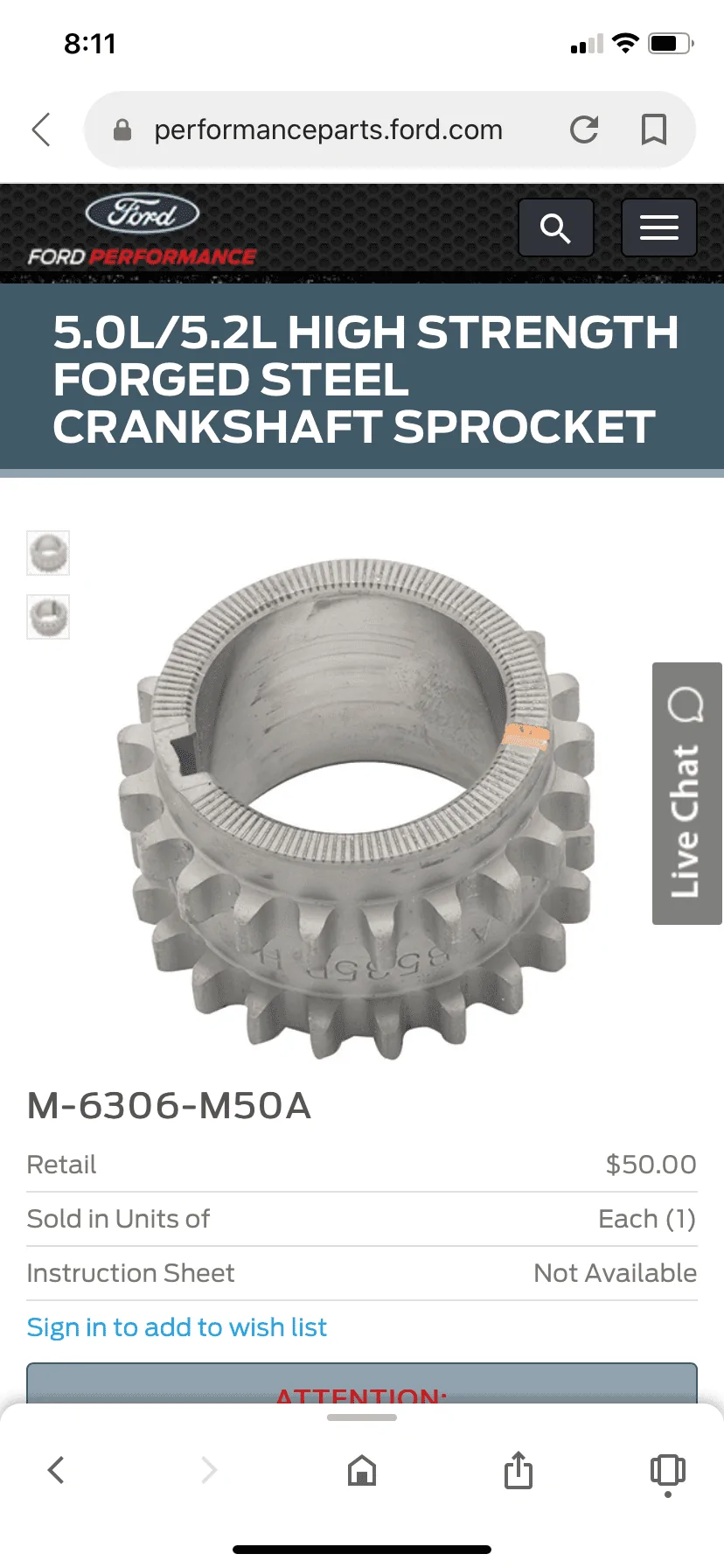

Did you do the crank sprocket also?
TGGT
TGGT
Jul 29, 2018
64
915
377
SoCal
2018 mustang gt
no. after talking with my tuner and him talking to another tuner, who’s big in the coyote scene, it was confirmed that ford Motorsport crank gear is standard equipment on 18&up

Ah man, that's a shame. You were right there.
I’m sure a billet one is stronger than the factory forged piece. That being said I won’t be stressing out on the crank gear every time I make a pull the way I would have with the factory opg’s.

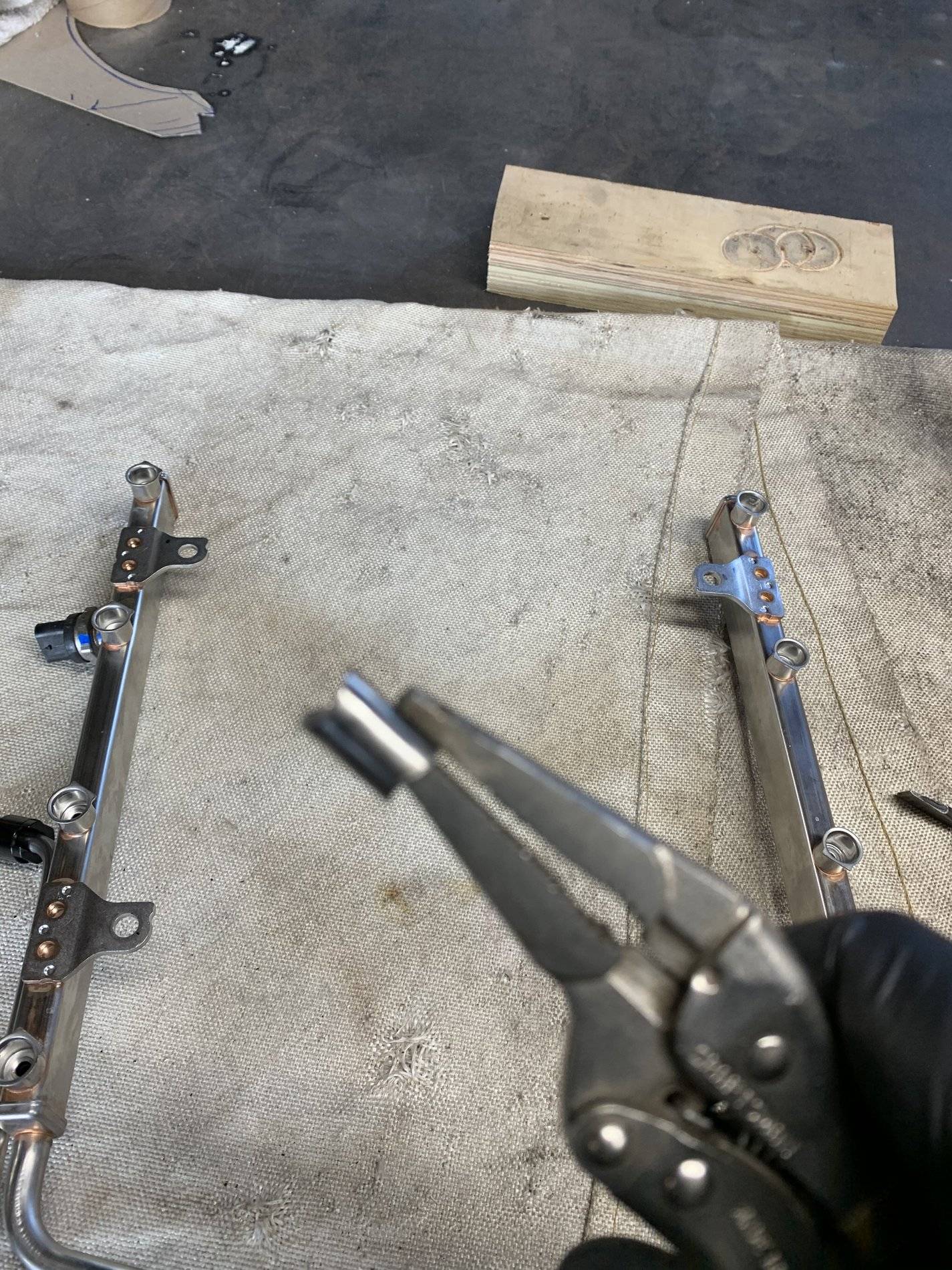

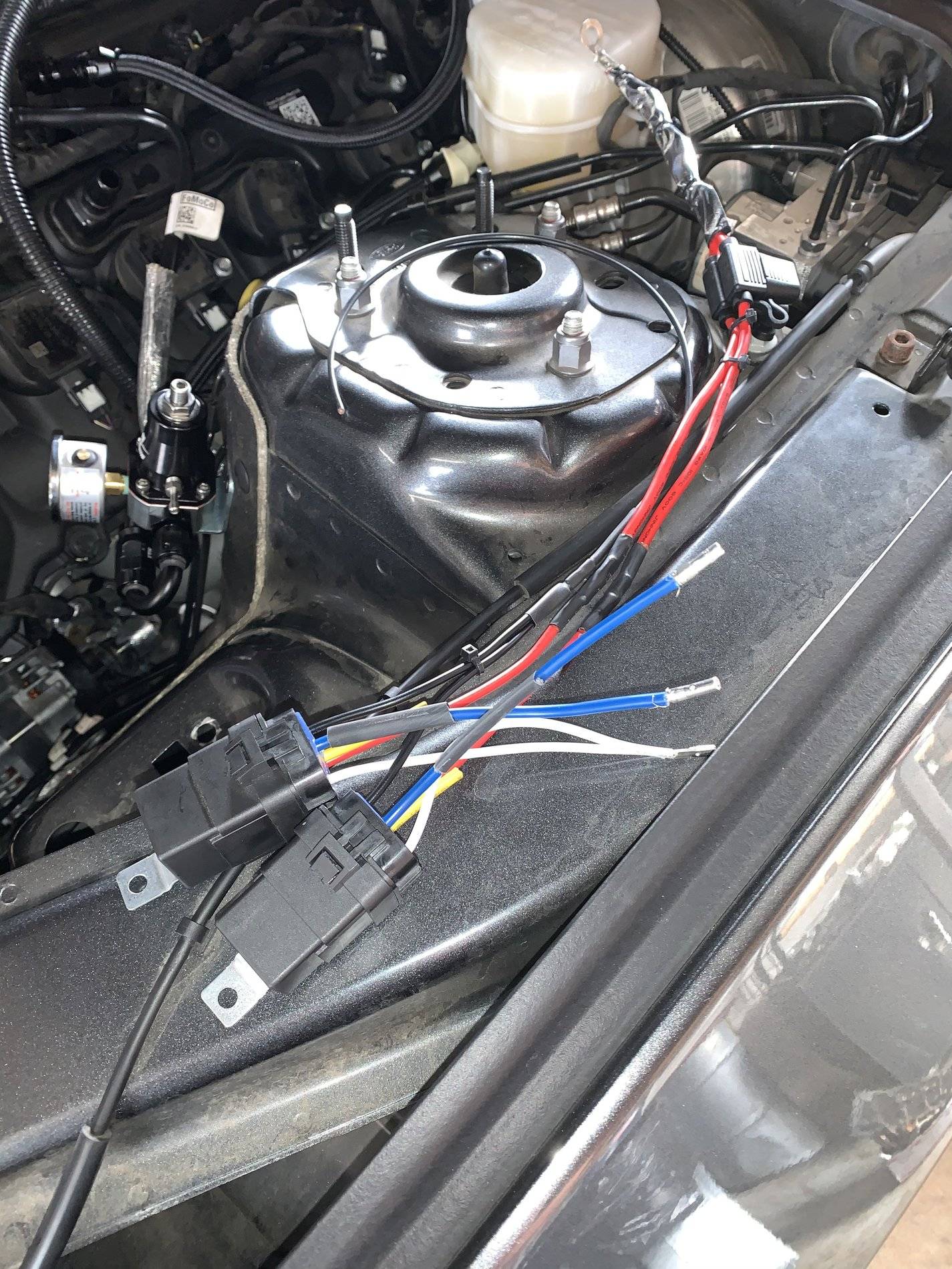

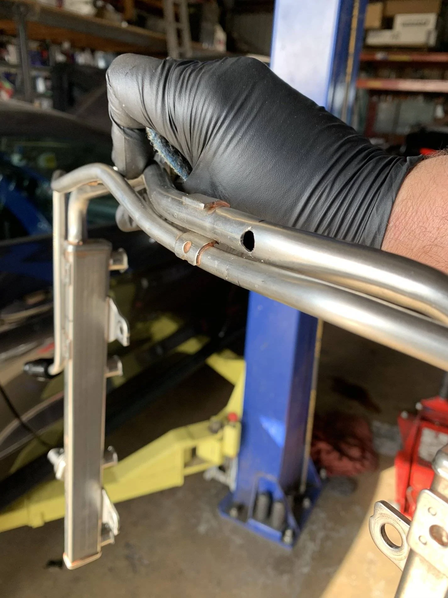

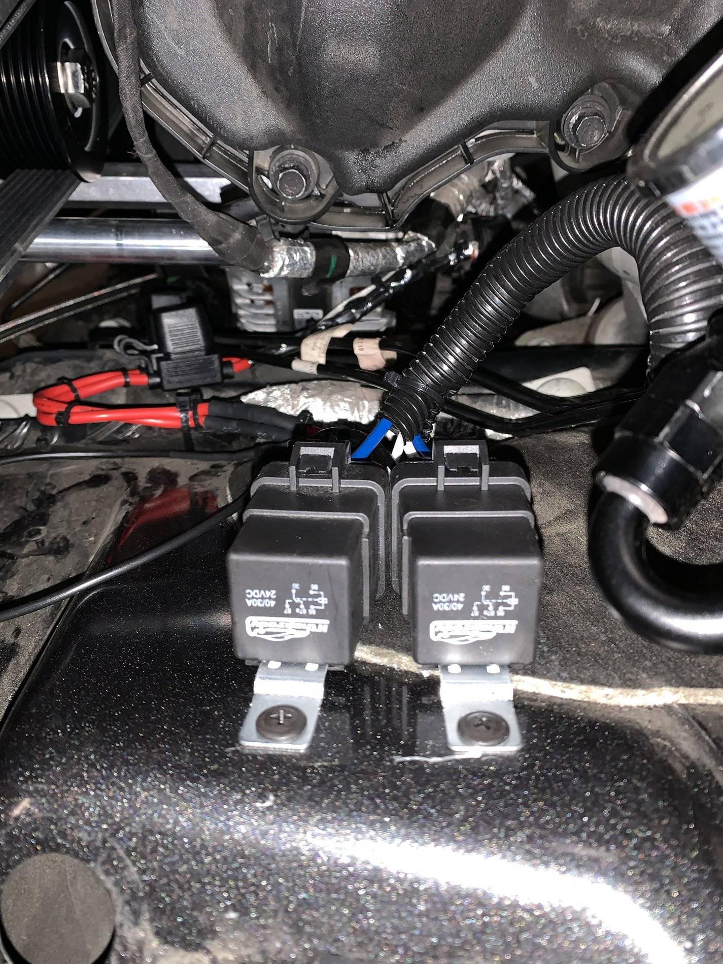

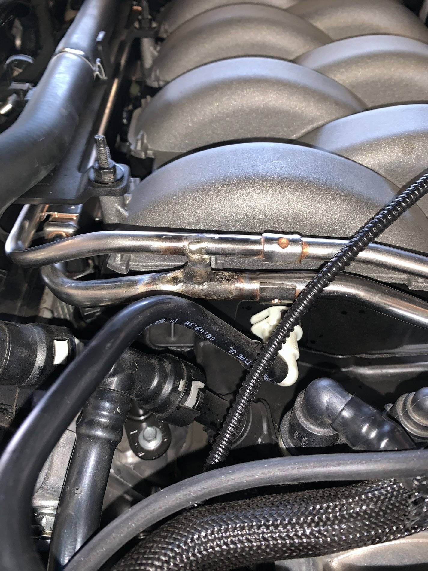

Got the fuel system finished up today and now I’m just waiting for a tune. I ended up building my own harness which was a little bit of a hassle, but it’s done now. Probably the hardest part was modifying the stock rail. Drilling into tubing is challenging enough, but then I decided to silver solder it which I had never done before, but managed to figure it out. It doesn’t look pretty, but there’s no leaks.
