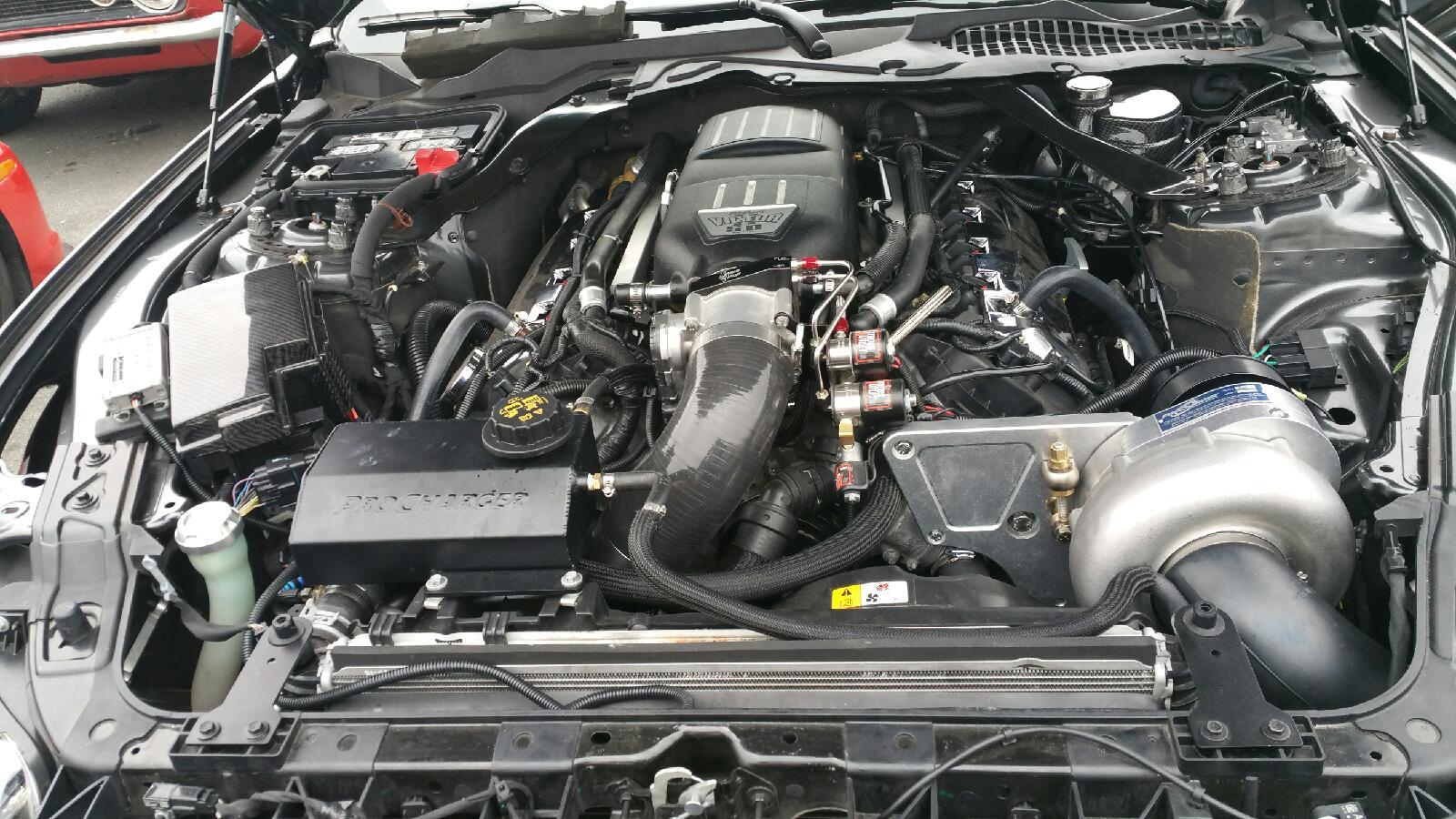

If you loosen the allens on the head unit you can reclock the snail to allow for more space between the unit and the fan shroud, I found this out after I trimmed out a bit of my fan shroud as well to get the discharge pipe on.
I am not familiar with the Hard plastic Inlet/Intake pipe, but If you are waiting on the MAK power pipe I wouldnt do too much trimming until the you have the intake you plan on keeping.
