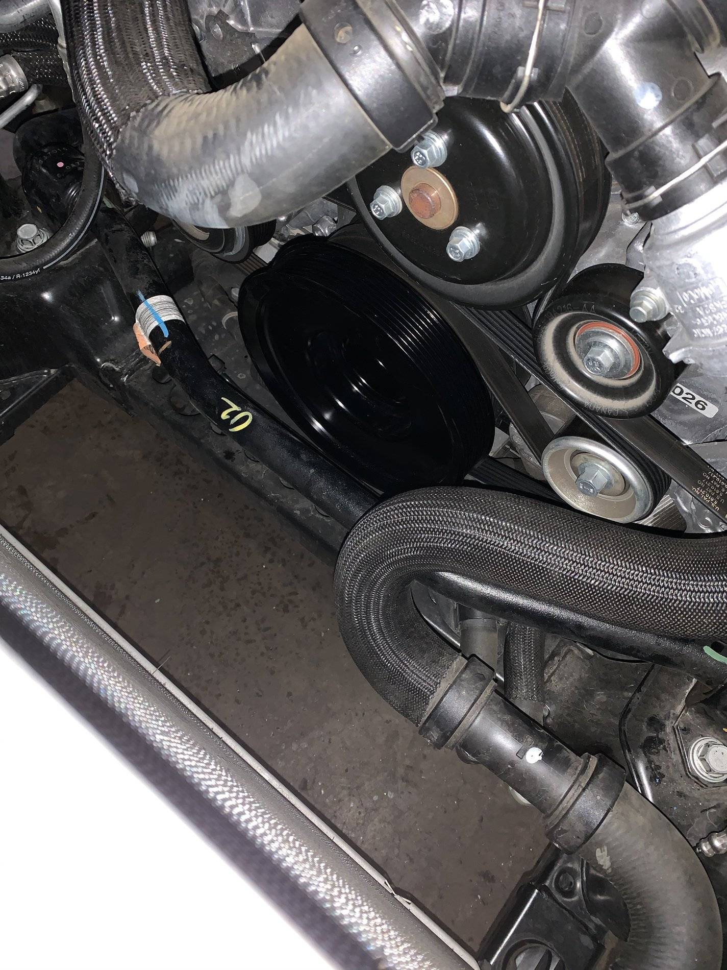

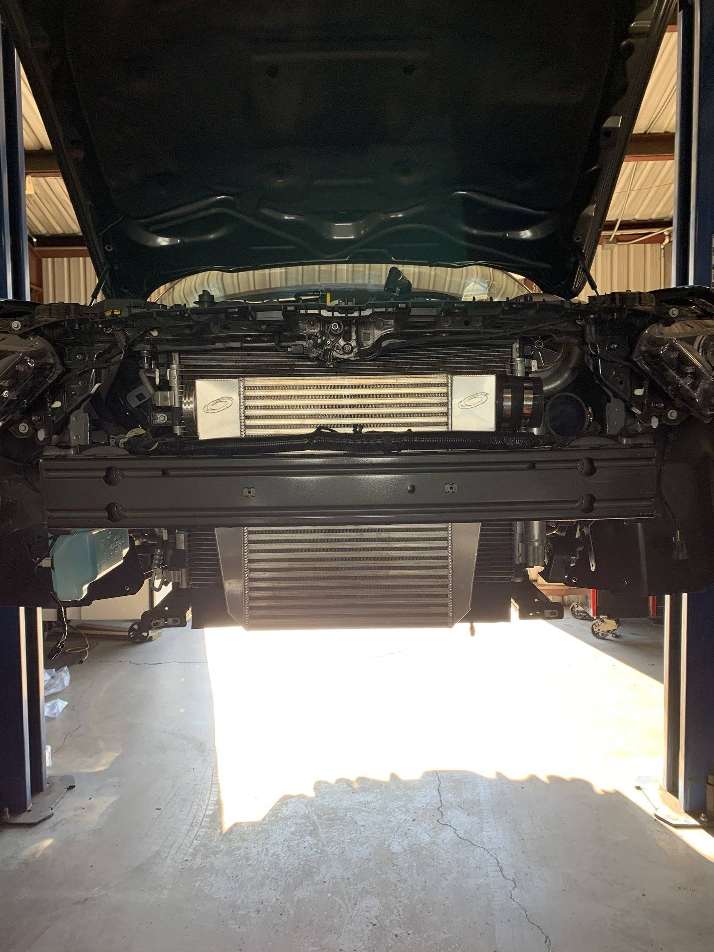

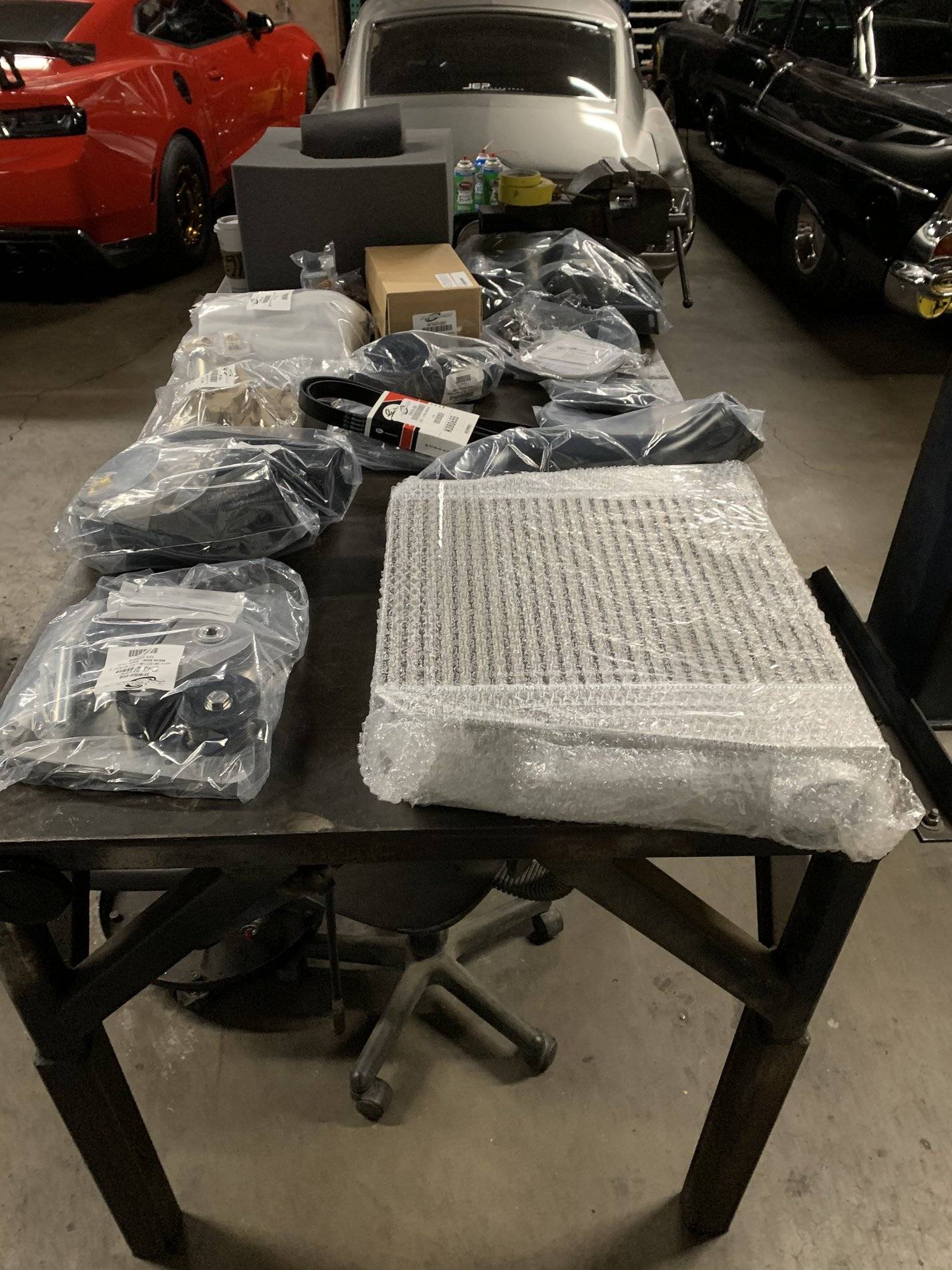

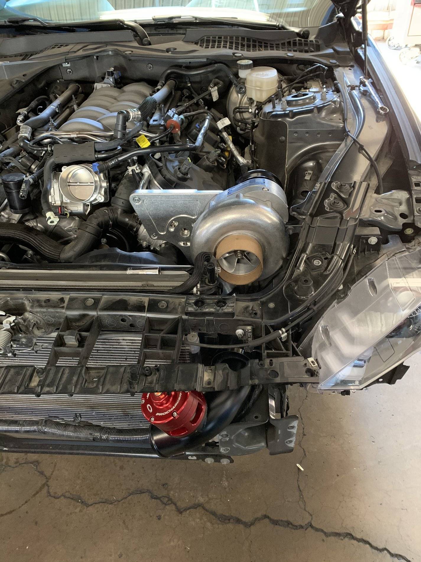

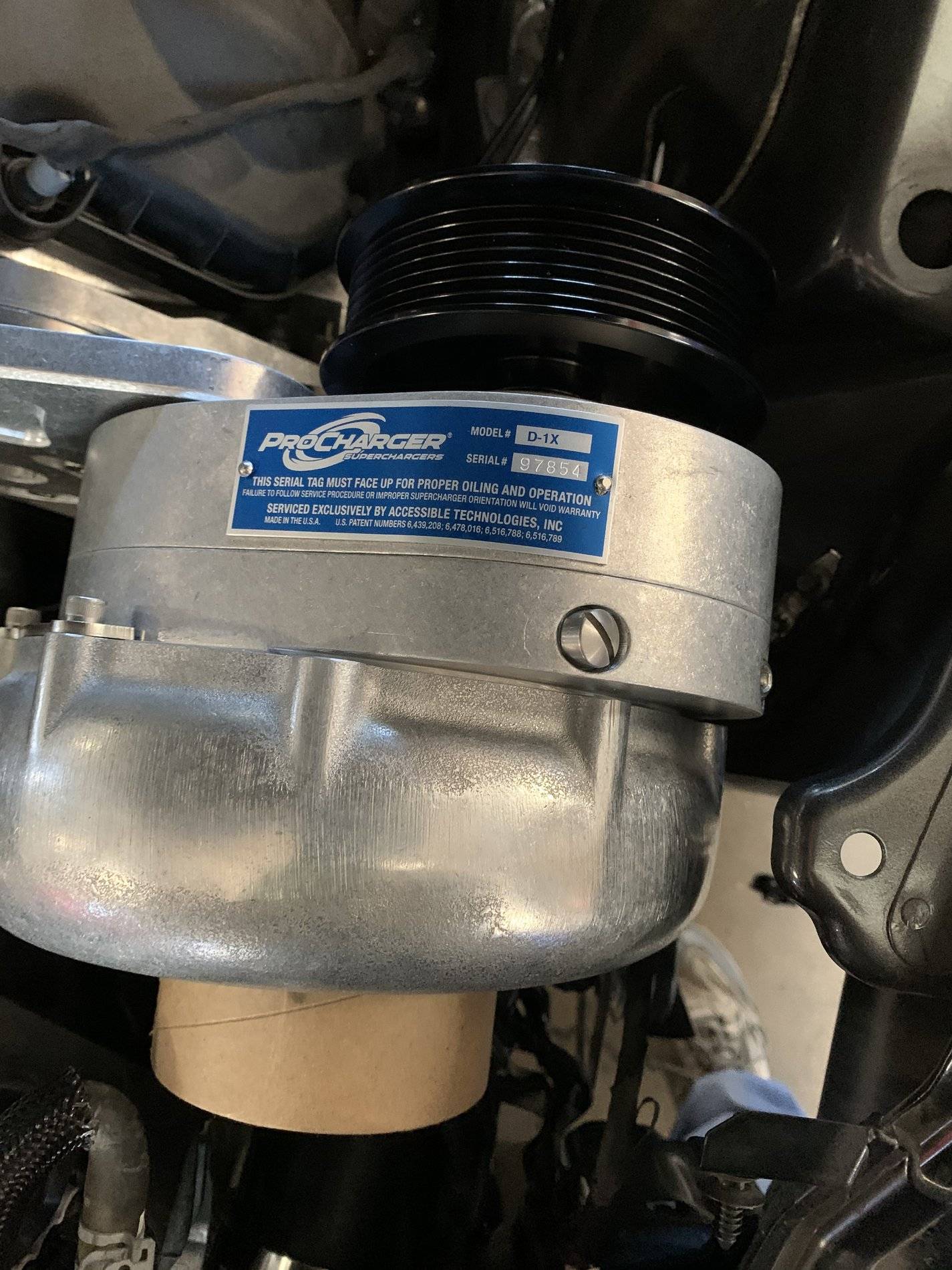

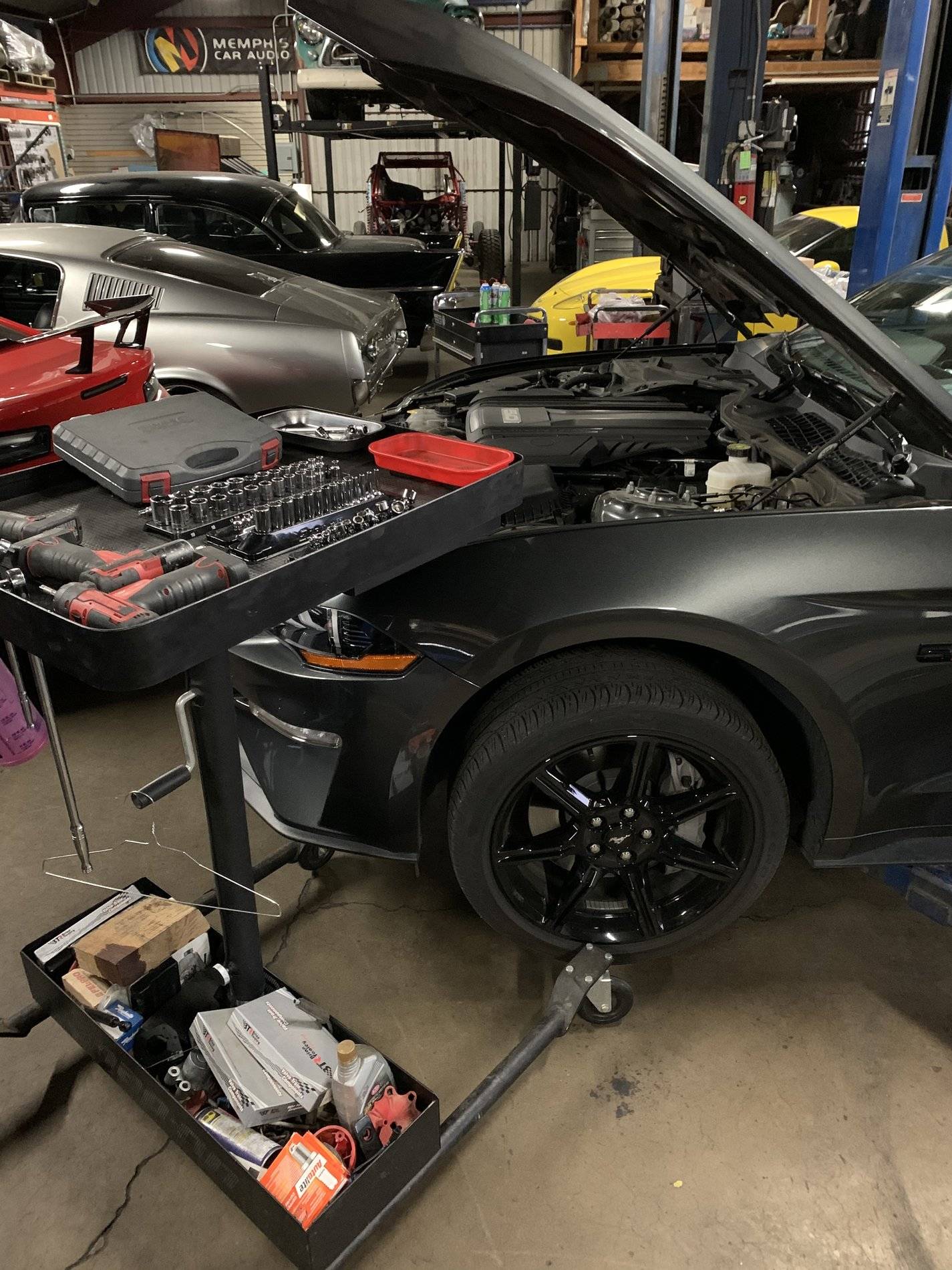

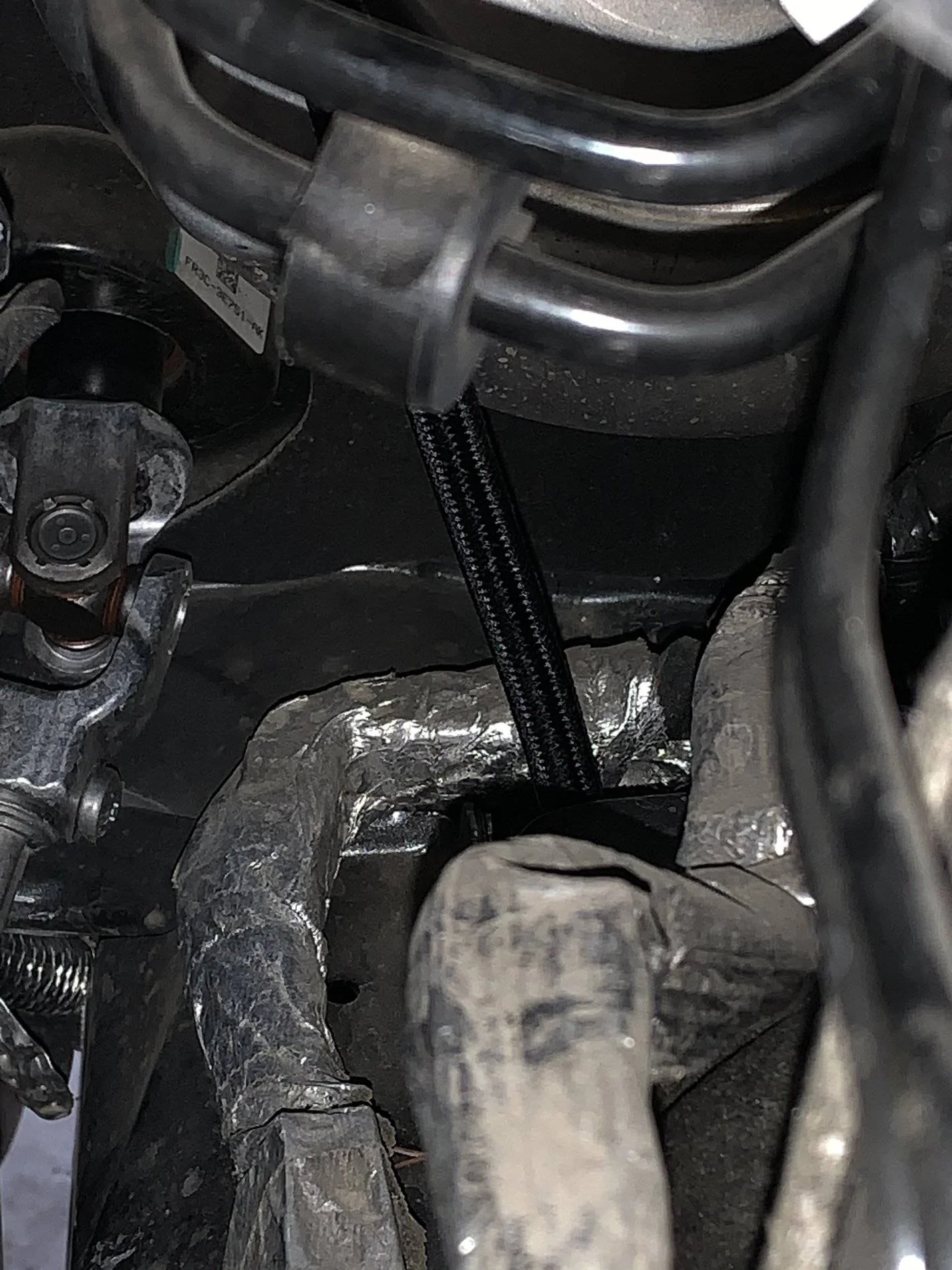

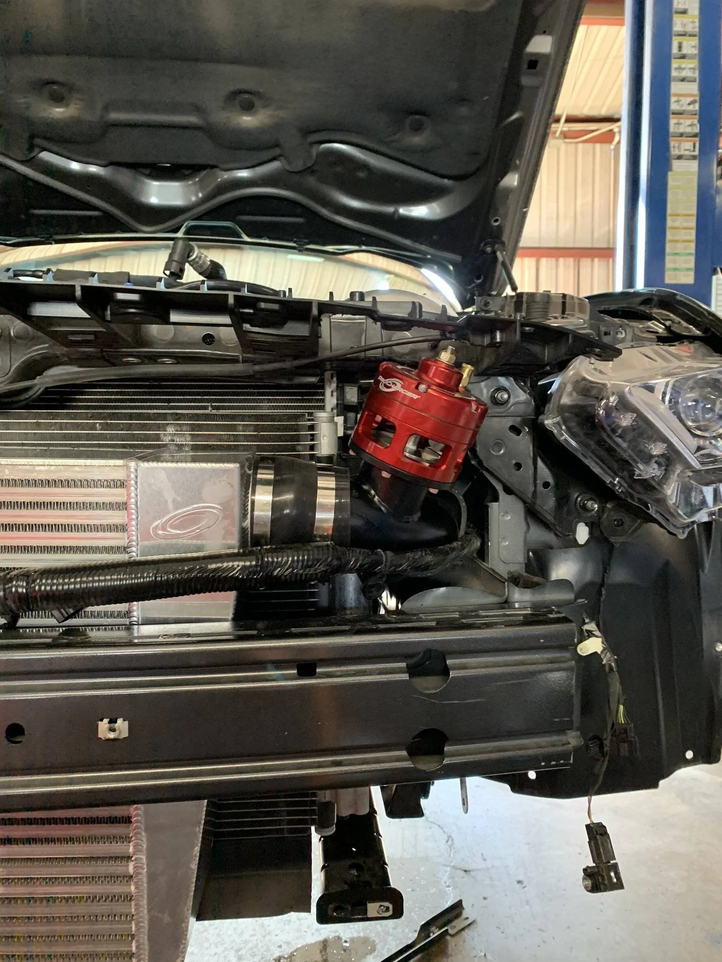

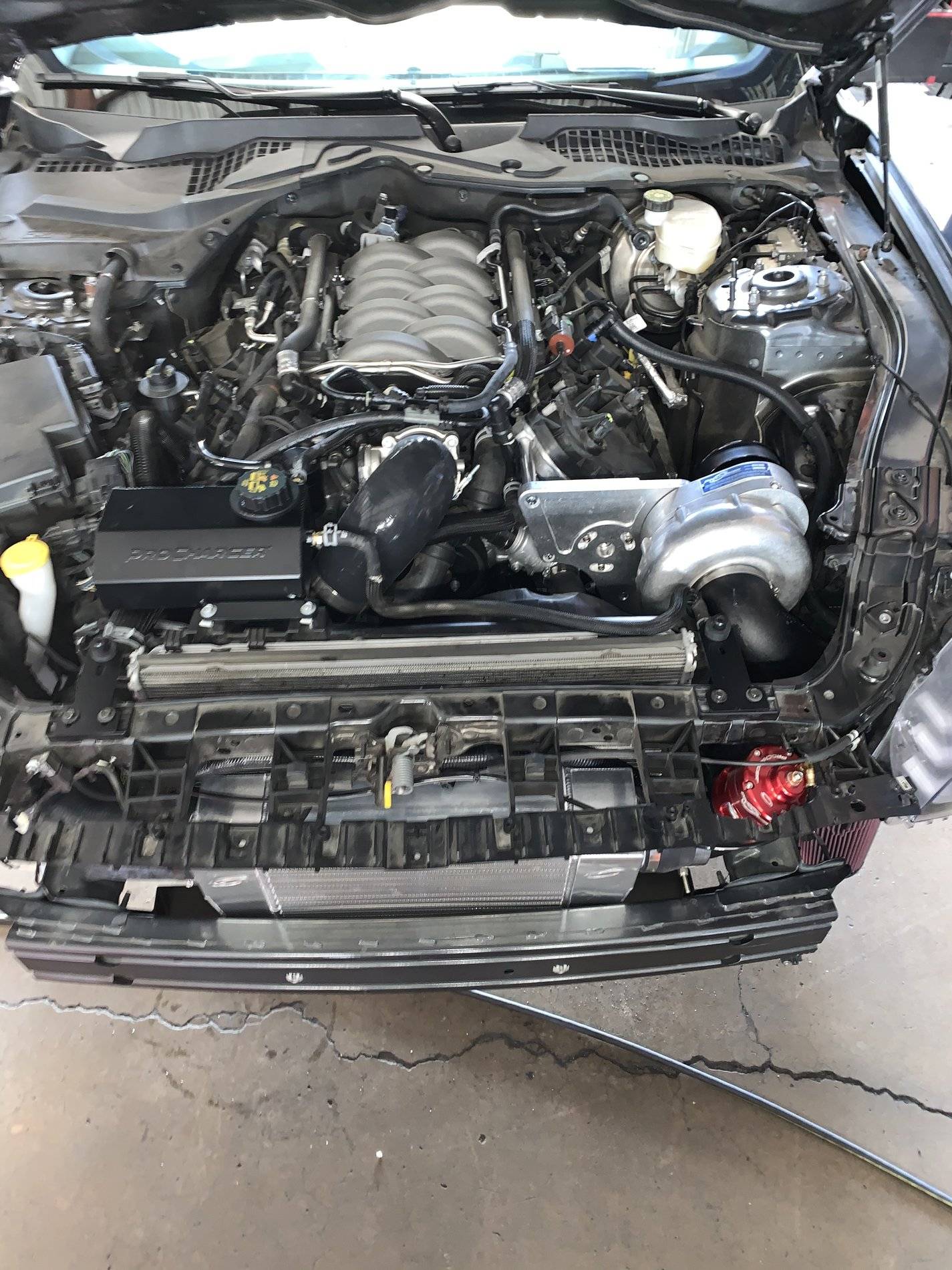

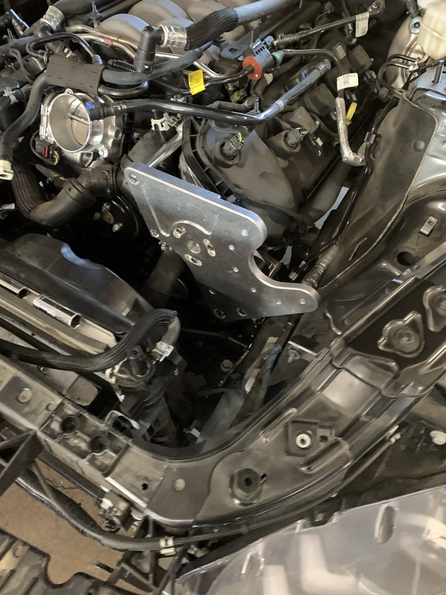

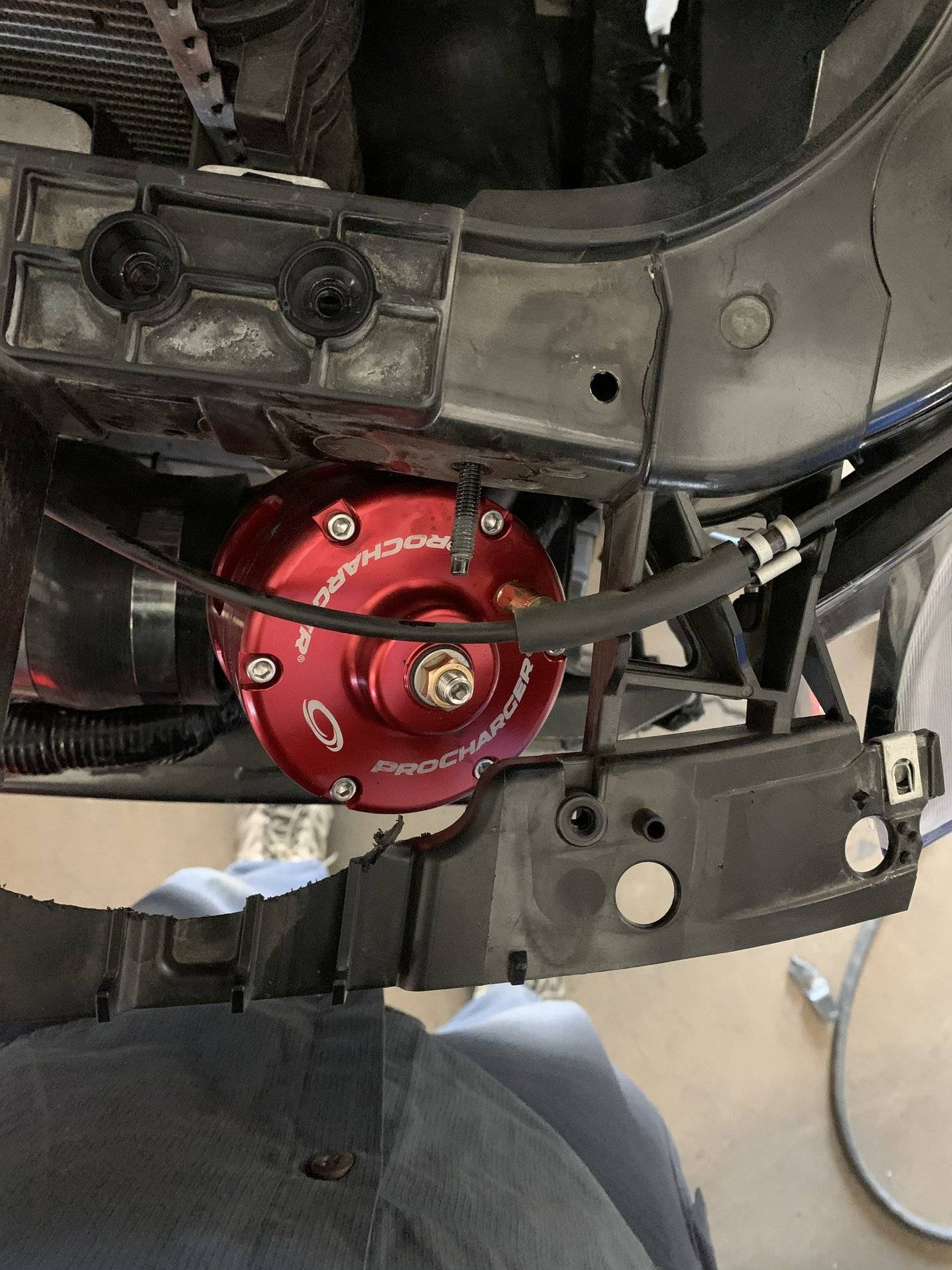

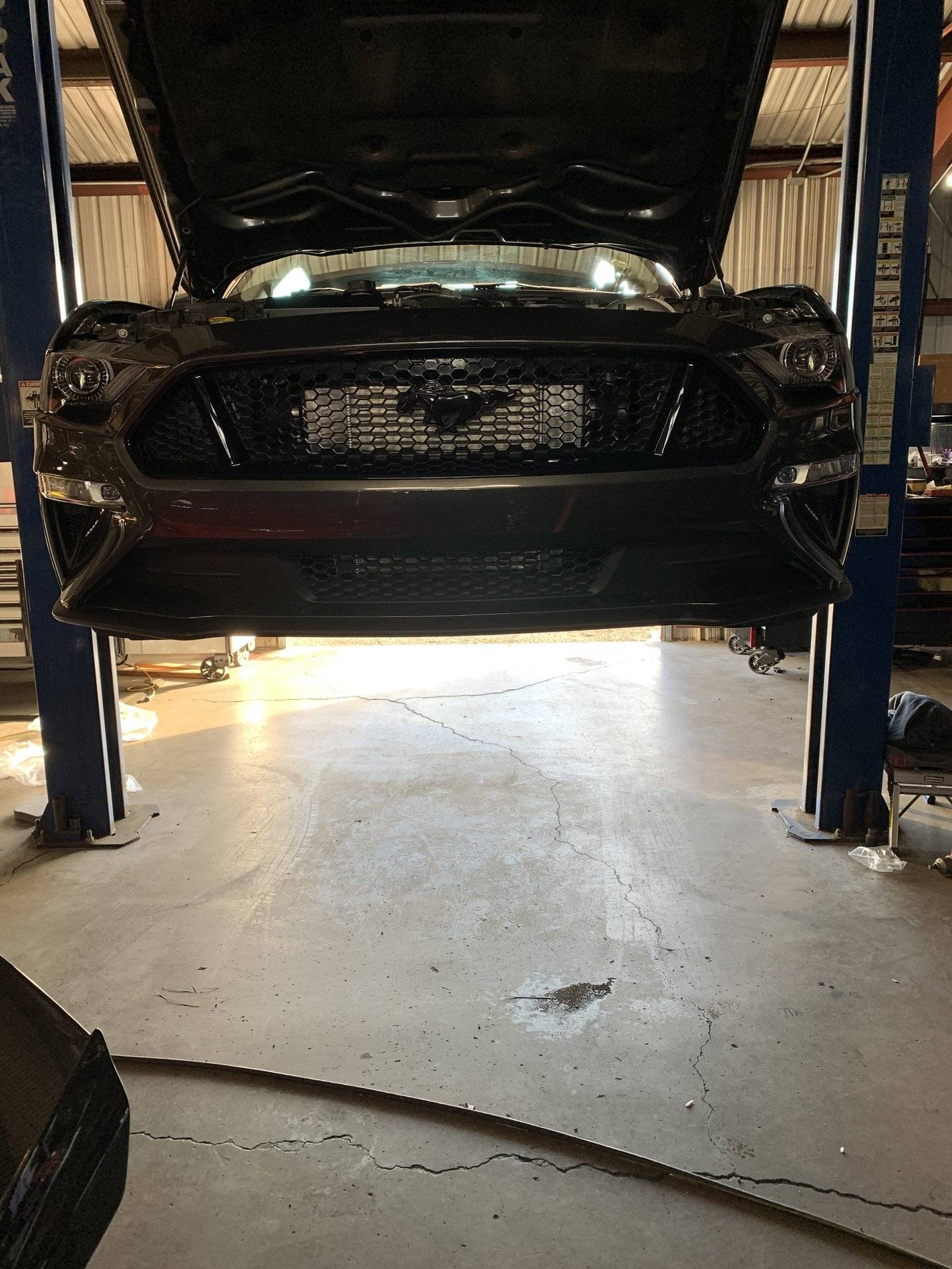

Spent most of my day getting my stg2 d1x kit installed. It wasn’t particularly difficult, but I will say that getting the hot side pipe with the red race valve in and positioned where I wanted it was a bitch! Tomorrow I will put the fuel system in and hopefully my tuner will be able to get it tuned this week. He’s kinda pissed at me for not doing the Opg’s, but I’m not too worried about it. I’m hopeful that staying with the stock rev limit and staying off the rev limiter will yield favorable results. Anywho. Here’s a few pics of the install.

Sweet, nice to see your progress...and the cars in the background
I agree 100% with your tuner. Only an idiot does this and keeps the fragile stock OPG's....just don't cry when you lunchbox that coyote and keep an extra 10k handy just in case you do because its only a matter of time. I personally know 3 people who took this chance and lost, it usually takes right at 100 1/4 mile passes to break em with boost, my buddy with the A10 '18 F150 broke his on his 100th pass as it shifted into 3rd.

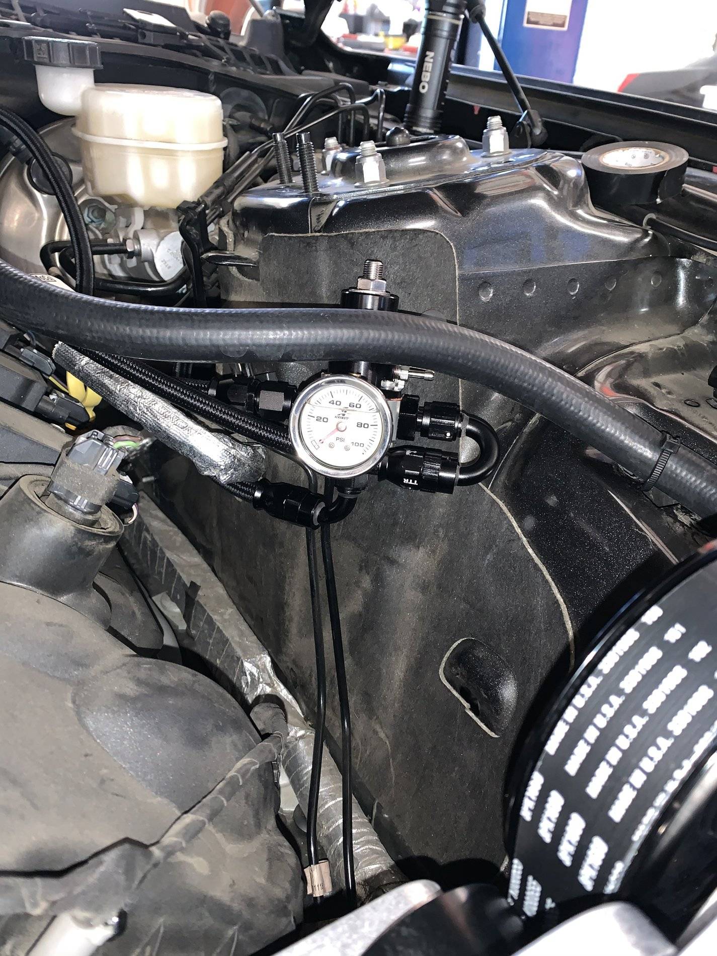

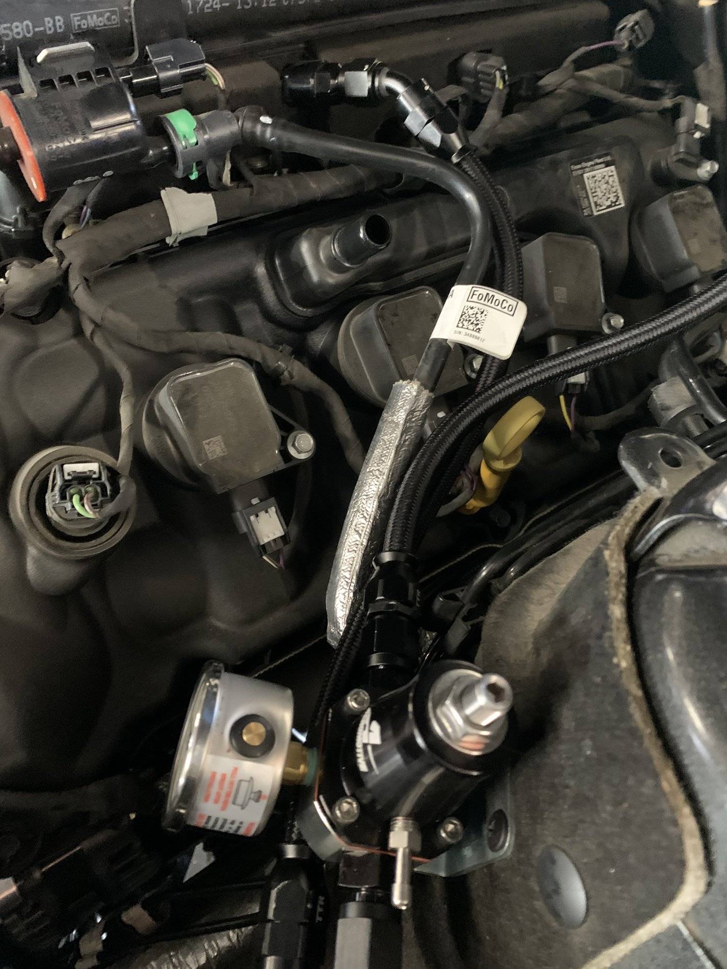

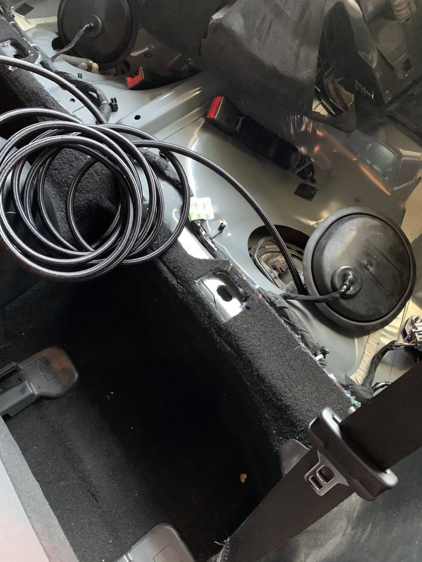

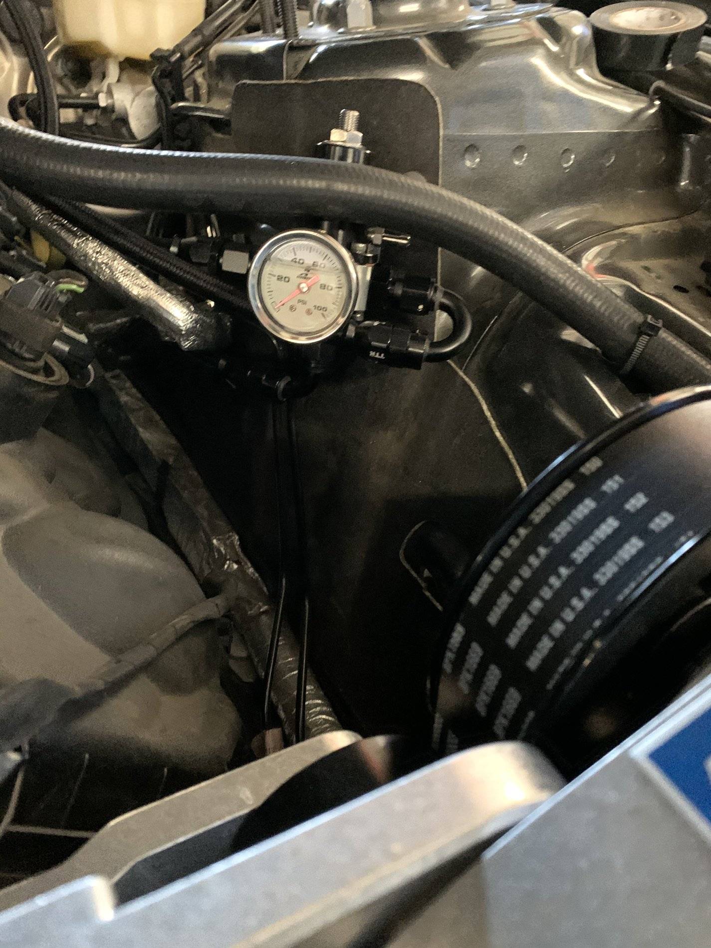

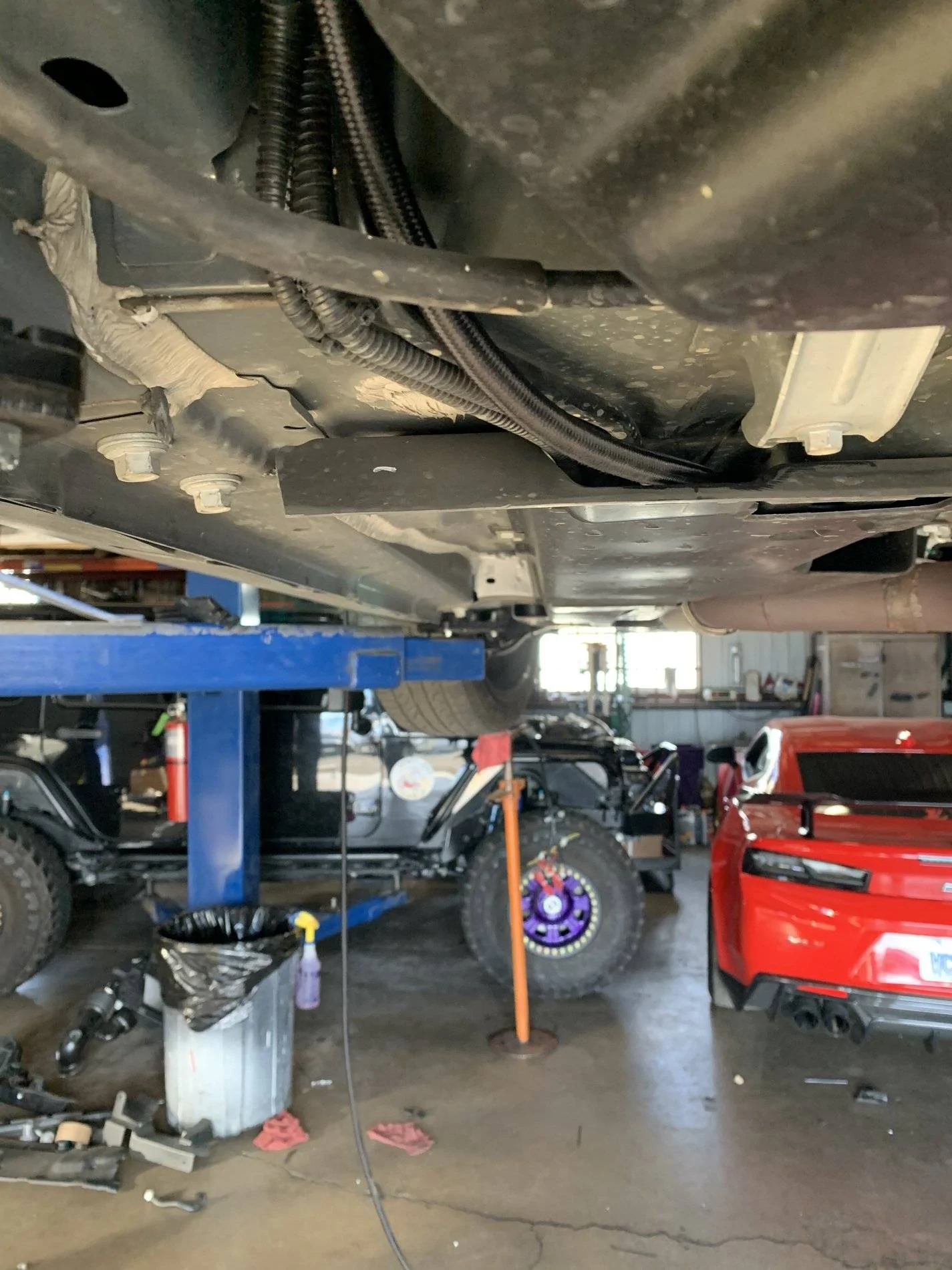

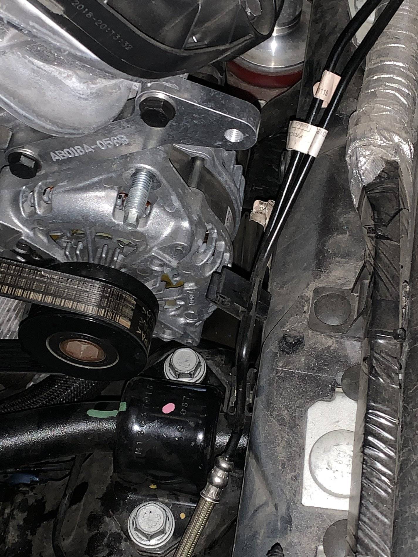

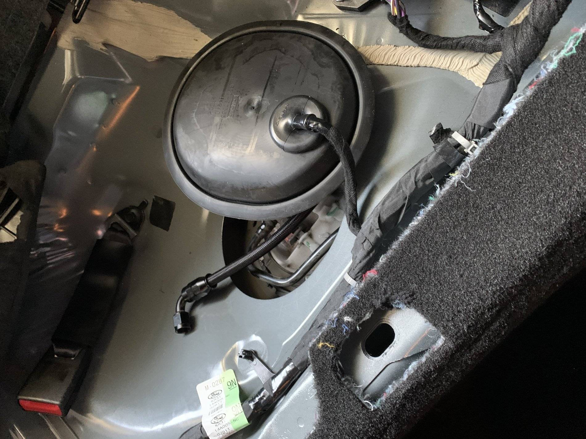

Got the fuel system plumbed today, but that’s about it. I was going to install the gt350 pump module that I got from eBay a while back, but I thought you know I should probably test this thing so I broke out my trusty power probe and damn it all only one of the pumps works, so I’m currently trying to decide what to do for fuel pump. Also as I mentioned is my last post I’m probably going to go ahead with the oil pump gears. Kind of a step back wards, but oh well I guess. Anyway here’s a few pics from today.

there’s a return line there. Though I’m not certain I assumed this is how the sai li kit is plumbed
What are your power and et goals with this car again? Sorry if i missed it.
