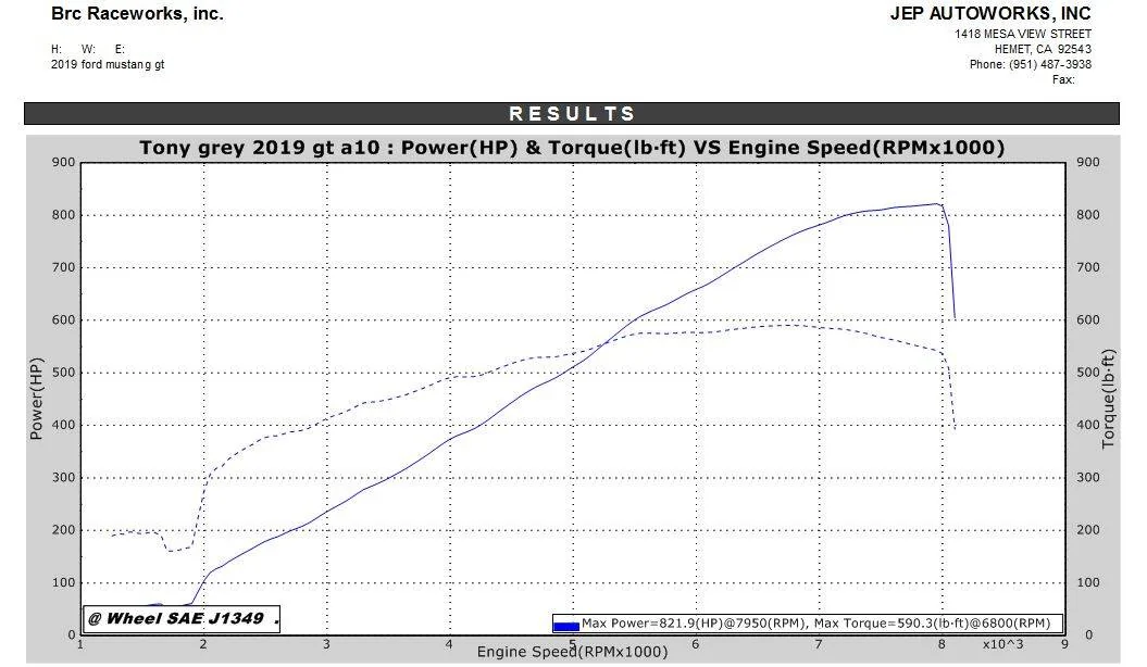

My tuner had some time today so we were able to get my car dialed in. A couple of interesting foot notes, the pulls were done in sixth gear. Boost was 13-14 psi, and my tuner says I am out of fuel. It’s just not enough pump and the stock line is too small. The logs showed I was dropping to 43 psi between 7 and 8k. Anyway. Here’s the Dyno sheet.

Nice! Looks almost identical to my graph. What's the plan? Fuel system and turn it up? Should rip!

Nice. Another weekend project for you to do the fuel system.

Definitely a tire first, and then see how it does at the track. Eventually I’ll go with a full fore system. Right now I have absolutely no traction, which is kind of fun, but also pretty scary

yeah eventually. For now it’s good, but it’s definitely at the limits of what that fuel system is capable of.

I would not go to track without a fuel system! Fuel will pop an engine fast if lean. I had to go with a Fore as well when I switched to the D1X.
