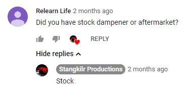

This guy broke a crank on an 18 with a P1x Procharger -
Stock damper too:

Well.. there goes my argument I guess lol
Carry on guys!
There's one of the vids I was going to send.
Two others are turbo guys. With the OPG/CS replaced, still on the stock damper.
Last one is on anything coyote mustang related on facebook.

Well the 2 turbo cars with opg's replaced lends more credit to installer error re-installing the factory balancer, and further validates is not because blower belt tension.
